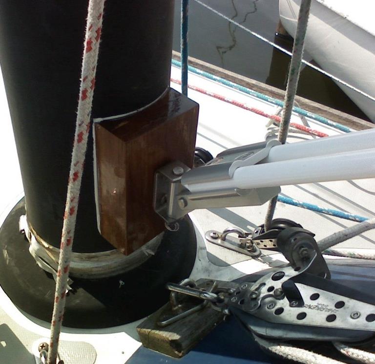

In case anyone is interested, I have made some progress on this front after several helpful email exchanges with Ted Corlett at Boomkicker. One of his suggestions was to epoxy a teak block to the base of the mast, and attach the boomkicker there. To that end, I have successfully made a prototype from a scrap of 2x4 using a 7" dado blade set at a 12 deg angle so as to cut a cove that matches the circumference of the mast near the base.

I did want to clear up a possible point of confusion about my sketch. There is an existing teak block on the forward portion of the cabin top and this is where the existing vang arrangement attaches, i.e. the vang attach point is indeed aft of the gooseneck, although my sketch exaggerates the distance. This was apparently the original Freedom 25 round-mast design, and has not proven to be a problem, at least in my experience daysailing around the Chesapeake and Potomac. My plan for the boomkicker is to attach a new teak block to the mast, directly below the gooseneck, in approximately the location that the vang would be attached on almost every other boat. I plan to leave the existing vang arrangement alone.

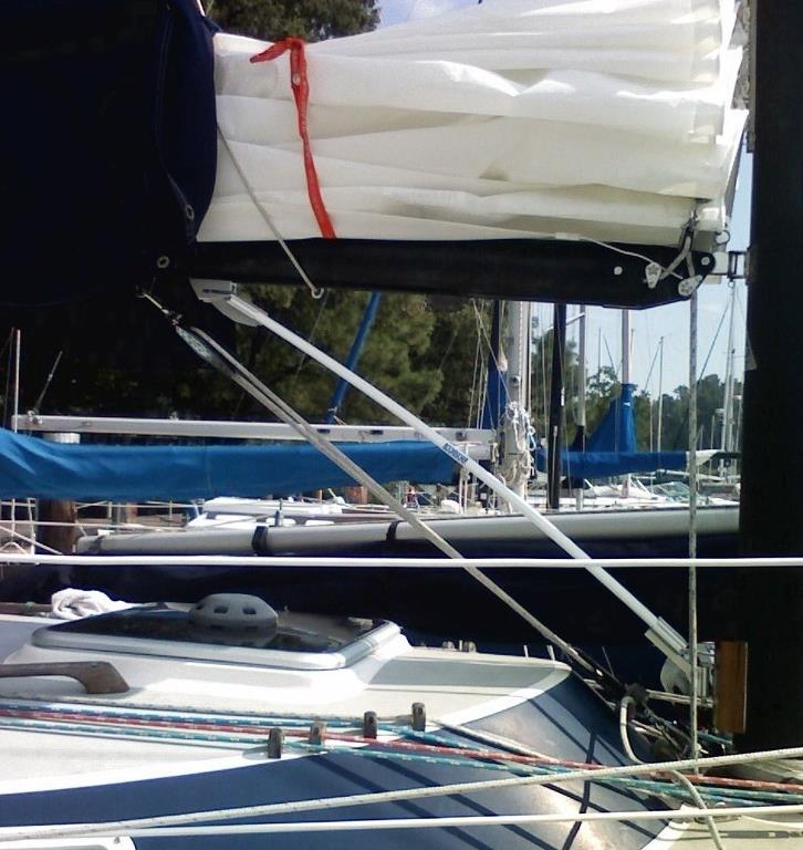

For those following this thread, I completed the project yesterday, and here is an email I sent to Ted Corlett just now:
Ted,
You may recall our correspondence from March concerning installation of the Boomkicker on a round-mast Freedom 25, which has no mast track or other means of attaching the Boomkicker’s mast bracket. You ended up making two suggestions: a teak block epoxied to the mast, and tapping directly into the carbon-fiber mast for the machine screws. After several months of delay, I ended up pursuing the former option, which I completed yesterday.
I used a 7" dado blade at a 12 deg angle to produce the cove cut that matches the mast diameter. I used the Gougeon Brothers’ suggestion of receiving the fasteners into the teak block with two nuts bedded in epoxy. I’ve included several pictures for you below. Design and fabrication of the teak block, inclusive of production of several prototypes in pine to get the angle right, took about 5 hours. Fitting and installing the block to the mast was another hour. The rest (tapping into the boom, etc.) took about 30 minutes. Since I had to allow the epoxy to set, first for the fasteners in the block, and then for the block bonding to the mast, the whole process took place over 3 days. If I had it to do over, the only change I would make is to use something other than Marine Tex epoxy for bonding the block to the mast, since it leaves an “Elmers Glue” appearance. I’m going to try and get some dark caulk to cover this.
I haven’t yet sailed with it, so I don’t know if I have the right rods installed. The larger ones, which are in there now, appear to be a little too stiff.
Thanks for your support, and I hope this info may be helpful to your future customers. I will be posting this info also to the FreedomYachts.org site.
