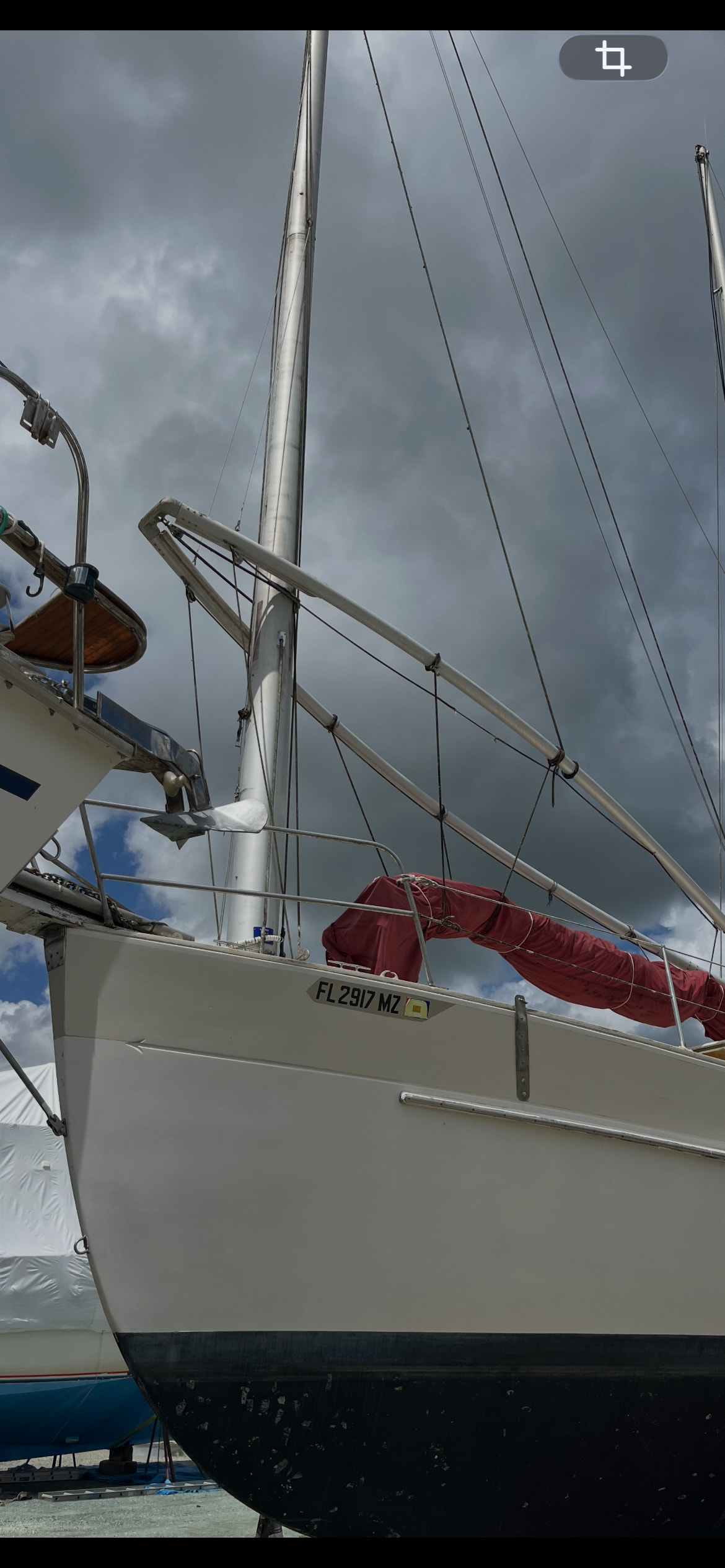

Installing a windlass, a custom bowsprit for the third sail

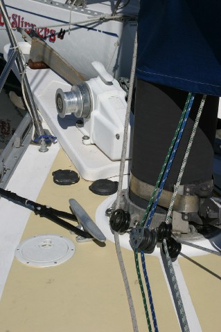

Here’s where ours was on our Freedom 40

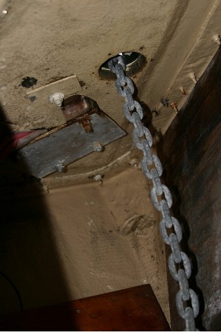

There was a hole into the anchor locker for the chain:

Ohh we did find places where, through some fittings and openings, there was access to the balsa, and it was completely uncoated and unprotected. I don’t know whether that was something left from production or if it was the result of previous owners’ bad repairs. Maybe that’s exactly why everything rotted near the anchor chain hole , it probably was not sealed or protected properly…
Thank you! If we still had the original bowsprit, we would definitely mount it in the center without any doubt. But we have this setup now, and it makes things more complicated.
I can see that we have chainplates on both sides. And as I understand it, when there was a third sail, the foremast was supported by something like stays or some kind of rigging. But we still have not fully figured that out.

B: I have already described my electric windlass replacement of a manual one behind the front mast, UK F33/35 CK. The new one is on the starboard coach roof, beside the forehatch. I had to sacrifice a hanging clothes locker to accommodate the chain, but moving all that weight aft brought the bow about 4 inches (100mm) out of the water with reduced pitching. Plus all the electrics are in an accessible and dry place. NB, I drop anchor up to 100 times each season - dog needs walked.

My coach roof-mounted windlass has a problem with the chain lead. A horizontal one with a straight drop off the gypsy would have been better, even if a bit bulky on deck. About one drop in 30 it jams and I have to drop my second anchor (Bruce!) in a hurry while I sort out the mess.
