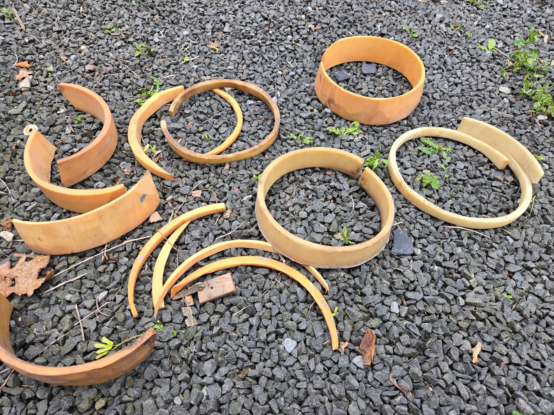

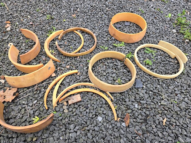

Preparing to install the mast collars, and have come across what once was the mast rings im assuming from what is left of them.
Has anyone got any leads on where i can find replacements?
Or any idea of dimensions so i can look into getting some made?
Thanks in advance
