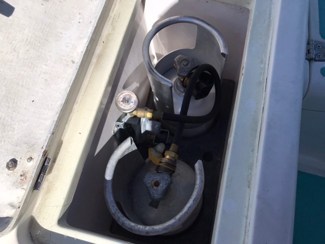

I have a f 35 p - 2 vertical smallish tanks 1.4 gal each. I tried to refill mine recently - one tank was dated good with a few months left, the other was out dated and needed a new OPD valve. Brought it to a propane dealer and they could not get the new OPD valve with the float shutoff to fit - tank was too narrow. I ordered a new tank from WM - slightly larger in height and diameter but still fit. Pic below shows top most is the new tank and lower tank is the older. Slight difference.
