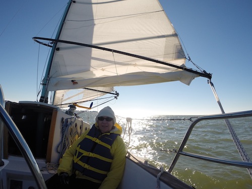

I have been using separate reef lines together with a mast strap to take load off the track a bit.
I Spent four days sailing the Tampa Bay area over Memorial day. Double reefed the main for practice, but again I am using a multiple part system.
Also in trying to heave too, I found myself with sails trimmed for a broad reach and hard over to be broad reaching in reverse. Stable. I was able to eat, put on some more sun screen all the while backing my way across tampa bay or together with my tacking repeatedly reefing as the wind dropped… I think I was mistaken for an abandoned boat,
Still, if someone is proud of their single line reefing system for a Freedom with slides single ply and wishbones I would still love to see photos.
Mike
