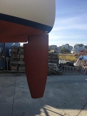

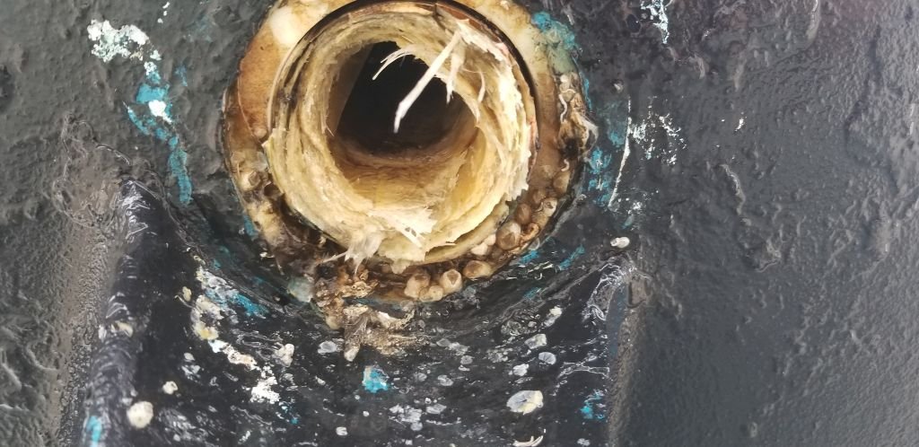

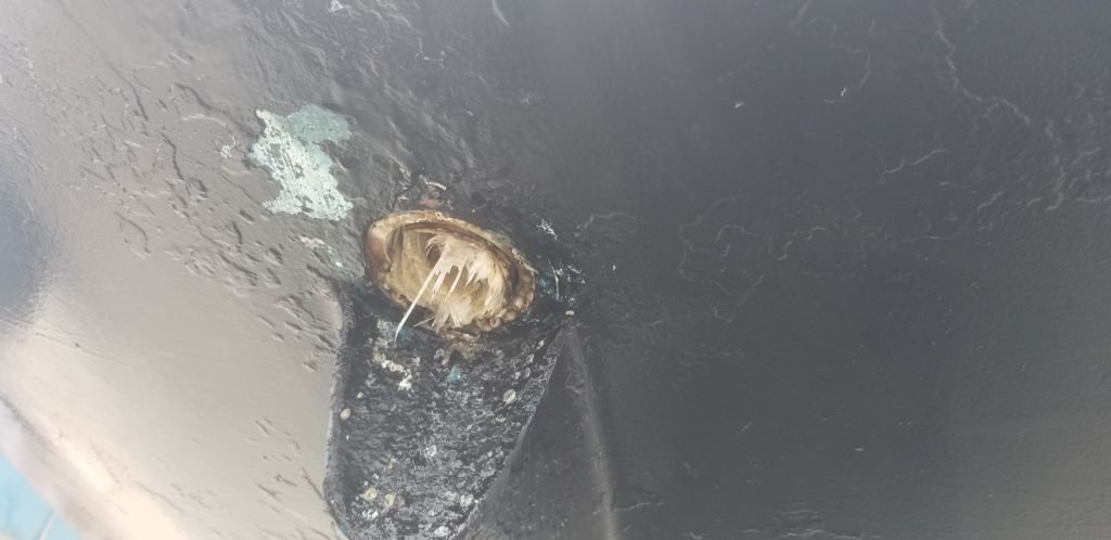

Thanks so much for your information Mike and Walter. It’s good to hear that the stock is the same diameter! My boatyard has been doing their magic to look at the options for custom fabrication. We may be going with a brand new custom rudder, but I haven’t spoken with the adjuster yet (and hoping I have better luck than Walter). Depending on how the insurance pans out, I might be in touch with you Mike. At least we got 20 days in this season before it happened. I’ve attached photos in case anybody is interested. The stock stub looks different from Walter’s.

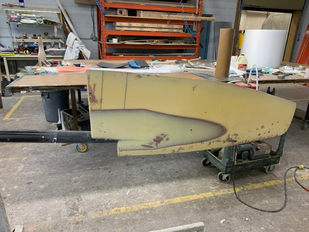

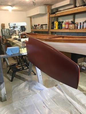

First pics of my new rudder under construction. This is after they have built the carbon post and milled the foam, in preparation for vacuum-bagging the skins on.
Looks cool. So who is finally building it? And who did the design?
CCI is doing the build with Phil (Phil’s Foils) doing the design. Although I had thought that the original rudderstock was a FRP/carbon composite, Phil told me that there was no carbon in mine, just FRP. So the new carbon stock should be much stronger than the original. I’d hate to have to go through this again in another 30 years.

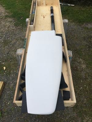

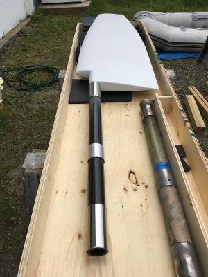

New rudder has arrived from CCI!
That rudder looks so awesome! Are you replacing the bushings in the boat, too? If yes, what material?

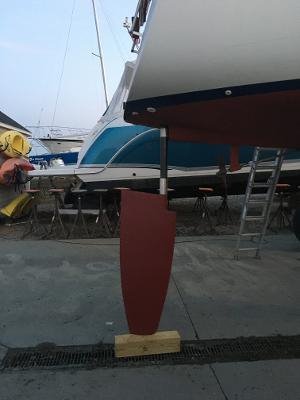

Well my F28 rudder replacement post comes to an end. Drilled the mounting holes and applied some bottom paint:
Installed and re-launched after 72 days on the hard:
Fit is very good and CCI did a great job, especially with the lack of dimensional info that I was able to provide them with. Over the winter I’ll do a little fairing around the skeg but otherwise it’s a perfect fit and she sails great. @bad, the bushings seem fine, no play that I can feel in them so I’m going to leave them as is.
