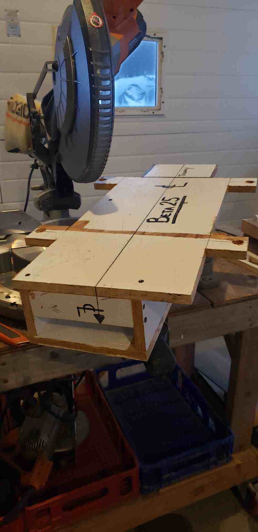

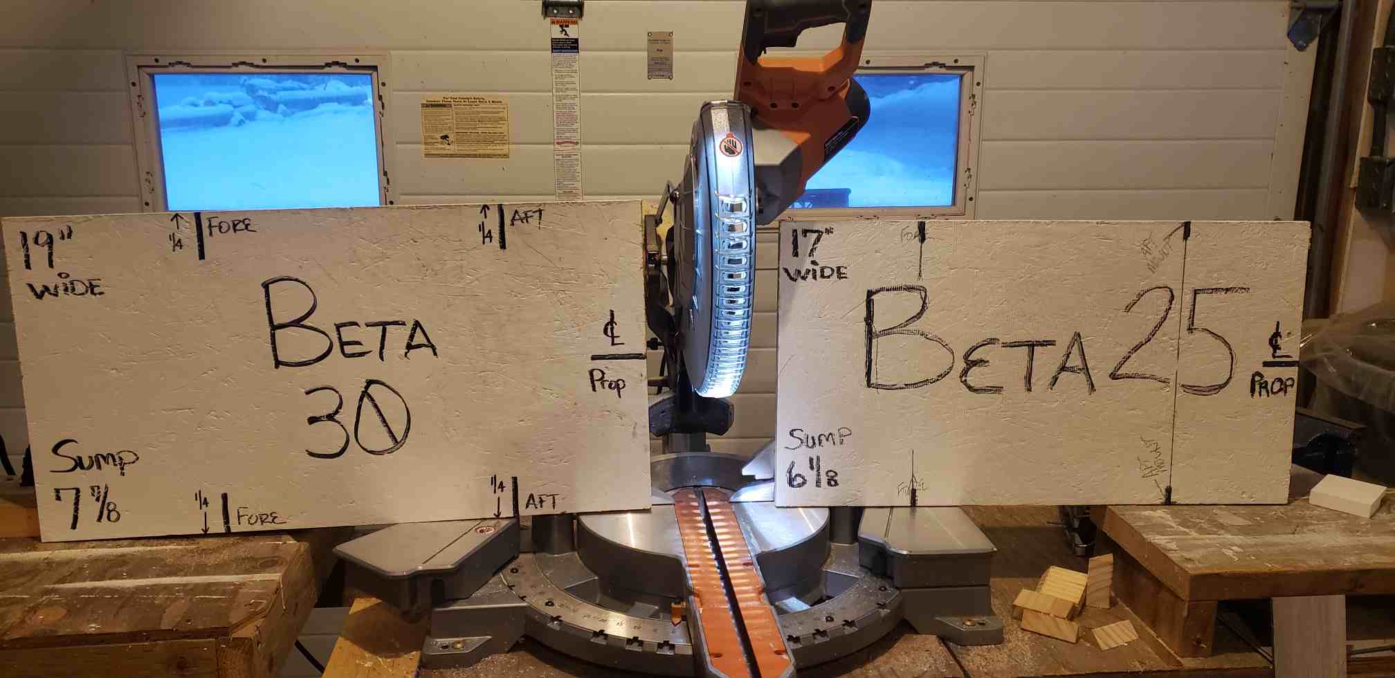

Today I made two foot prints of the Beta 25 & 30. Heading down to the boat to see how they fit - both existing bed and parallel to the prop. shaft
Keep ‘em coming! How many hours were on your old yanmar?

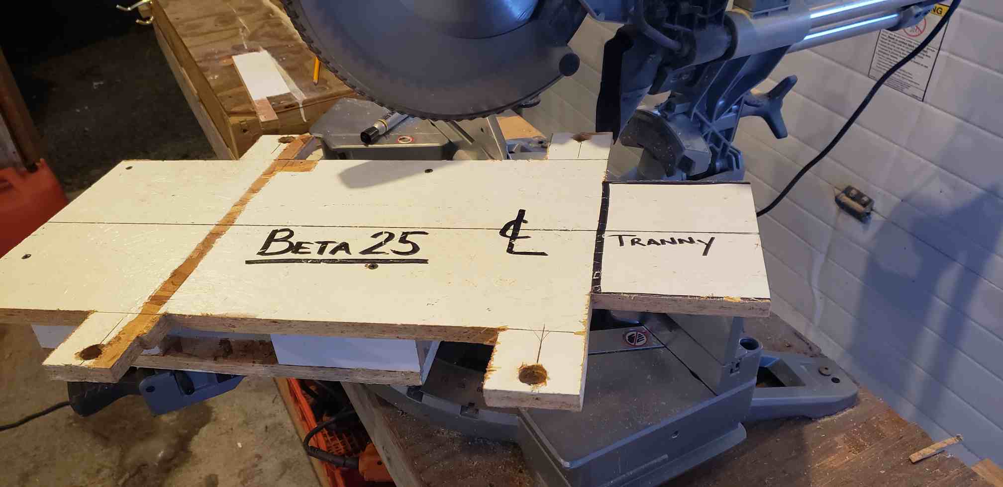

Don’t know. Hr meter was not hooked up when I got the boat. Today I made a simple 3-D to sit in place. I will use (removed from yanmar) the existing mounts and see where things fall. I have the “sump and tyranny” shown here… Mounts are on the boat and I’ll mess with that tomorrow when I go to town… You will note the board say Beta 25. I may have to go that route due to aft mount complications. I will make a similar 30 model and see how it goes.

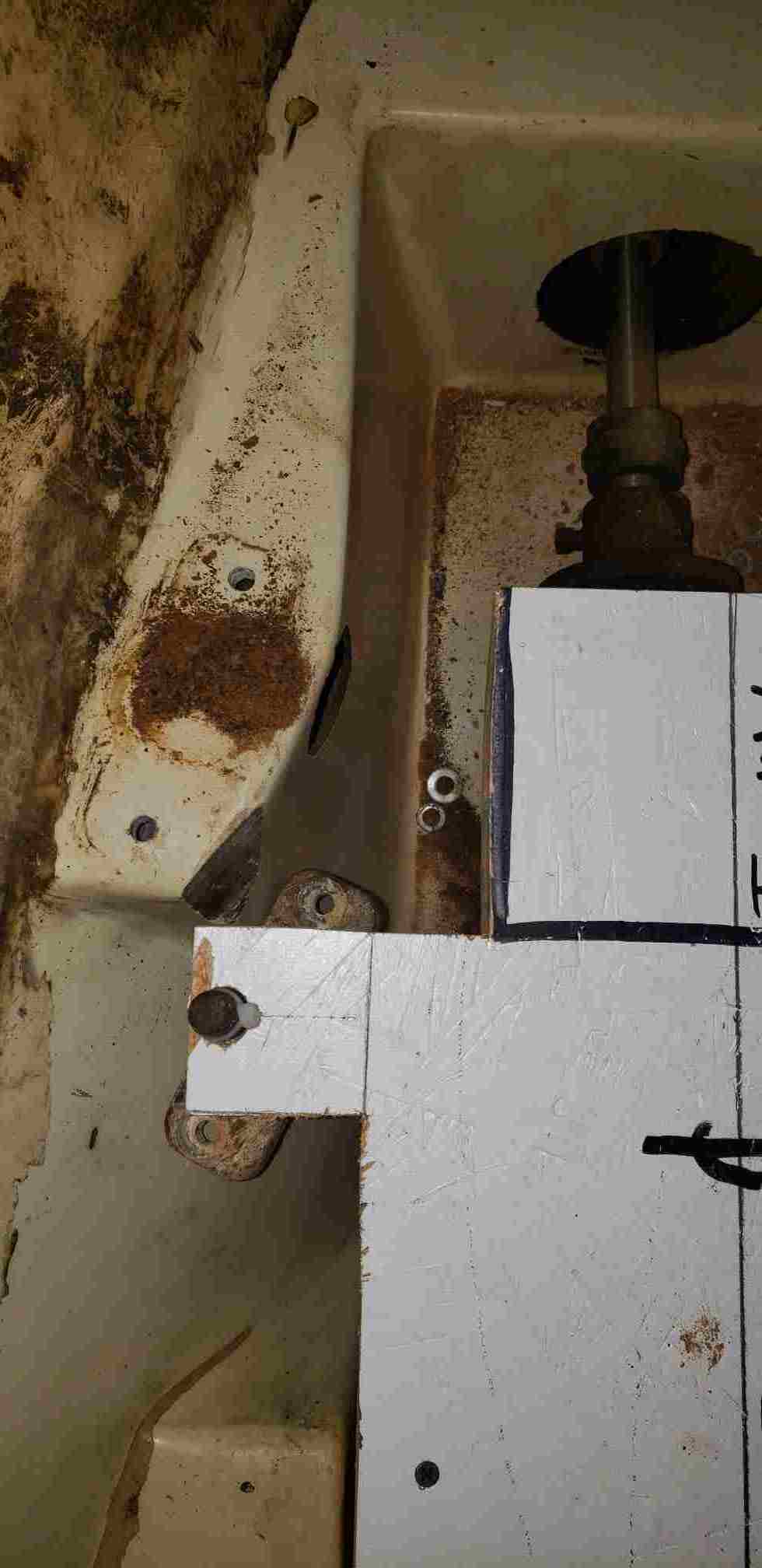

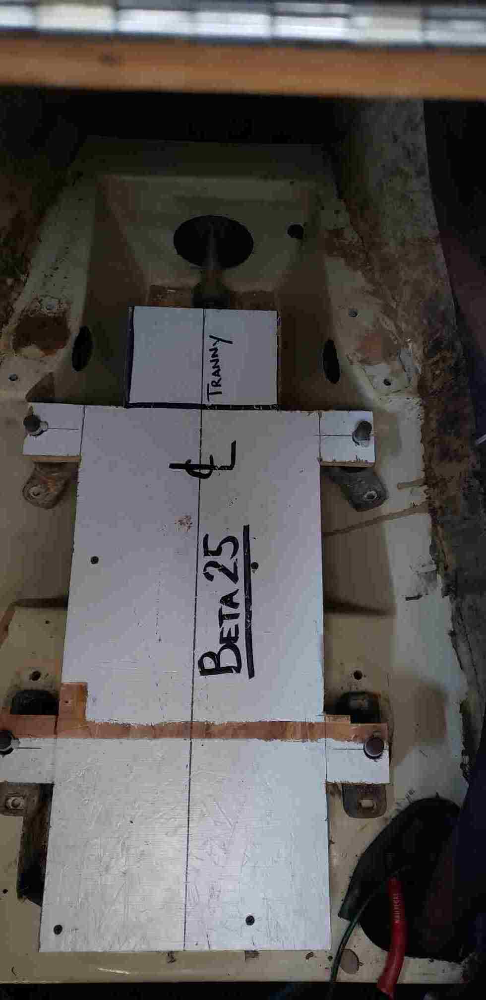

Here is my area of issue - the aft mounts. To fit the 30 I will have to bump the motor forward 4-6 inches approximately. The 25 will fit better but I loose a little hp.
Shown below is the 25. I have the old "drop down " brackets that may work. You will also note the mounts are almost up against the hull.
The 30 is almost 2-inches wider and would protrude thru the hull.
