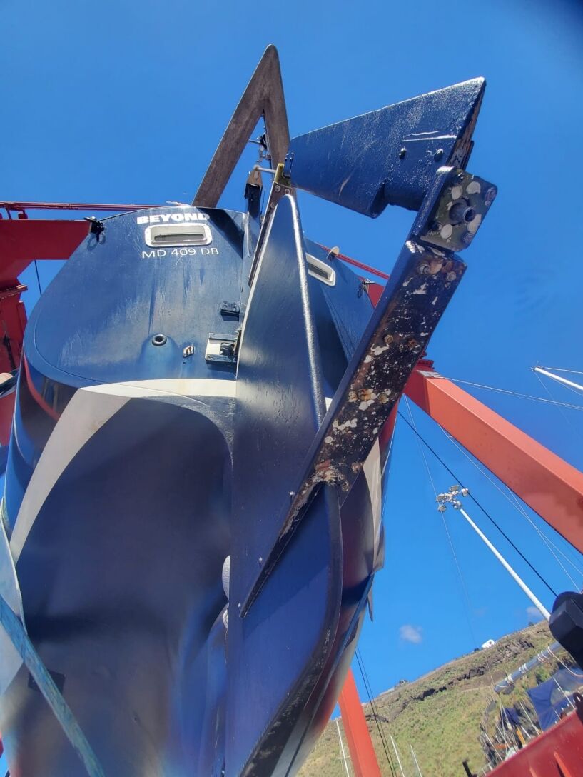

Thanks very much..… would you have any photos of your installation to give me a few ideas…
If you go to the scanmar website and check out the gallery, theres a couple Freedoms with monitor windvanes.
Hi
Sorry it took a bit long. Had to dig out the pics. These show the first install of the vane on my boat. Let me know if you need any mero info.
Hebridean windvane.pdf (775.1 KB)
