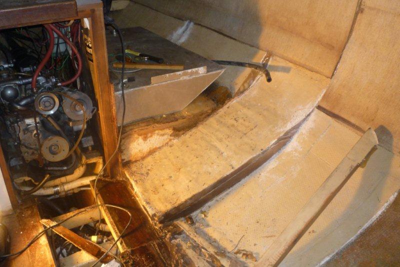

I am in the process of replacing the cabin sole in my 1983 keel version F28 CK. In order to remove the old cabin sole I had to pretty much disassemble the entire interior because the floor boards extend underneath the joinery and are fiber glassed to the hull. While disassembling the port locker, in front of the diesel tank, I found that this locker has a false bottom. I assume I will find extra lead ballast under this false bottom. Does anybody know if this is how my boat left the plant in 1983, or if the lead was added afterwards to even out the boat? Has anybody else found extra ballast in this location?
The port locker in front of the diesel tank does indeed contain lead underneath the fake floor. Has anybody else seen ballast stored in this location? I am guessing there must be at least 200lbs of lead there.

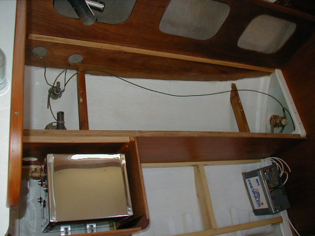

When I redid my 1986 Freedom 36 in 2001 I replaced the floor timbers with 2 x 4 poplar which is a hardwood used in furniture and boat building. I cut them to fit and coated with west epoxy to seal against moiture before installing. See photo. The light colerd wood in photo is the poplar floor timbers.

Nice work Rich, I will stick with poplar and was indeed planning to seal it with epoxy prior to installation.

Completely removing the floorboards on my Freedom 28 CK (keel version) was a big undertaking, because the floorboards extend way underneath the Port and STB settees. For me, this meant totally disassembling the entire cabin, from the head back.
If I were to do this job over again,and the settees were in good shape, I would cut vertically along all settees with a vibratory tool to keep the settees intact. I also used the vibratory saw to cut through screws I could not remove conventionally. BTW, my second F28CK has the same added lead on the port side as the lead that started this thread.
