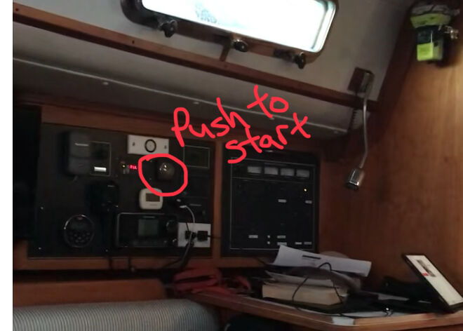

Mike- as usual a really interesting read! Pic is my push to start for my 3gm30f- I’ve only ever used this when I’m doing yearly maintenance and cranking the the motor to the right position. On hand cranking, my old Sabre 34 had a Westerbeke 27) came with a hand crank which worked just fine when needed.
