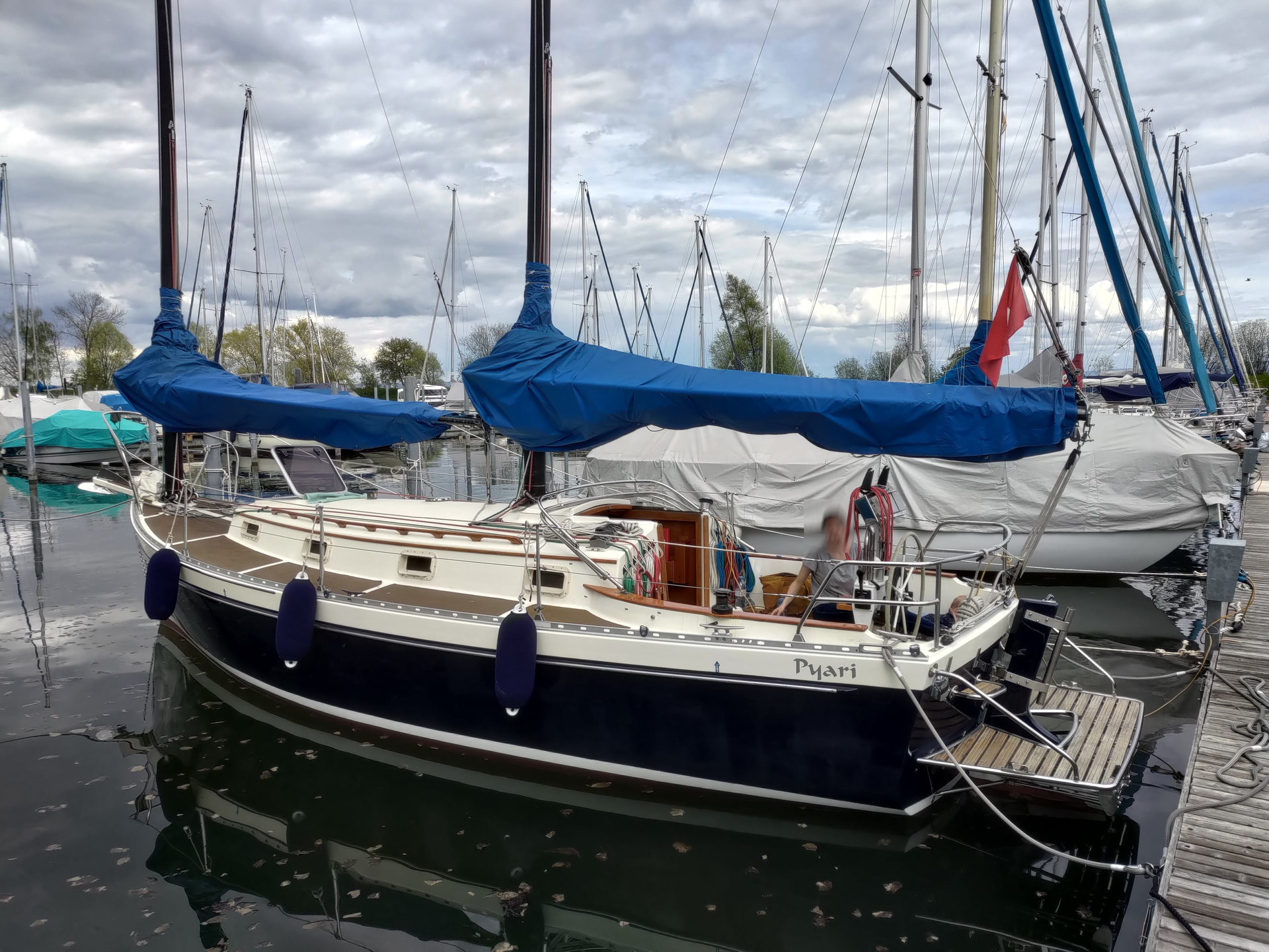

Saw this picture on one. Hope that helps alex

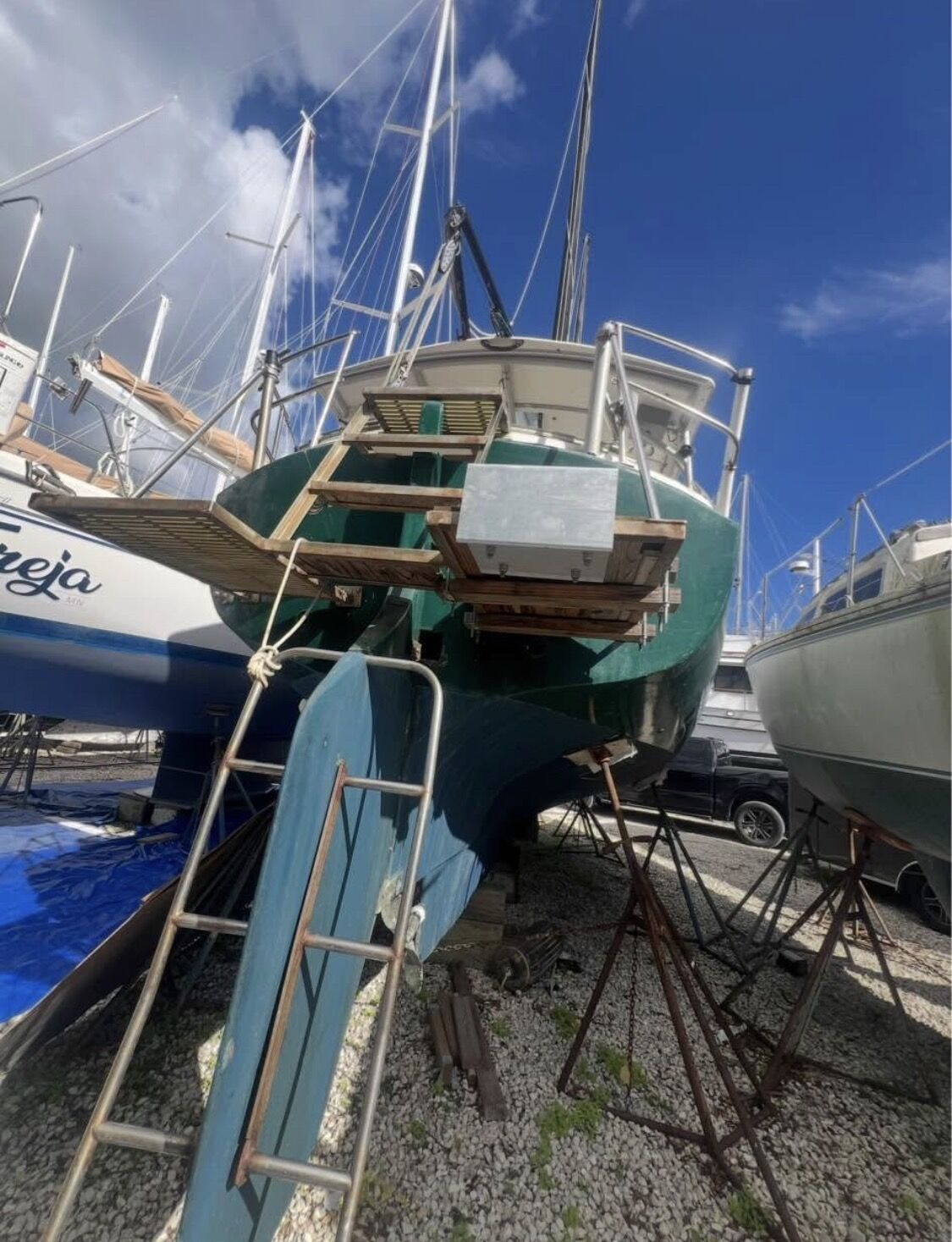

The Freedom 35 CK “Mir” was listed for sale last year or so. She had a large swim platform with a cut out for the rudder. I can’t find the listing anymore, or I’d post a photo.

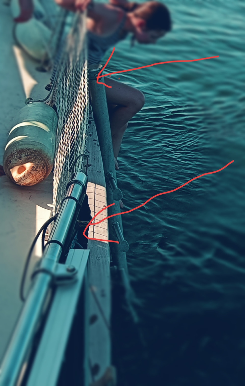

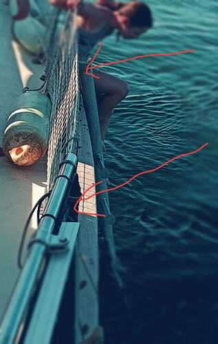

Can I suggest you consider installing a deep swim/rescue ladder on the side of the boat….around midships…easily deployed…on a universal joint at the front…on a rest at the aft end. An idea I copied from an Amel. We have used it a lot. Also if you have an MOB in rougher water, the aft end is a poor choice for recovery….
Arrows show aft rest and fwd pivot point
