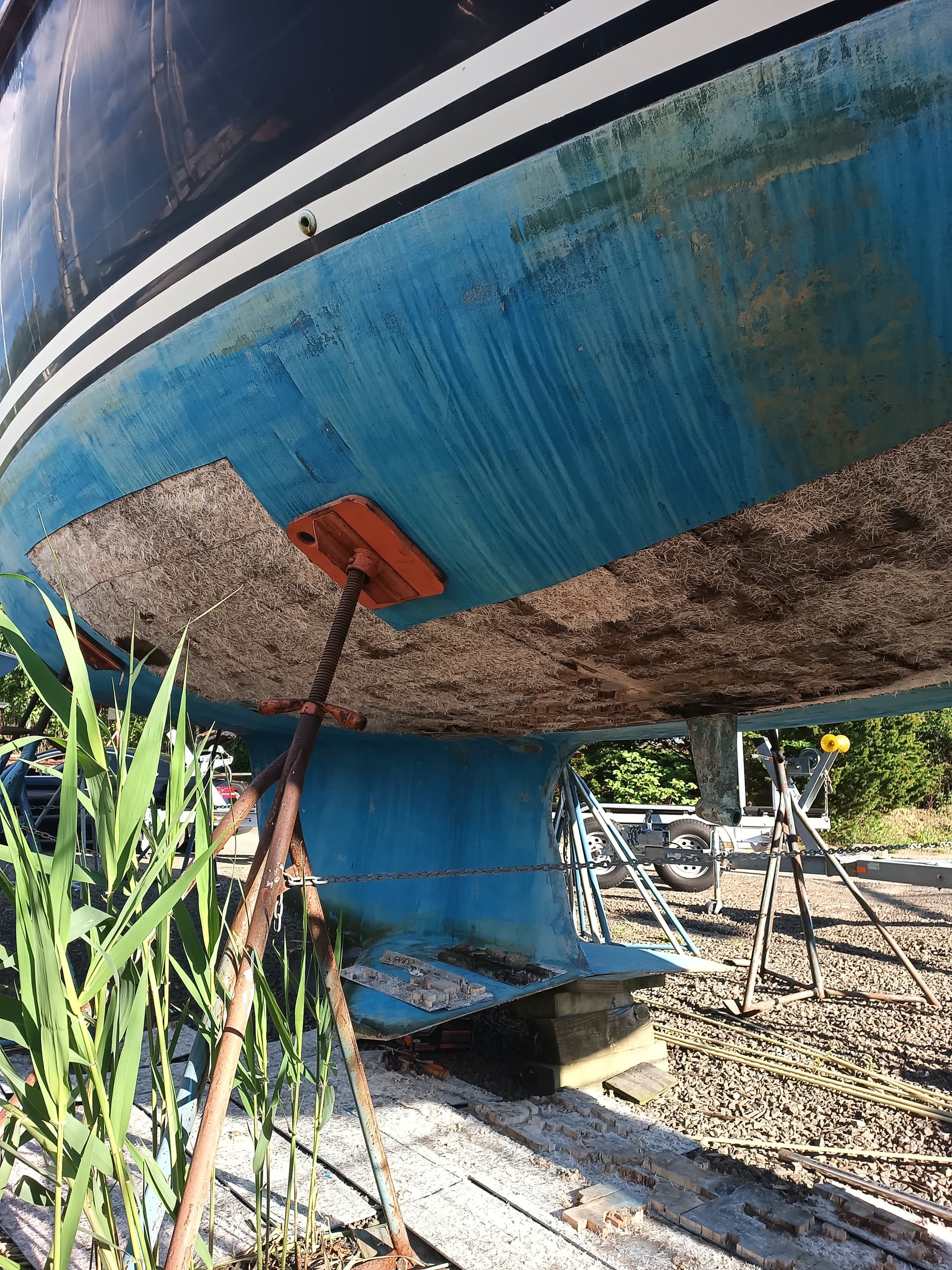

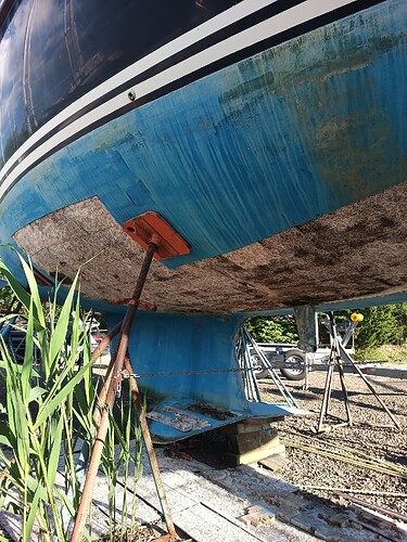

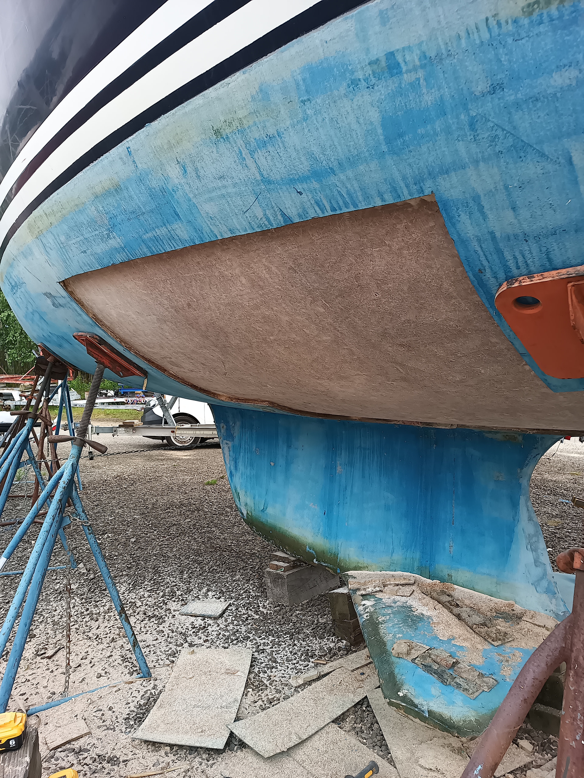

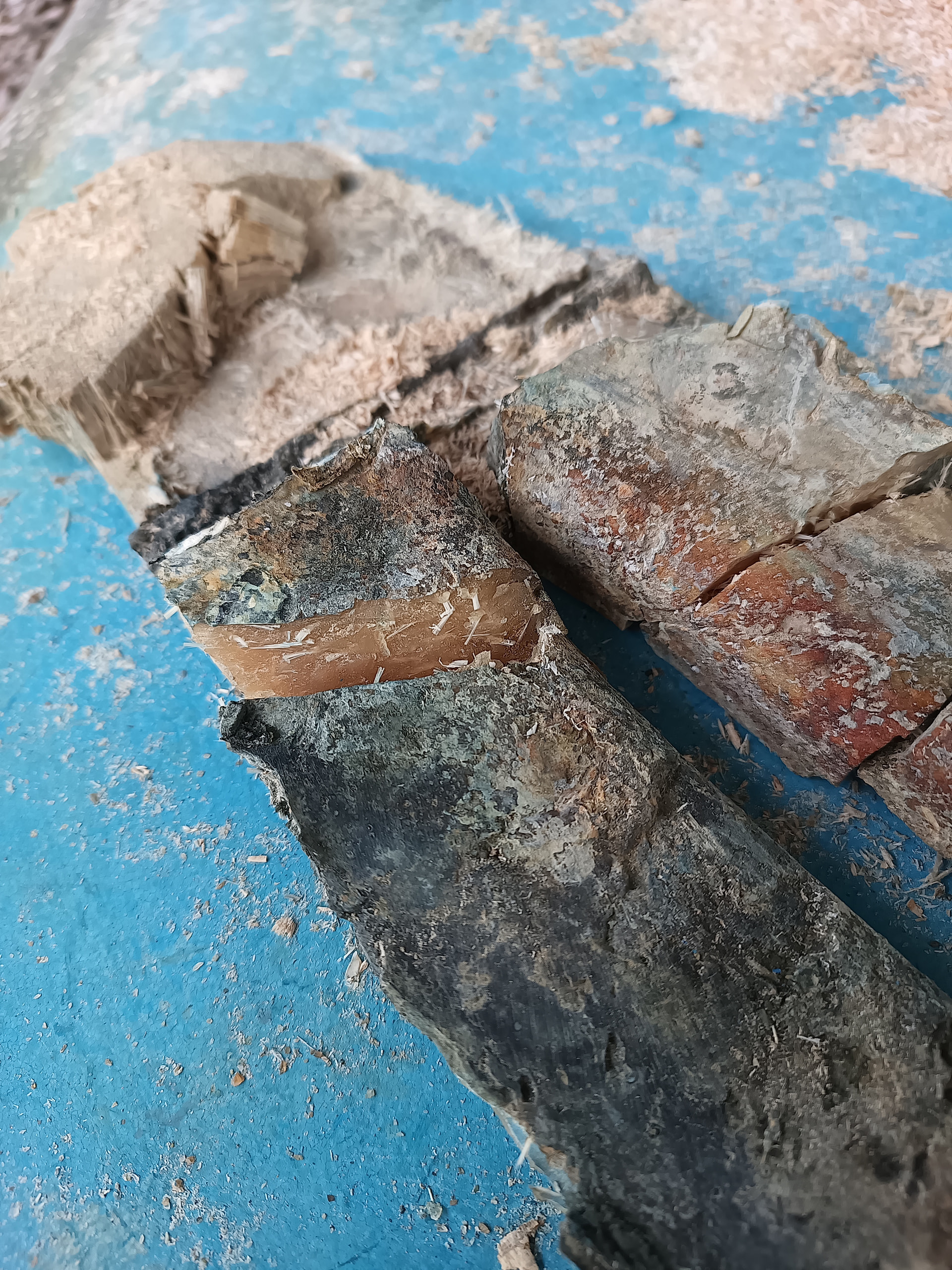

Noticed some drips around the shaft log and shaft strut. It was noted in the survey a couple years ago when I bought her, so it wasn’t a complete surprise, but when I finally started cutting on the hull this weekend, the wet core just kept going and going. A little peeved with the surveyor as this is definitely much more of an area than he suggested, but that’s just the nature of these things I guess.

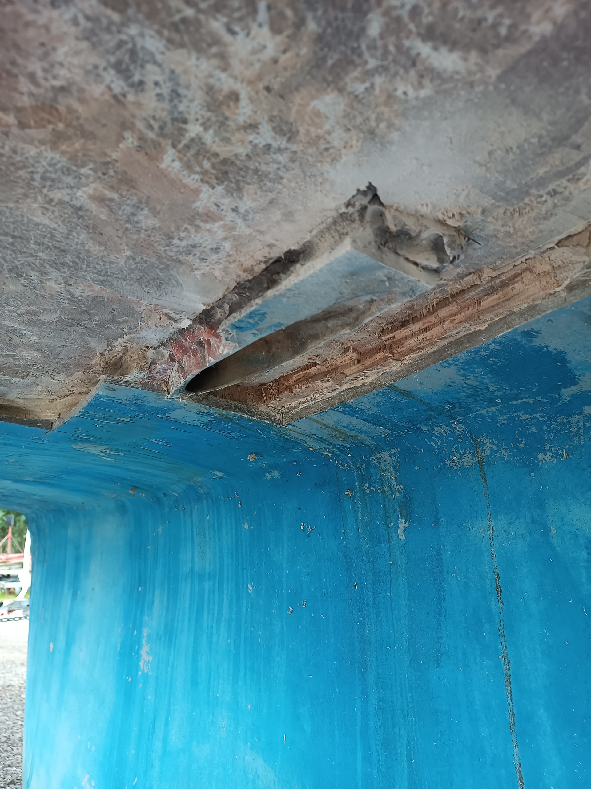

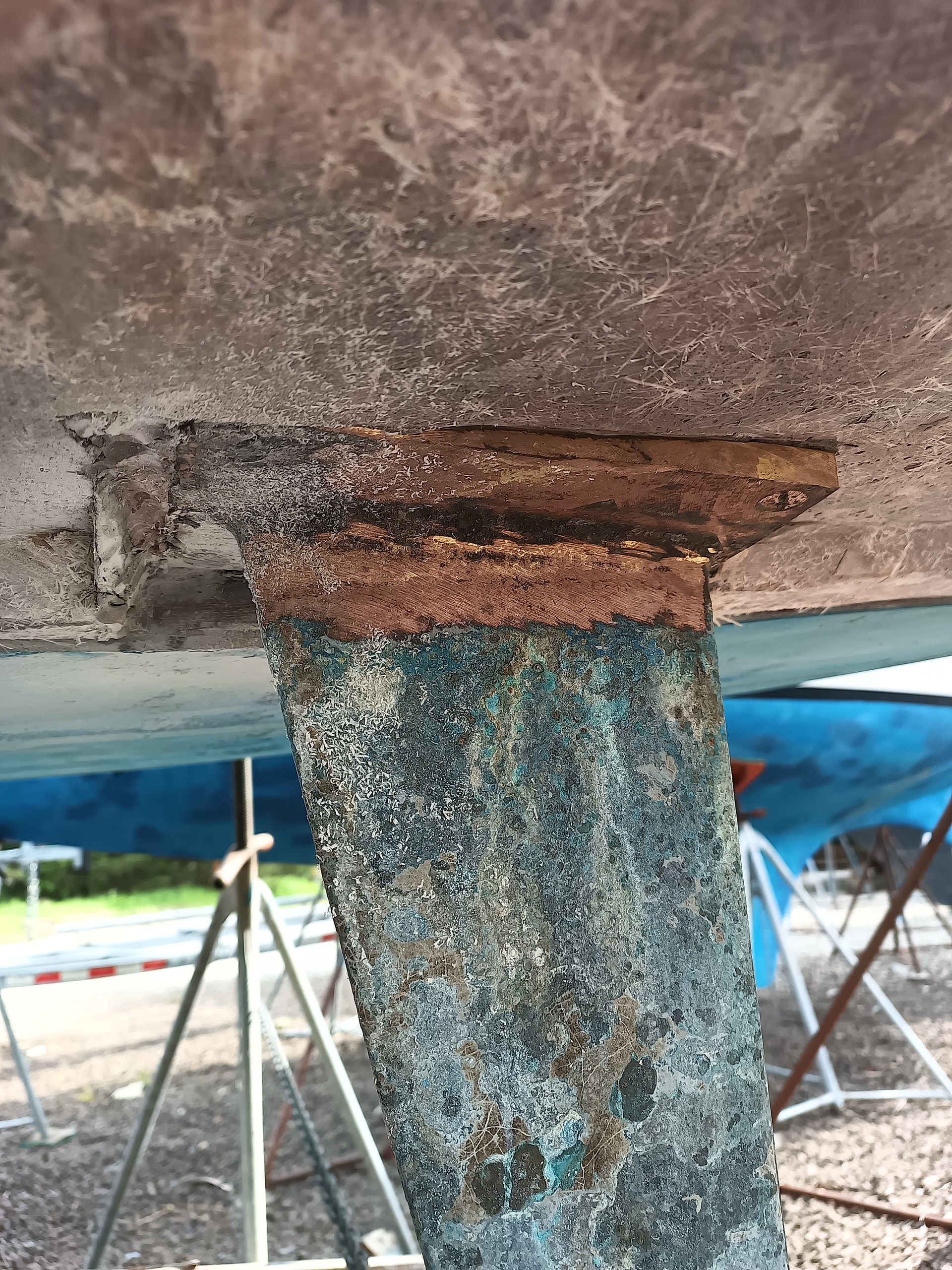

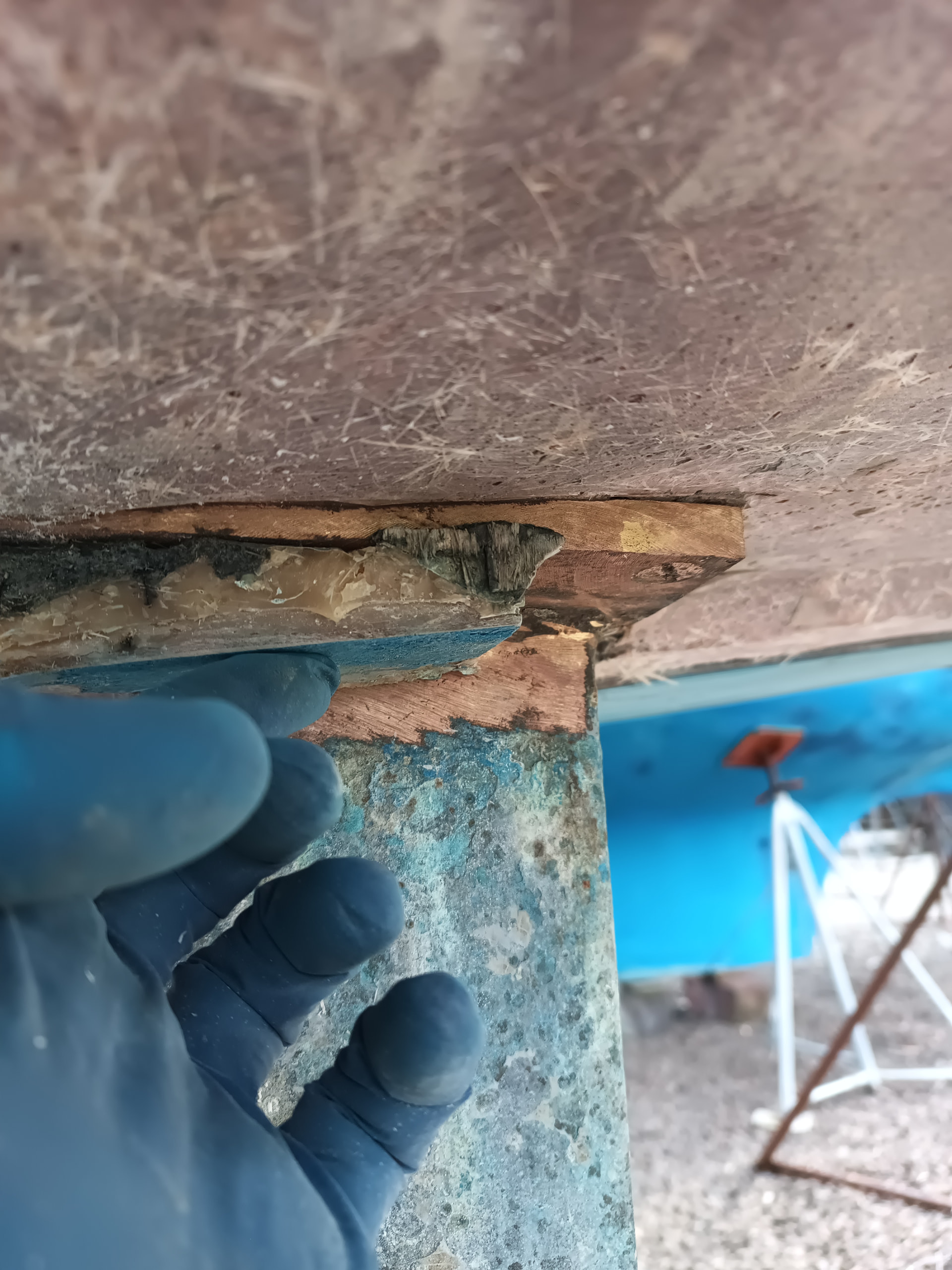

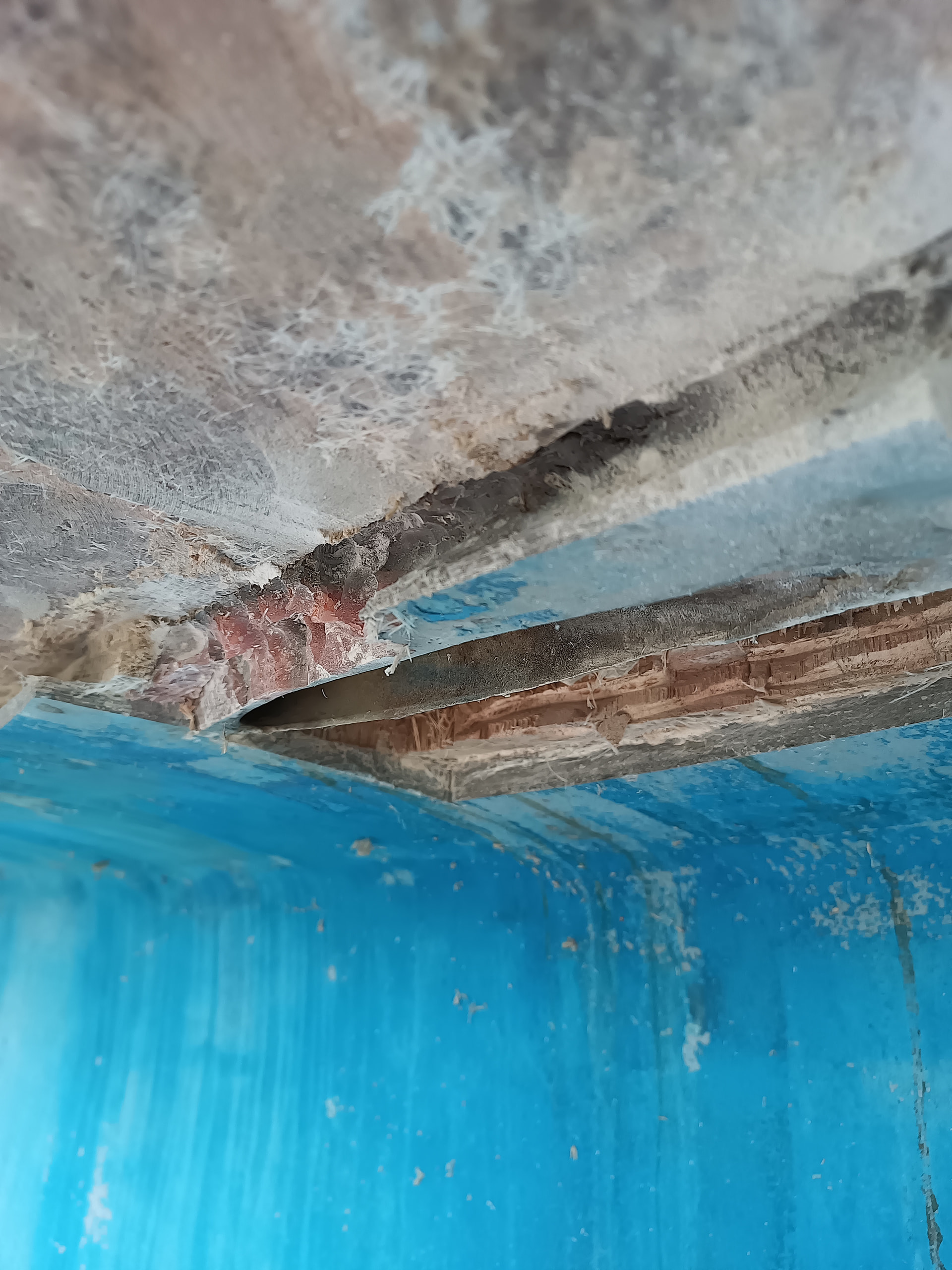

Initial ingress appears to be around the shaft strut, and shaft log. Very little boundary of what looks like barely reinforced resin between either of them and the adjacent core. Similar to having to cut out and replace the core around most of the port lights due to no resin reinforcement around the handrail fastener holes, this all could have been prevented by a modicum of extra work by the factory. I love this boat but certainly frustrating.

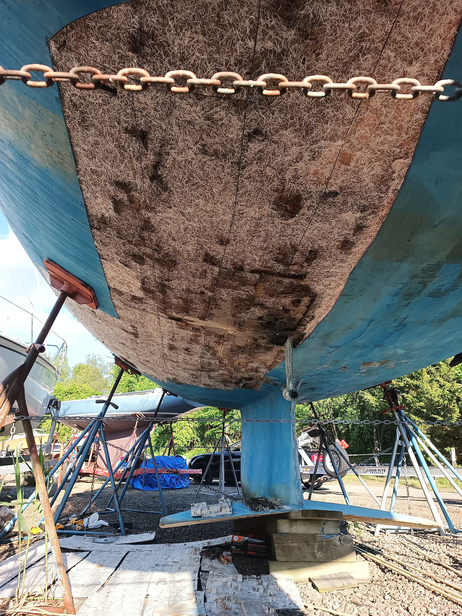

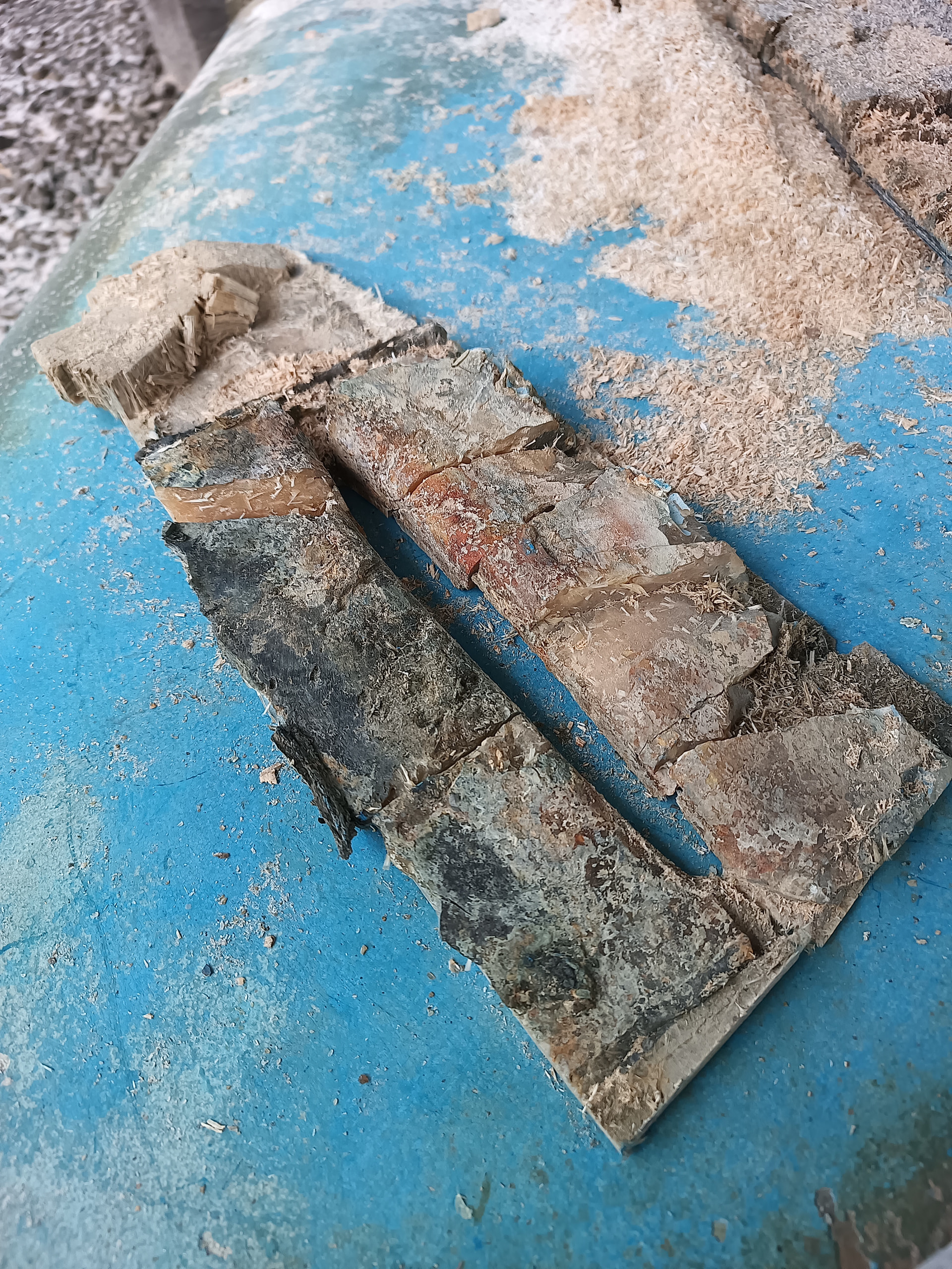

Just about every inch of exposed core in the pictures is wet. I still haven’t gotten to all the clean edges yet, restricted by the poppets. About half of it is still solid but moist, the other half is somewhere between delaminated and pure mush.

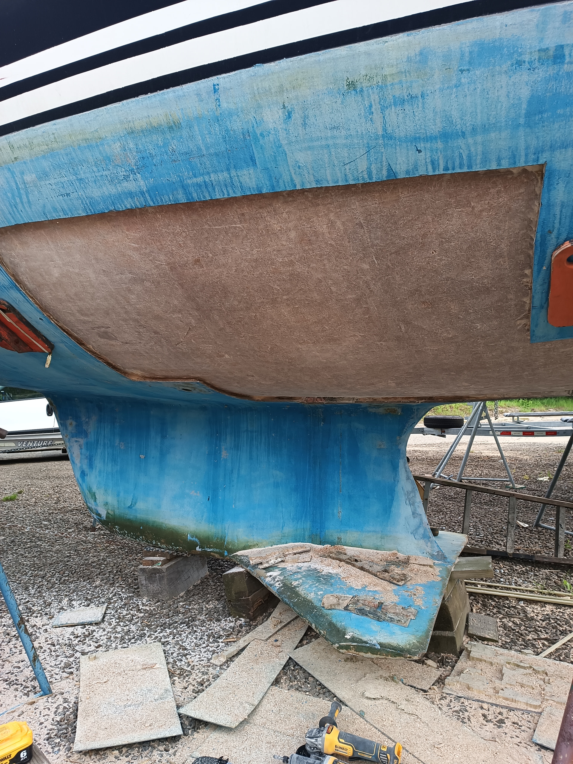

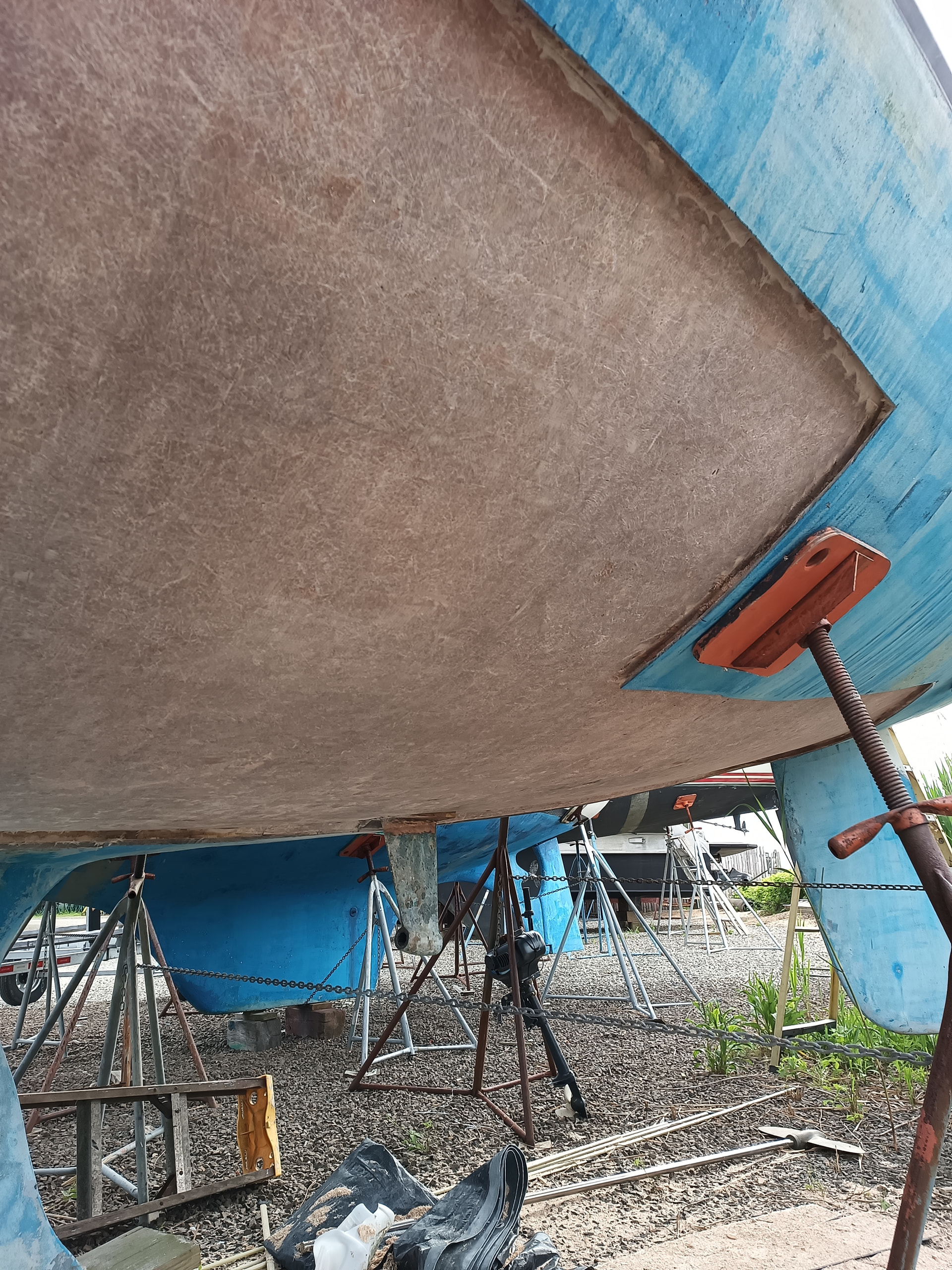

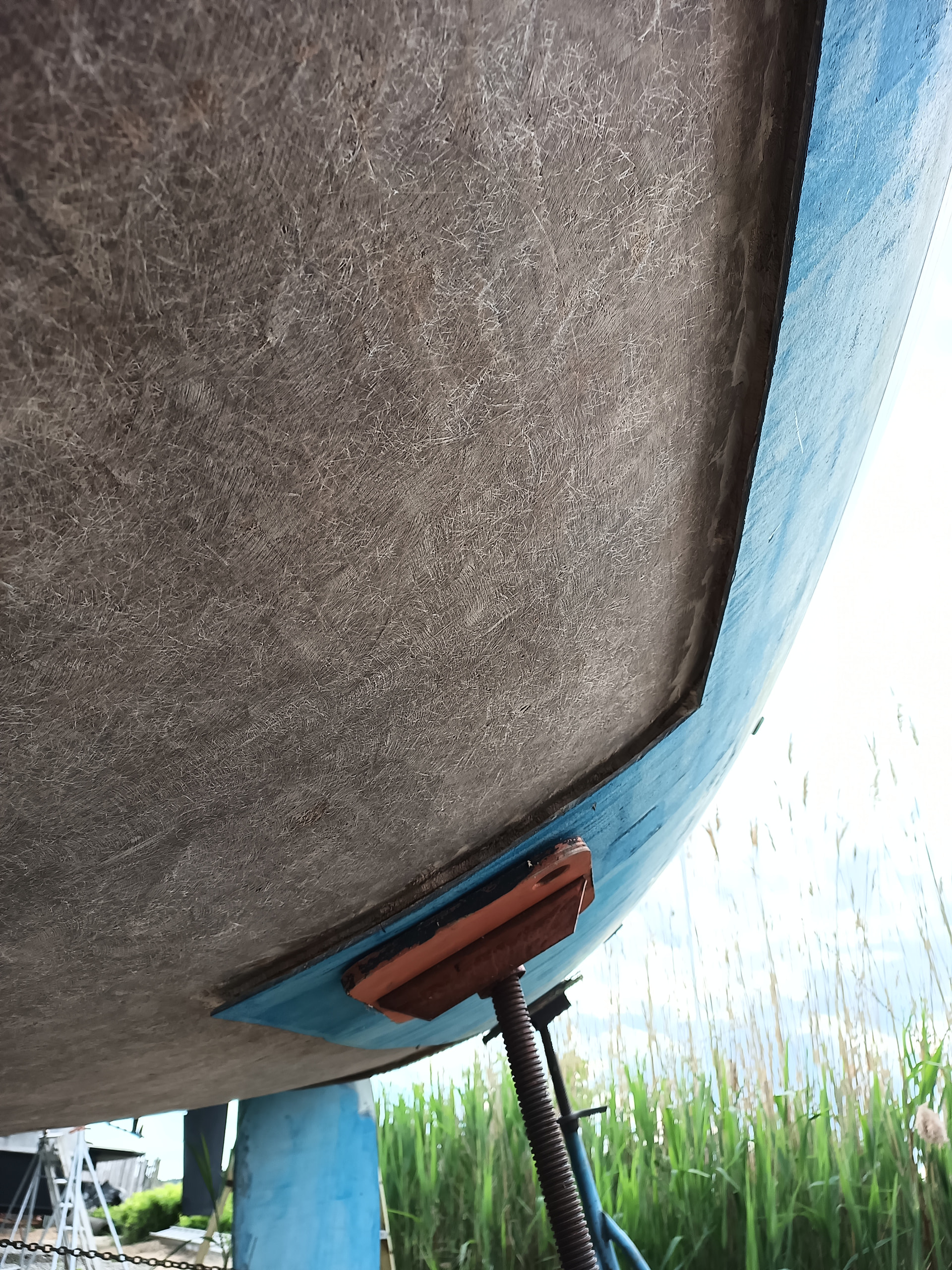

The core has been removed. I’ve removed about an inch inside the existing perimeter between the existing inner and outer hulls, this will be filled with thickened and reinforced epoxy.

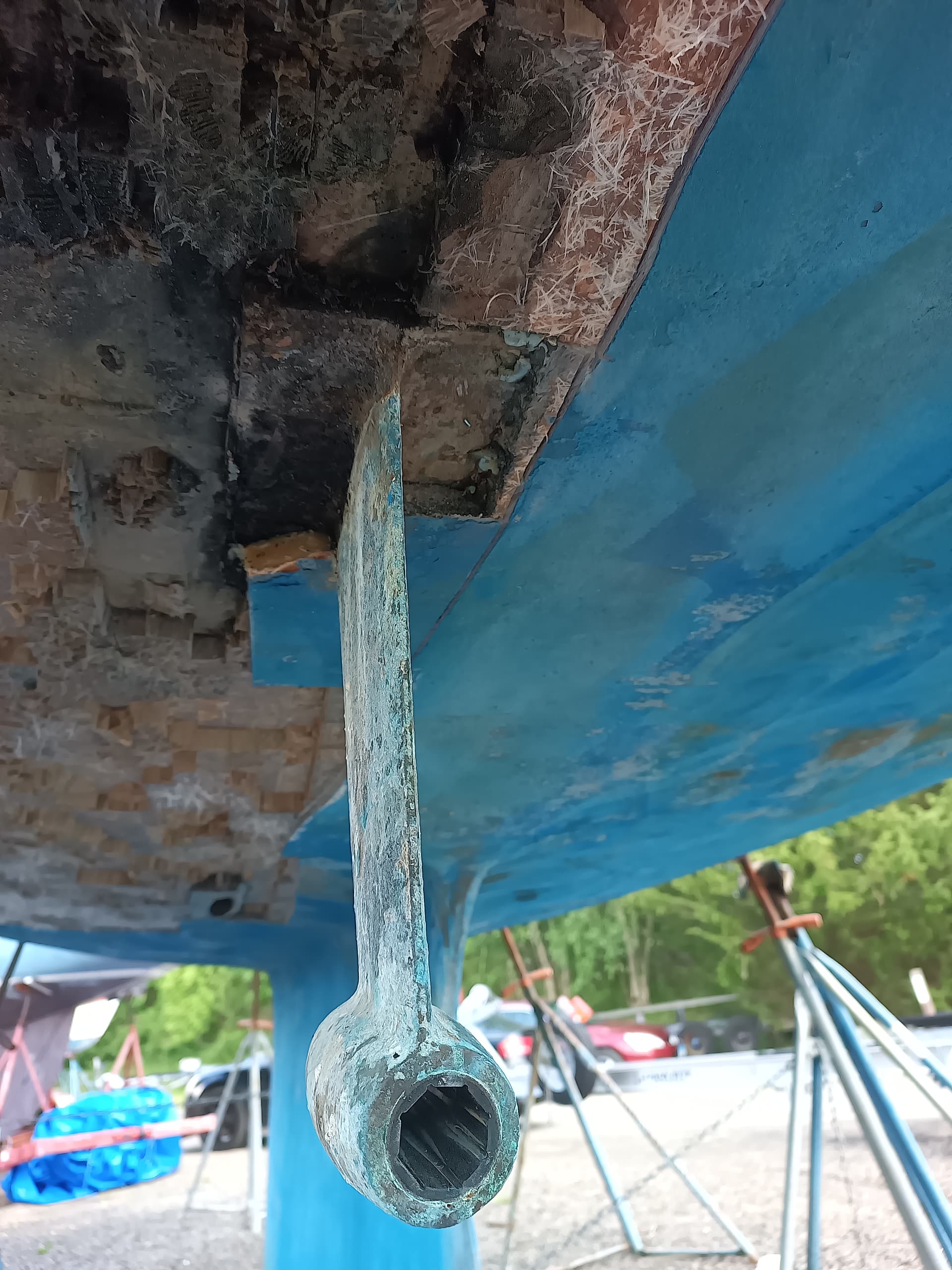

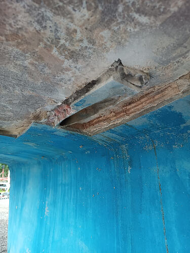

I still have to grind out the poorly thickened resin they stuffed around the shaft strut and shaft tube. That will also be filled with thickened and reinforced epoxy.
I have new balsa, laminate, and epoxy on hand. The basic plan is to stuff all the boundaries with thickened and very well reinforced epoxy, then vacuum bag the new core in. Hopefully in one go unless it’s ridiculously difficult. Doing the core in sections makes the vacuum bagging more difficult at the edges. That cures for a week.
Then install the laminate and vacuum bag it. I didn’t get anywhere trying to find the original layup schedule, but I’ve been assured that using epoxy in place of the original vinyl, and using alternating layers of (mostly) 17oz. +/-45* stitched fabric (without CSM) and (about a third) 12oz. 0/90* stitched fabric, will be stronger than the original.
The biggest fear I have is doing all the work upside down. There is a lack of information available. I’ve read some tricks, but if anyone has any tips or advice, it would be appreciated. Hopefully the thickened epoxy to bed in the core will keep it in place long enough to set up the bagging.
In some of the photos you can see how the balsa was basically layed up right against the shaft strut. The resin filler they used there doesn’t look very well reinforced, it looks like they dropped in just a pinch of chopped fiber in a cup worth of resin. You can see the resulting cracking. Like I said originally this was probably the initial ingress, but there is also some delamination around the shaft tube.
