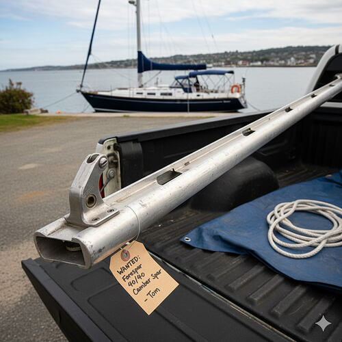

I still have what I believe to be the original jib with the camber spar pocket and some hardware that appears to be how it attached to the forestay, but I don’t have the camber spar or the boom. I’m sure the spar would not be hard to make. I plan to stay with the roller (I now have 2) though so if anyone wants the original, let me know.
If anyone has a either a 40/40 or 45 camber spar that is not needed/wanted, we are interested in purchasing it…thanks, Tom
I can confirm that I have both the camber spar and the boom that you mentioned. They are available.
Since you plan to stick with your roller furling system, having these original components might still be valuable for you, perhaps for historical reference or in case you ever decide to revert or sell the original jib to someone who wants the complete setup.
Since you already have the original jib sail and hardware, having the spar and boom means you would have the complete system.
$1,350 if you are buying or still want to negotiate price text ericpbash375@gmail.com
I have a camber spar from a 45 that im never ever going to use again after the damage it did to my mast. I have been flying the jib without it, its more work but I dont mind.
It’s available, but its in the caribbean…
Thanks for the offer! I recently acquired a spar locally on east coast…good sailing!! Tom
