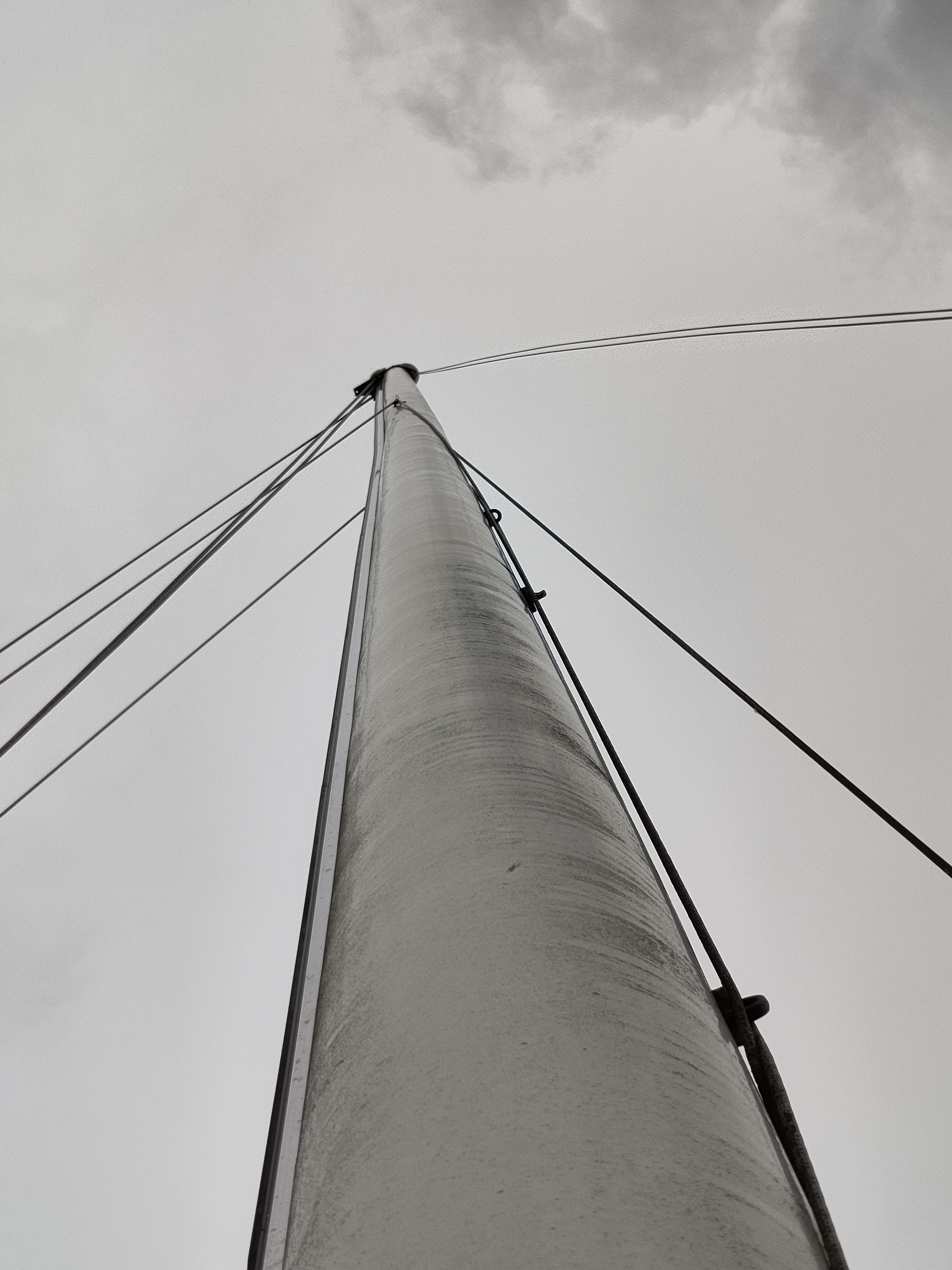

Adding a foresail is possible. Generally I would discourage a fractional rig. As with flying a mizzen staysail you have to add back stays. The gains may be less than the cost and effort. The idea of the cat ketch is simplicity and ease of handling. The early unstayed rigs were not designed for free flying sails. Later freedoms did include fractional sloops but I would expect the carbon layups were different

The cat sloop freedoms have their boomed jibs. They are on a slack forestay. It obviously does improve up wind performance by creating a slot effect over the main.
however I would suggest that whilst this does improve upwind performance the difference is not a huge amount compared with rigid mast foresails.
I have a blade jib on my 44 works like a dream!

These masts don’t rotate. But they’d be more efficient if they did, with the sail forming a nicer curve for the leading edge on the leeward pressure side of the sail, with less mast trublence.
That said, you’d need to design upper and lower mast collars and roller bearings for both masts. After giving both masts the usual sponberg treatment due to circumfrential cracking! Hell of a project, even to get the masts themselves back to good condition without changing the design is a heap of work. Most would opt for sails with luff sleeves that cover the entire masts, but those have their pros and cons too.
