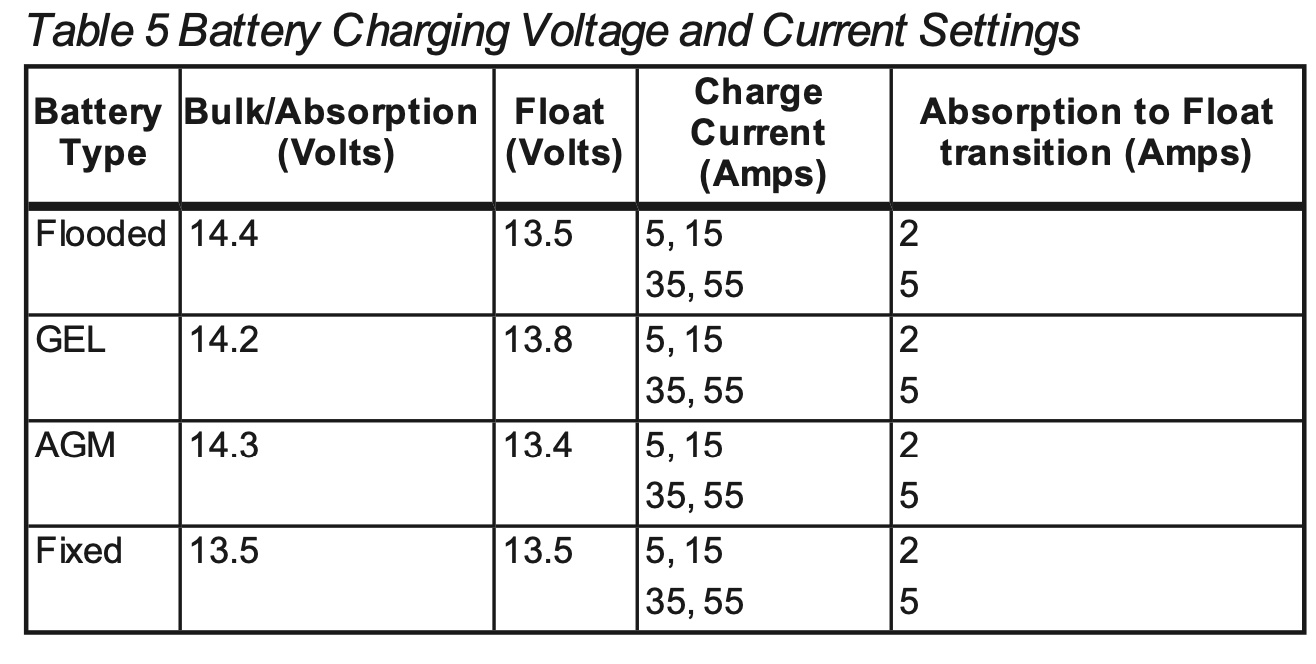

you can still use your Freedom HF, as long as you set it for flooded, see table from the manual:
I assume you are talking about LifePo4 batteries, which are less power dense but much safer than other lithium chemistries. Charging regime for these batteries is 14.2-14.6V bulk, with a float voltage of 13.6. I have a solar charger for a 200Ahr system and can set all voltages, but my previous setup had a charger set for flooded and it worked just fine. It will top out at about 90 odd percent at the slightly lower float voltage but that is no bad thing anyway.
