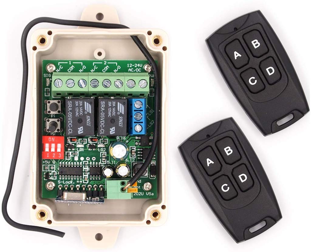

For wireless solution, I installed this kit that I bought for $19 from Amazon: [Solidremote 12V-24V Secure Wireless RF Remote Control Relay Switch]Solidremote 12V-24V Secure Wireless RF Remote Control Relay Switch](https://www.amazon.com/gp/product/B01JGDV8UM/ref=ppx_yo_dt_b_search_asin_title?ie=UTF8&psc=1)
I wired its relays up to the windlass contactor (a terminal strip helps keep the wires from the foot switches and the wireless relays organized) and powered it via the windlass circuit. In all, it took about 15 minutes to get it working.
For the past two seasons, it has performed flawlessly. If it quits working this year, I would happily buy another (though I doubt I will have to).

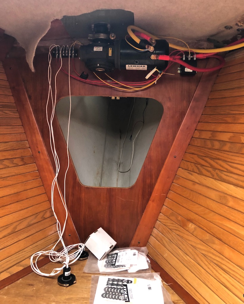

Here’s the newly installed windlass, before I added the wireless relays. You can see the foot switches, which are wired up but not yet installed in the deck.

As far as a wiring schematic, I basically just powered it from the windlass circuit, and then ran wires from the Common and Normally Open terminals on each relay to the terminals for each foot switch on the terminal strip. Very simple. Then, you just press the button on the circuit board to program the remote. I don’t recall exactly how that goes, but the instructions that come with it are pretty clear.
One other thing, in case people are wondering: the range is really impressive. While testing it, I remember that I was able to get several hundred feet away before it started having difficulties.

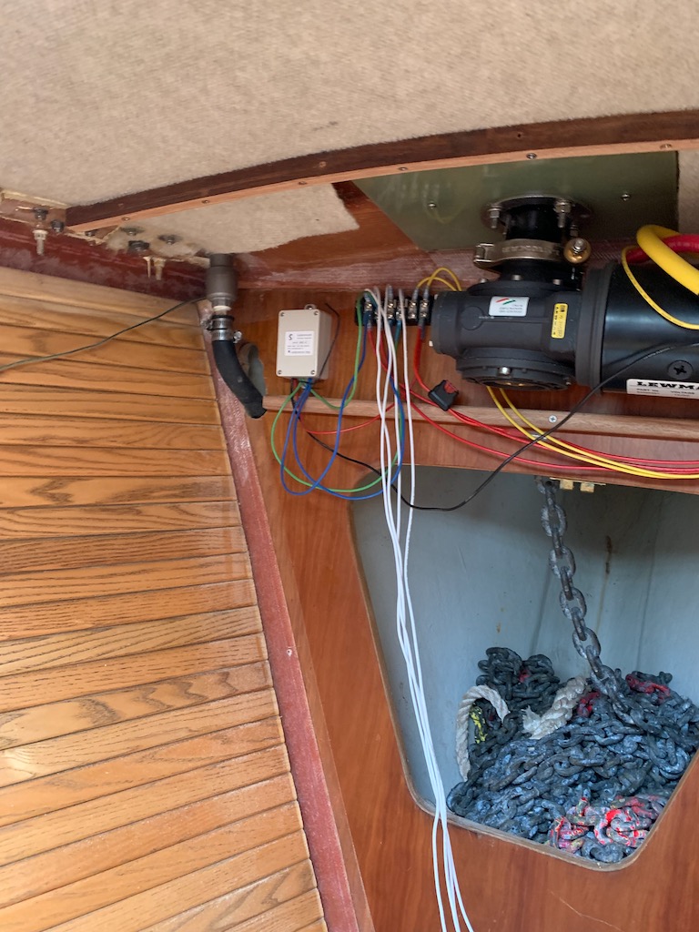

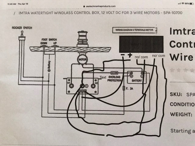

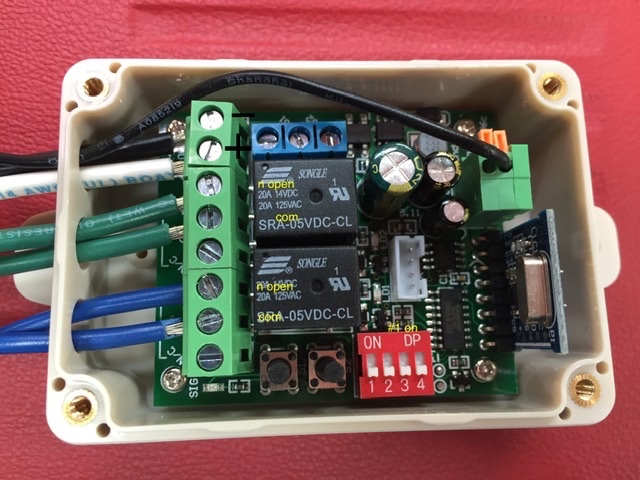

After getting an email from my marina stating we could come to inspect our boats, I did drive to Good Way today- and installed the Solidremote 202U windlass relay. If I were very tiny it would have taken 15 minutes but as I’m not it took 3 hrs. Once I dropped the v berth upper panel I noticed the windlass had a windlass control box mounted nearby which made wiring in the remote receiver “easy”, size and space notwithstanding. I did download a wiring schematic for the control box, which helped a lot. My receiver had 4 dip switches and I placed 1 on and the rest off. Pressing the remote fob on button A saw windlass spin down as long as button was depressed and button B pressed saw windlass up but I have to press button again to stop - no big deal - I have the dip switches off I’m sure (figures ). Pretty sure all 4 do’s need to be off for just a hold and release mode.

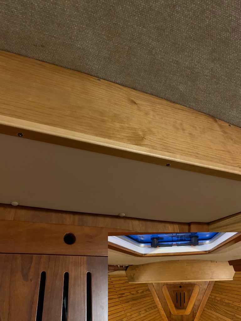

Great idea and $17.00 well spent. I re installed the upper panel and will replace that with cherry in the future.
On the control box- the 3 yellow connectors are windlass up, -bat, down. The middle red cable behind is +bat and had a smaller red wire connected to its post coming from the foot deck switches common, which I spliced into…
Remote fob seems great- easily operated the windlass from my pushpit. Very solid feel :smiley:
I flipped the 4 dp switches on the receiver to all off and now windlass up and down are both hold and release. Included is my quickie schematic .

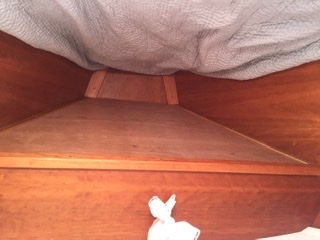

Here is the veneered top pane (can’t get the pic flipped!) l - nice colormatching :smiley:
