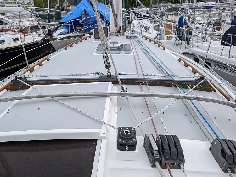

Antal two-way traveler winch install
I just finished installing the Antal two-way winch to handle the traveler controls. The 8:1 winch and the 2:1 blocks gives me a 16:1 purchase. 12 turns on winch to go from all the way port to all the way stbd.
Great idea, very nice. I’m certain that you will miss the burns though. I may need to consider this mod, I like it.
A great solution. I am trying to think of how I could install one on my F40/40. I am the only person that seems to be able to adjust the traveler by hand, even with all the purchase. There is so much friction in the system. Wondering if any others with F40/40s have come up with a solution.

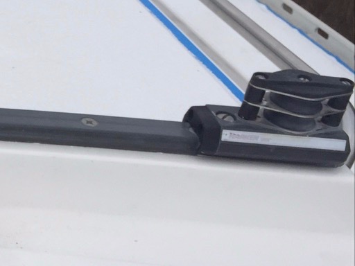

Salacia - I believe my 1999 F35 P also needs traveler ball bearing replacement :smiley: Did you use Torlon bAlls? What size and how many did you need to buy (packs)? All set to try too… Do your end pieces look like these?
The parts are all Harken. For the traveler car, use HBB197 Big Boat Non-captive Bearing Car Rebuild Kit. Yes, big boat. This is a big main.

You might also want to change the bearings in the control cars. Part # 176 6 mm Delrin Ball Bearing — 21 Balls per bag. You will probably need more than one bag. I don’t know how many per block.

I am also considering going down to 5/16 line to help reduce friction. The way the blocks are set up on the F40/40 there are places where the line seems to just barely touch moving in opposite directions.
