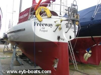

Has anyone got experience of mounting an Aries windvane on an F35 cat ketch? I have bought one with the Aries not attached to a specific stern mount - it looks like it may have had its control lines linked straight to blocks on the rudder, rather than working on the wheel mounting. Photos of any Aries stern mounts would help! Thanks for any info.

I found this picture of an Aries wind vane on the stern of a Freedom 35 Cat Ketch (not my boat, I had a Windpilot on my first F35).
Cheers, Peter
