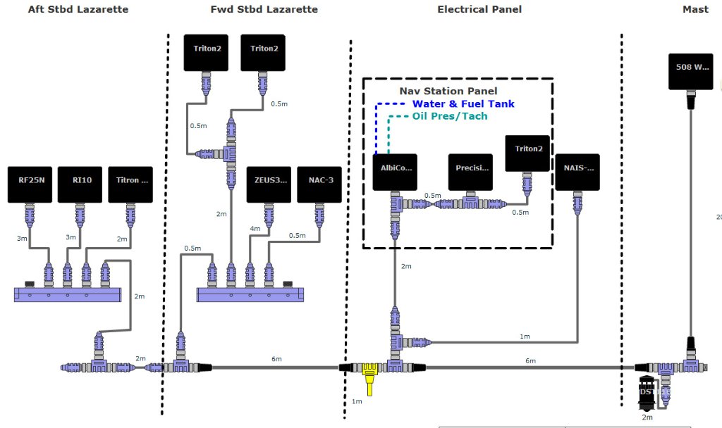

could you elaborate on the installation of the B&G plotter? We’re considering replacing our original (?) Furuno plotter with the B&G Zeus3, which I believe has an autopilot control module as well. We already have newish B&G wind/depth instruments. I would hope they would all play nicely together, but before we take the plunge, it would be good to know what’s involved. Are there additional parts to buy, such as the NMEA2000 control module. We’d also like to add AIS eventually. Thanks for any info you, or anyone else, can provide!
I’m not exactly sure what you want to see, but here’s a network schematic of my installation:
Great schematic. Did you draw that in Visio?
I used a program called N2K Builder from Maertron, which allows you to design and verify your network design.
Nice. I will look for it.
