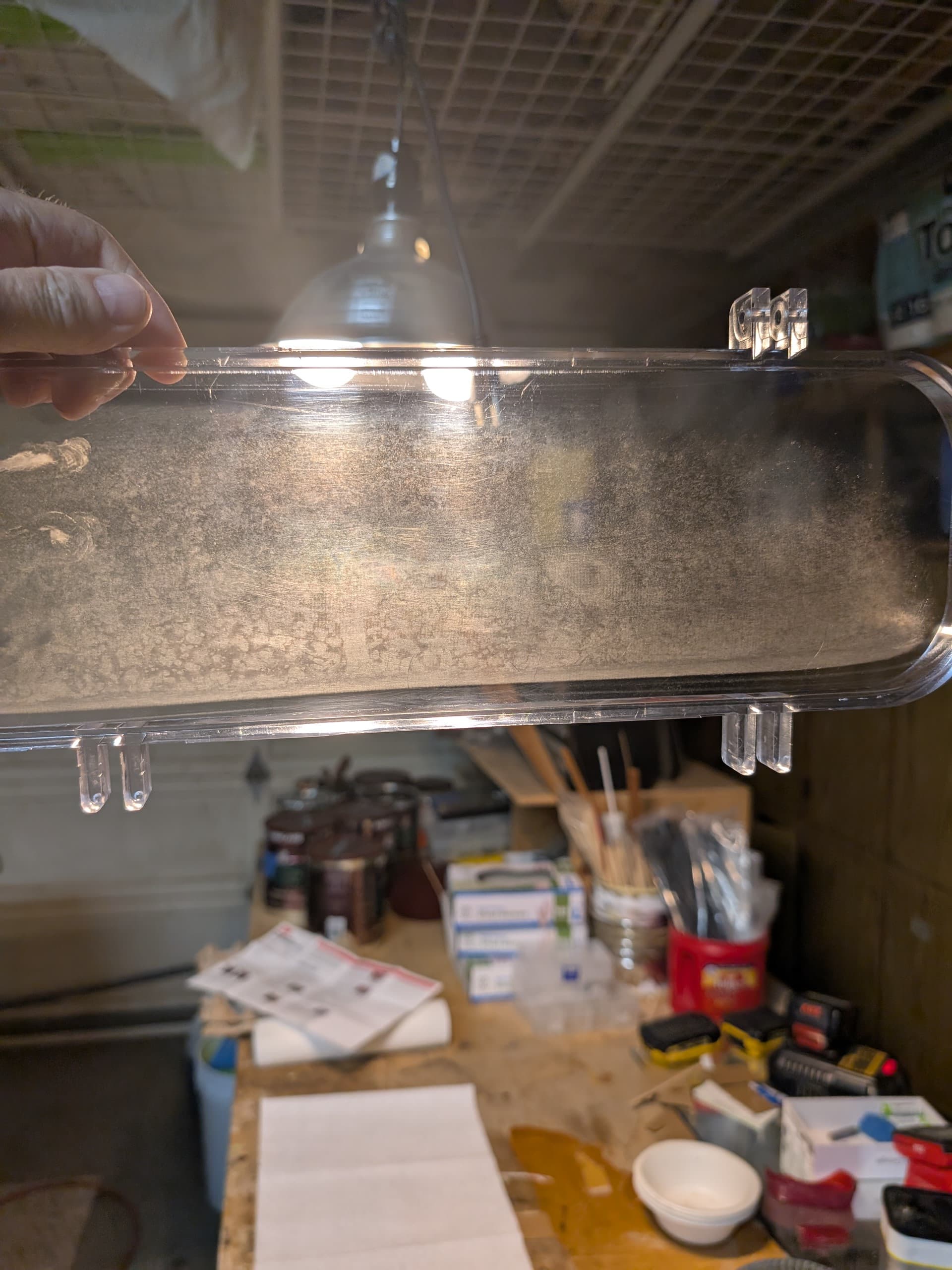

However the glass is getting pretty oxidized and cloudy. Minor issue and new ones are $70 each so a low priority. I had them in the back of my mind for replacement someday.

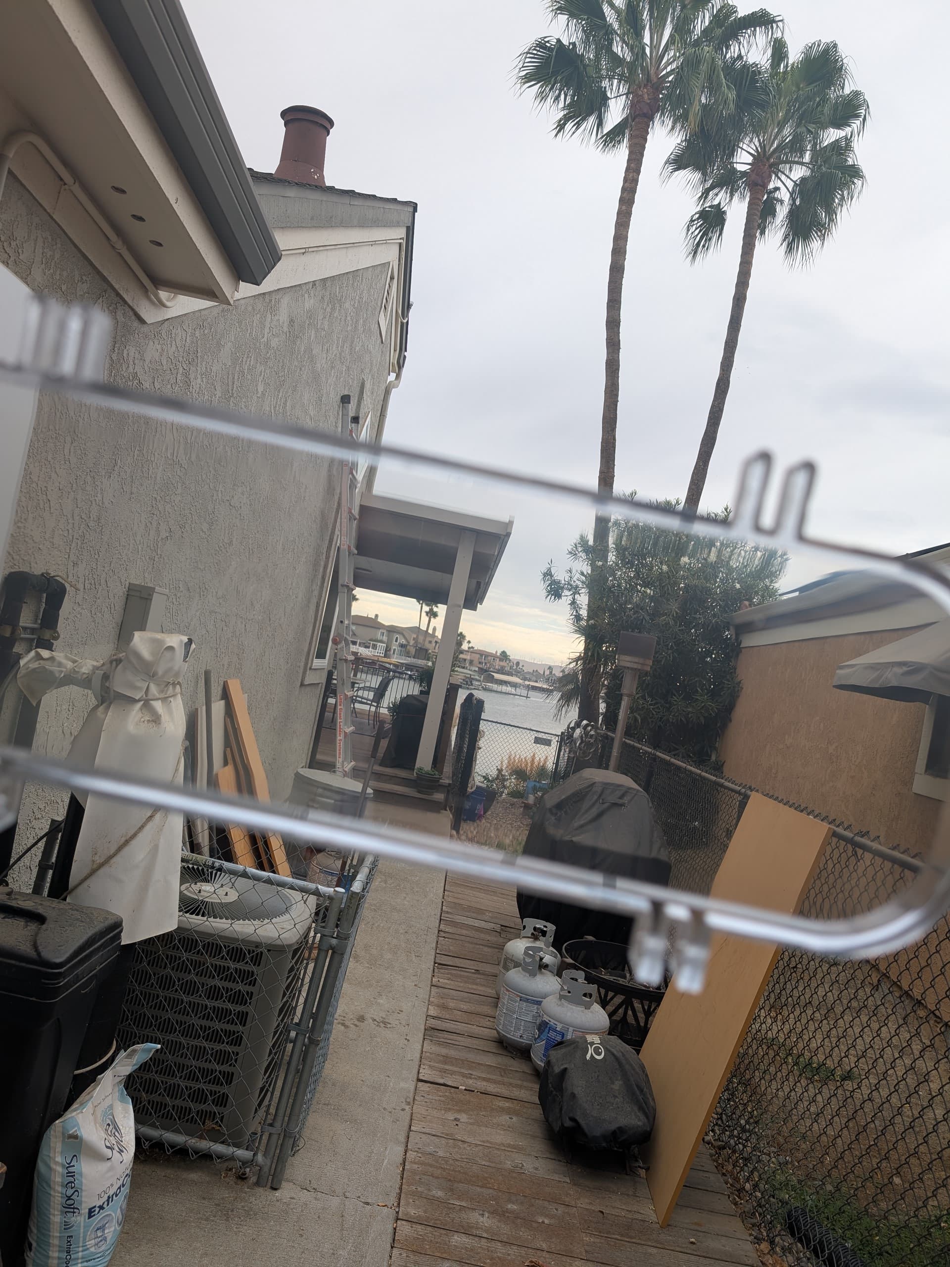

Ordered a kit and here are the results. I am pretty happy. If carefully inspected the restored lens does show some faint scratches from the 3000 grit sandpaper in the kit but is way way better than it was. The restore kit costs 10 bucks and I can get at least two ports out of the kit. The kit comes with a special UV coating which is applied after final sanding. On the next one I may use some of my 4000 and 7000 grit paper to see if I can get them to really look new. I may have to refresh the restore periodically but I don’t think I’ll be buying new lenses for quite some time.
Oxidized lens
restored lens

My primary objective of the post is “don’t throw the foggy windows away” They can be brought back to near New. In my case it took about 15 mins of actual work and an hour for the protectant to dry.
For any who haven’t actually removed one, it is dead simple to get them off and into your workshop.
