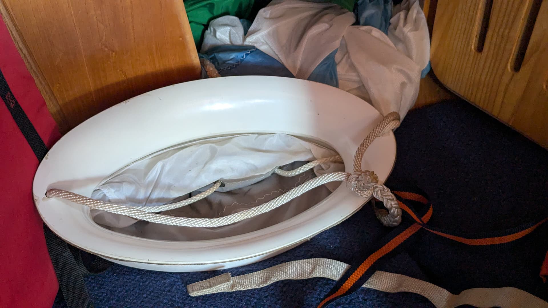

I am making one out of fibreglass looking at a deep washing bowl as my mold tunnel with a shaped top that fits over the pulpit to make it simpler to attach . The bag will be clamped to this chute with a jubilee clip Look at the mirror chute

Could you send me a photo of the fibreglass one please

When I next get to the boat.

Dangit, I forgot. Next next time I’m on the boat.
