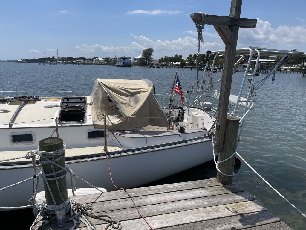

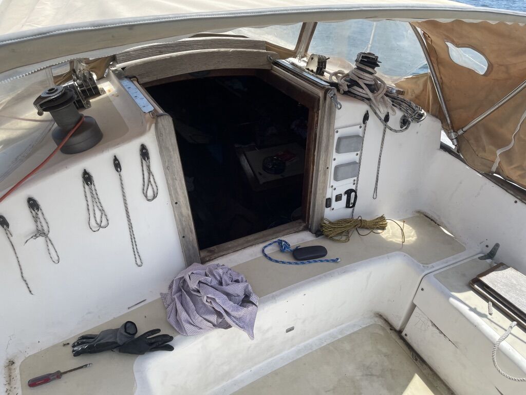

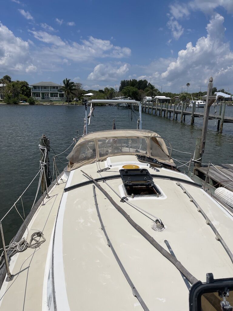

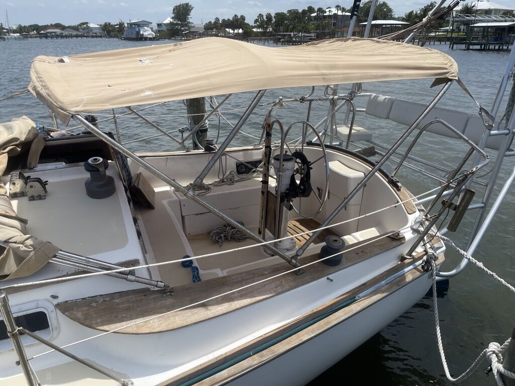

Have a 1982 Freedom 33 cat catch hull number 38. I have the Bimini and the Dodger, both have stainless steel frames. The material and isinglass should be replaced. I live in Florida on the East Coast near Sebastian Inlet. The vessel is presently in the yard being restored, 90% sure we will be building a Hard dodger, afterwards there will be no need for me to hang on to those items.

Smh pics of the dodger and traveler would be helpful even if not on the boat too.

Thank you for the pics. More or less what is the clearance between the boom and the top of the bimini?
