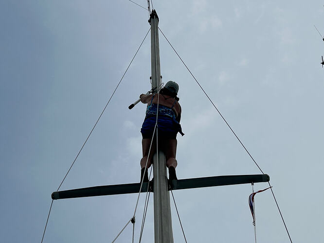

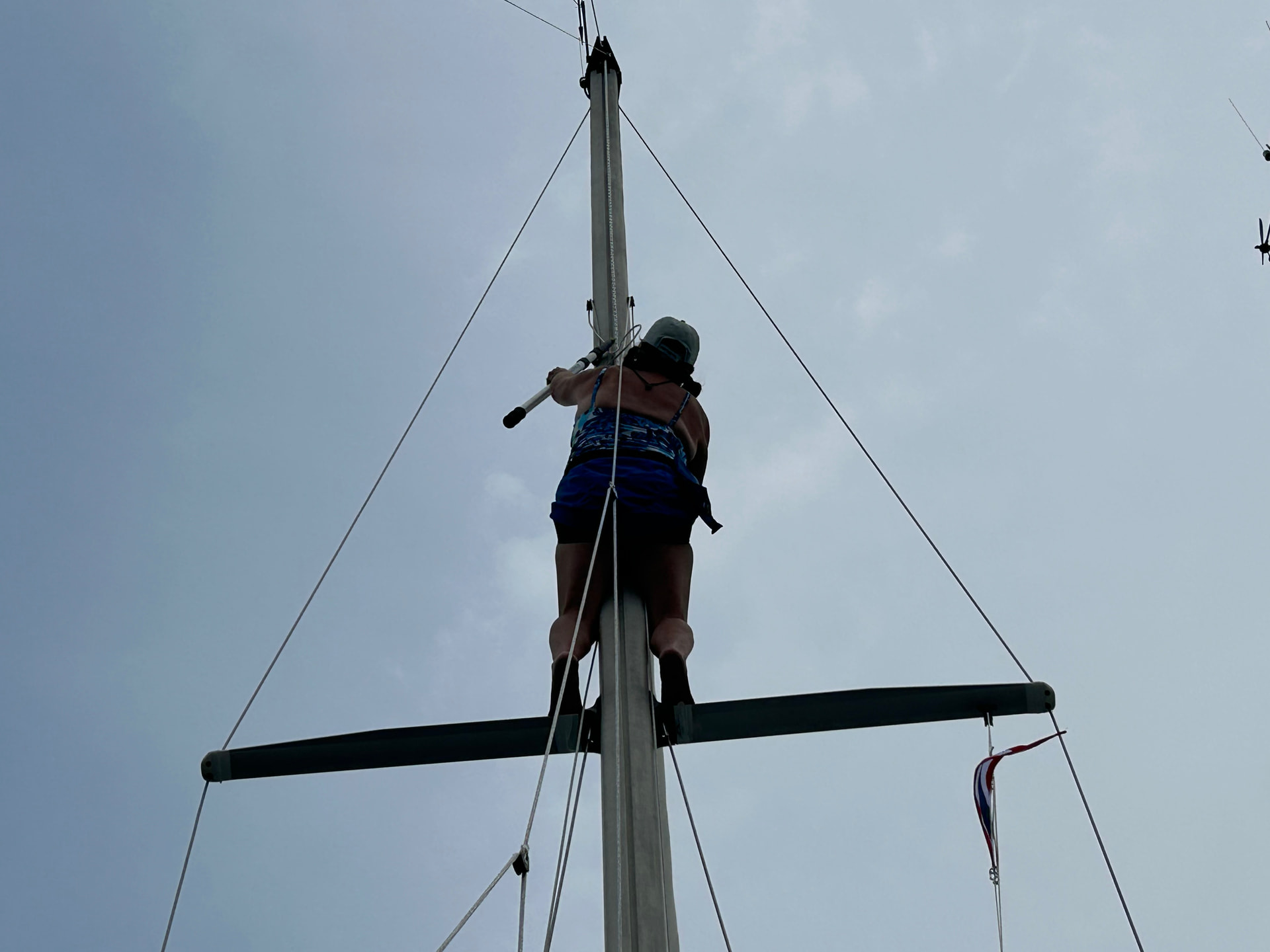

Interesting. She went up the spar, derigged the failed stay and rigged the new one. On the mooring. Boatyard guys think she’s nuts.
The previous owner of my boat told me that a common problem with the carbon spars is that due to their ability to flex and pump in a seaway, they can pop forestays if the forestay is too tight. Some 40/40 and 45 owners have attached running back stays to the spot where the lazy jack blocks mount to counteract the pumping but he said it wasnt that necessary as long as the forestay has some wiggle room. Also, if you do loose a forestay, theres no issue with the risk of the mast coming down. Keep on sailing with just the main.
Yup, did the same, but in a very calm mooring field at Hadley Harbor.
Not sure how loose is too loose, but the new forestay has some slack in it.
We have a spare halyard rigged to the end of the boom as a topping lift and to hold up the aft end of the sail stackpack tubes. I wonder if all that weight counteracts the mast pumping somewhat.
So, who went up there? There is definitely a pattern. On the spar of the Pearson.
I went up there, Riki was running the winch. It turns out that sitting in the bosun’s chair/harness (I was using both) for an hour+ is not very comfortable when you can’t stand or sit on the spreaders, and juggling the forestay, bolts, wrenches and dyneema backup up there is tricky while being uncomfortable. It was a spectacle for boats moored at Hadley Harbor.
