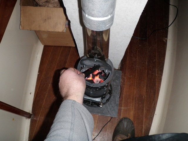

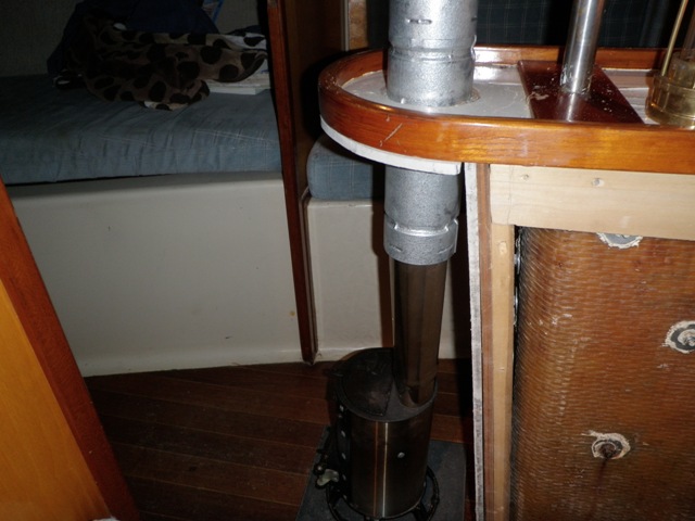

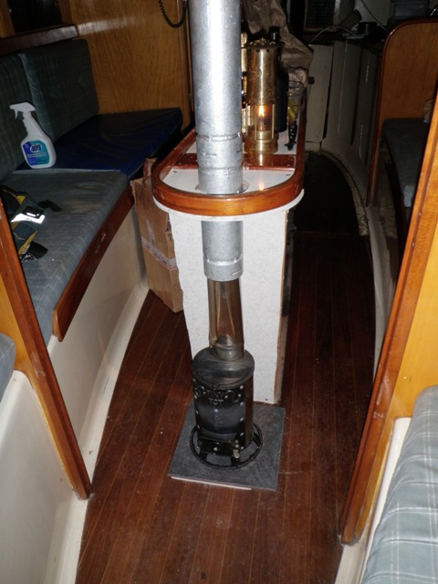

I’m in process of finishing cosmetic details of my new heater :slight_smile: My boat is still in water, and I used the heater recently, spending New Year Eve on my boat. I didn’t try antacite yet, charcoal works OK.
