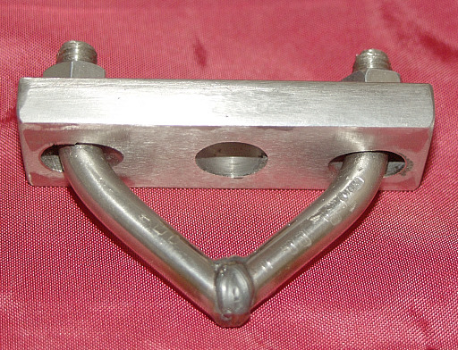

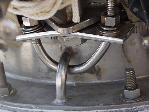

My biggest issue is the collar rotating in high winds. I have a piece that I made that keeps it from sliding up/around. It attaches to the mast collar ring just below where the boom vang attaches to its collar. The bolt for the boom vang goes through the hole in the center of it. The first photo shows an early version which was much too light, and the other photo shows the final version, which I think uses 1/2" stainless and 3/8" rod, before installation.
Thanks Geoff. Rubber sheet makes sense and is easy. Interesting issue with your collar riding up since mine has had the opposite problem. I have to get some welding work done for a different project so might make sense to have the “hold down” fitting made up at the same time just in case.
