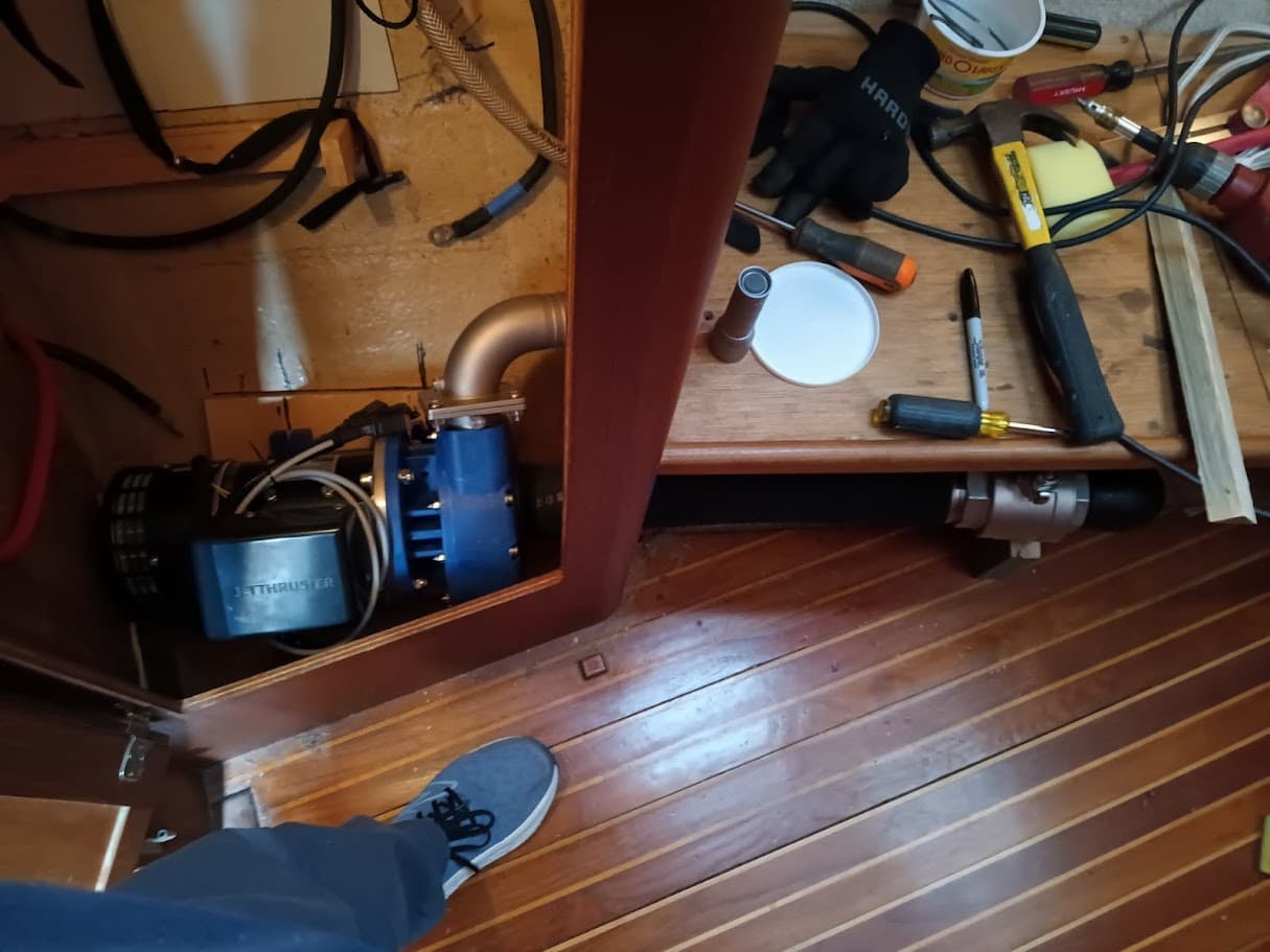

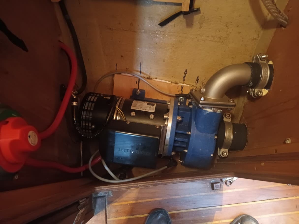

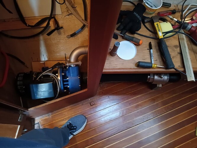

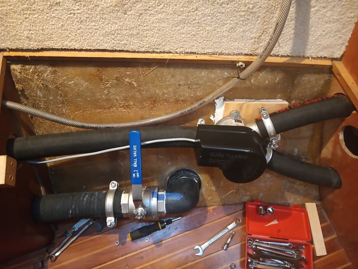

I have started the installation of JetThruster. This is the dry fit of pump and intake. Tight but the pump will fit in the bottom of stateroom closet.
Is the black hose pointing forward under the seat the intake? Where are you routing it to?
The intake is on the right in the picture, the 3 in hose runs to the left in the picture to the center of the pump. The silver 90 degree elbow on the top of the pump is the discharge which runs to the bow.

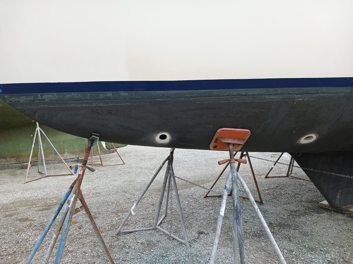

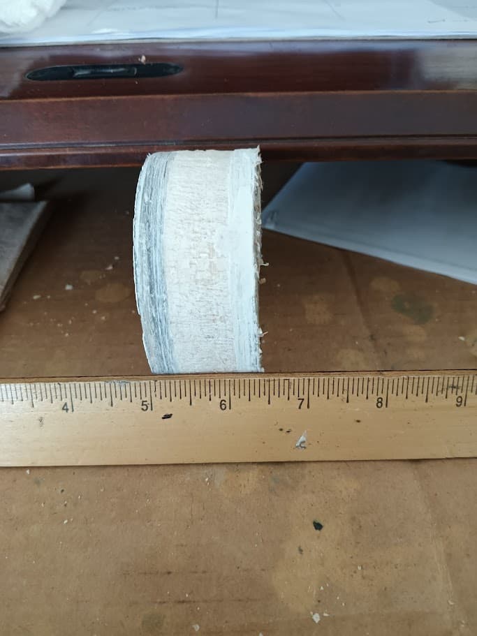

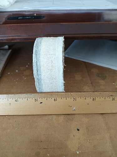

The out of water work has started. Aft hole is intake, front is port nozzle which measures 34 inches back from bow at waterline. The core pic is just to show the layup for the 39 Express and that 39 years after the hull was layed up the coreis still BONE DRY…

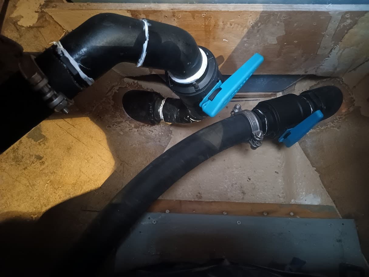

Installation completed and launched today. It performs as advertized, brought bow through a 15 knot wind with power to spare. Have one leak in the yard portion of the installation which they will address next week. The rest of the installation,including the wiring, is straight forward. Happy with the products quality and support from Jet Thruster (Andrew Banks) and the performance.
This looks amazing, and the performance sounds impressive. Will you share the model you used and the cost of install?
I installed the JT-50 which was the recommended size. I had the yard do the install of nozzles and intake thru hulls and build out to the ball valves, I did the rest. Material prices are listed on Jet Thruster web page, labor for yard was $3.5K all in.
