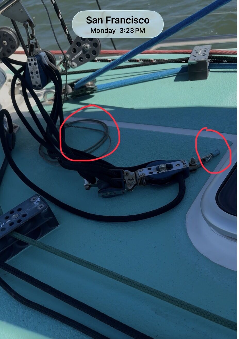

Yesterday sailing to my marina from the demarkation line a ferry past in front carrying a steep wake. I was moving down wind in 16-17 kts tws, with full main and some tension on my boom vang. When i met the wake, the bow went up and then down hard, the boom vang ss cable immediately parted. this is the second time this has occurred. My plan is to double the ss wire size to 1/4” and double or triple crimp both ends.

Erik - thanks for the idea. I bought some 3/16” dynema and will try to double it up on the boom vang for the cable area. Should be there tomorrow to try it. It does advertise as more breaking strength than the similar sized ss. Let you know. On the boom vang down wind thing - I think on this boat going down wind with boom way out more tension on the vang is better - it would prevent the boom from lifting any in the wake conditions described. I do crank on the vang in higher wind conditions down wind keeping the leech in tension, and when over Powered, by blowing the vang clutch, the boom lifts dramatically and spills air. After the puff I crank on the vang again. In this instance a couple days ago, the wind down wind was relatively light and I had only slight tension in the vang. The steep wake gave the vang enough room to move up a bit and then broke on the down motion.

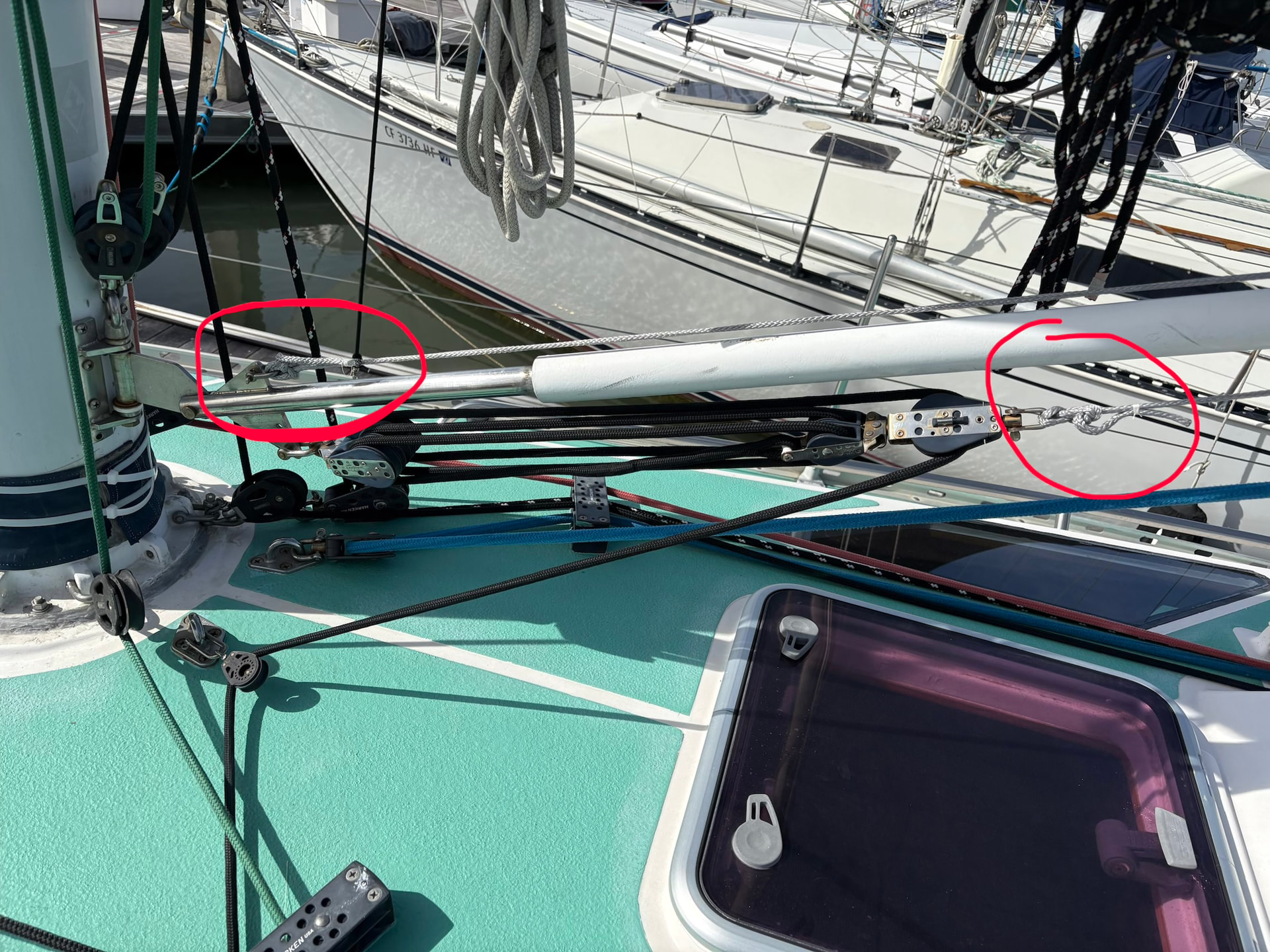

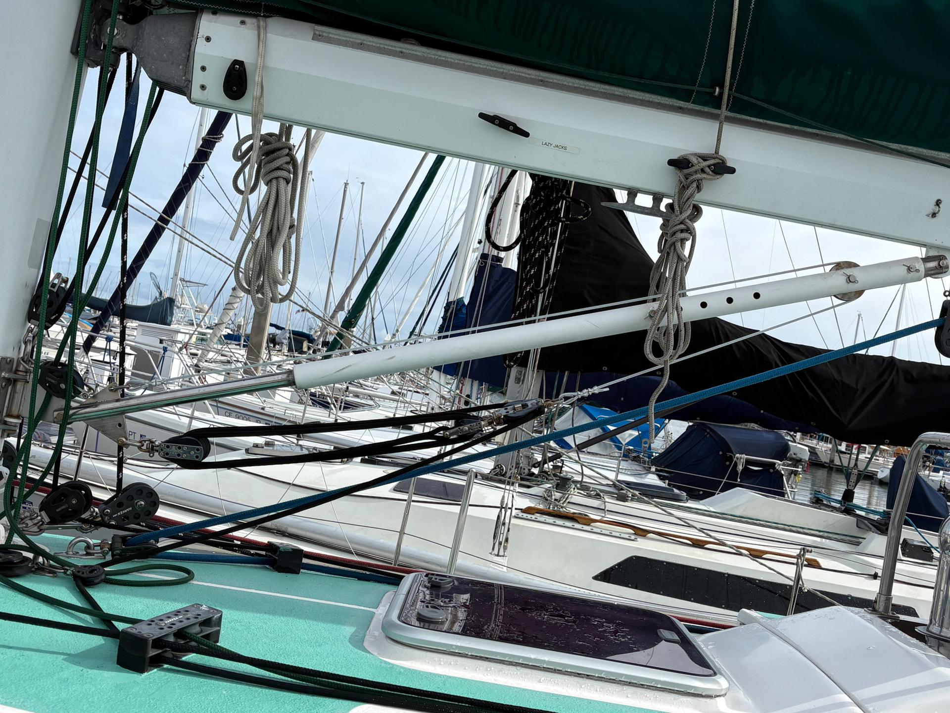

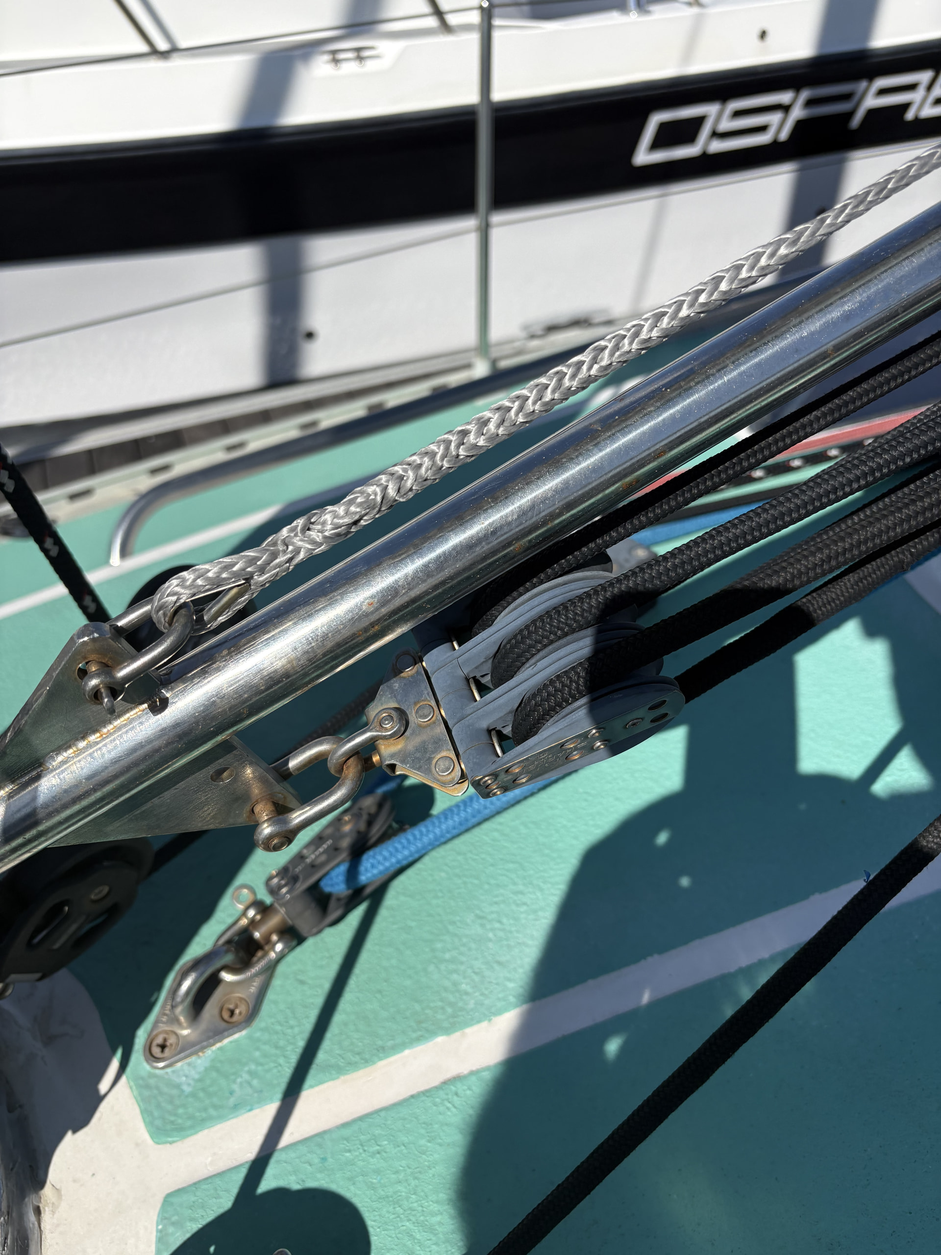

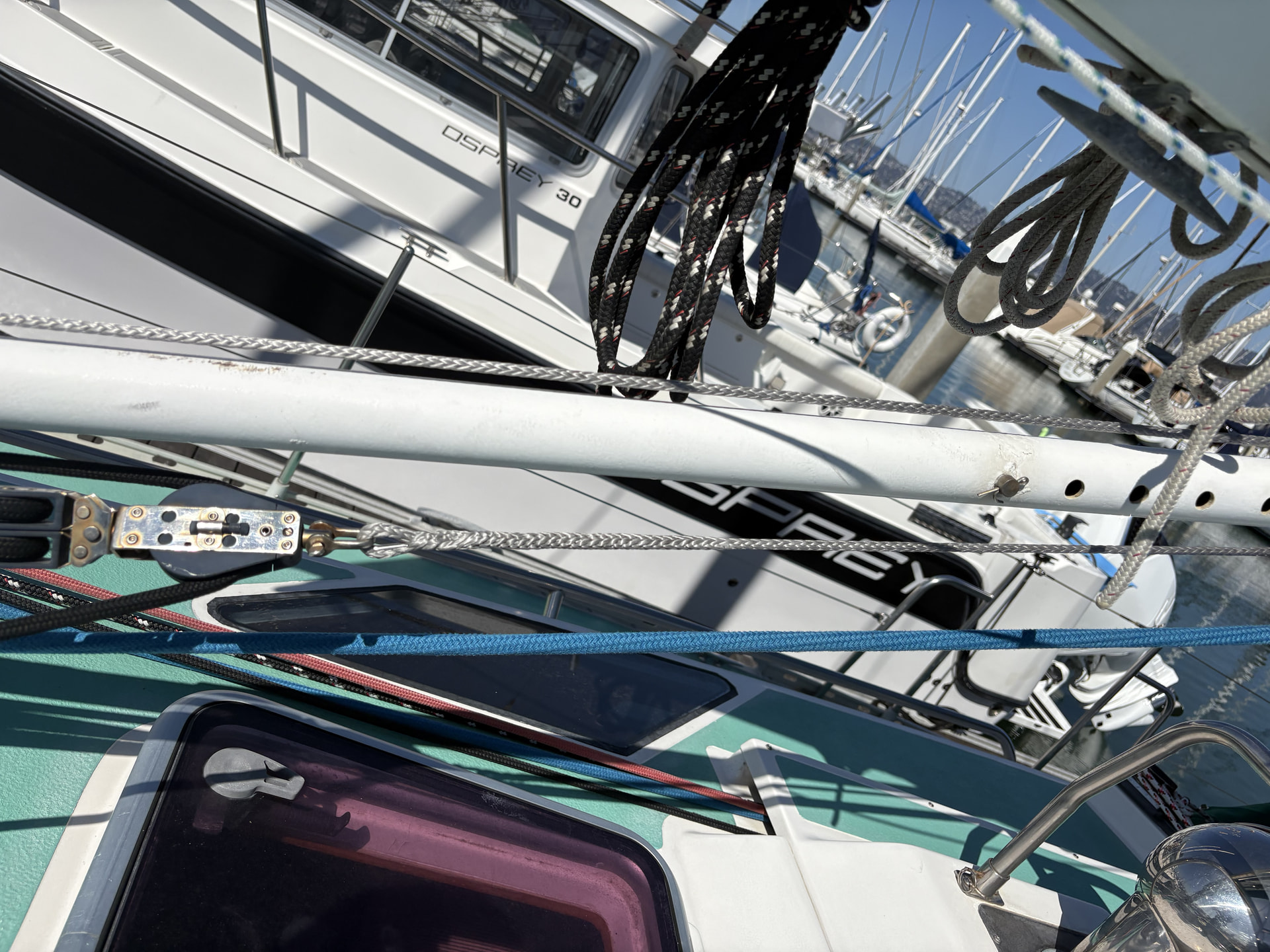

Busy work day at the boat - I spliced 1/4” amsteel dynema at both ends on the vang as shown. Looks robust….but we’ll see what happens in a seaway
