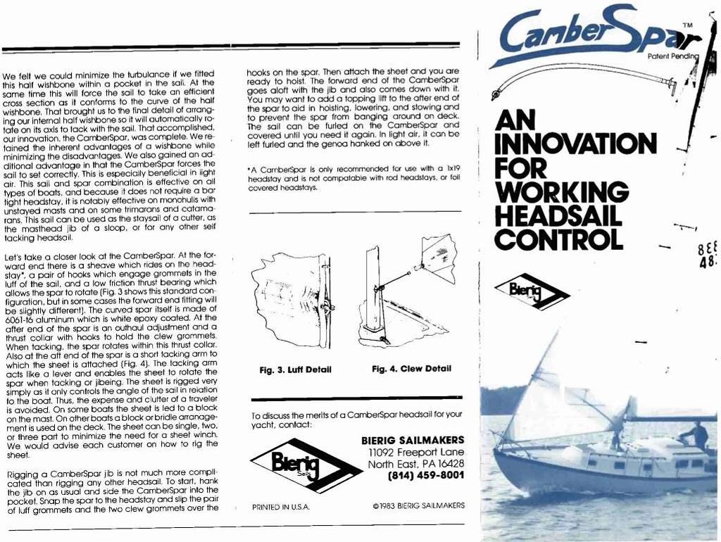

In any event, it the process of trying to get my brain wrapped around this spar, I found Bierig’s original patent which provides a thorough overview of what the parts are called and exactly how the thing is supposed to work. I have attached it here for posterity.

Hi Mike- thanks for posting that patent application! It was a very interesting read and such a clever way of adjusting the draft in a small jib as the spar is rotated. In the Freedoms, the jib becomes much more useful and powerful than a standard working jib, and downwind it becomes like a built in whisker pole. As for your 16” draft, that seems far too deep, however I would think that potential depth should only be reached if the spar is rotated to the horizontal, otherwise it should only be partially rotated. My guess is that maybe your fabricator used the curve of your luff pocket to determine the spar curvature? If the full draft is never realized by lack of rotation (as when sheeted in) I’m not sure it would be a big issue.

Mark, last sentence of your post is right on. I finally understood that as we get closer to the wind and sheet in we are taking draft out of the sail. Duh on me. I also remeasured the draft and I am around 14 inches. If I use the formula CS length in inches ( mine is 96) then multiply by 13% you wind up with approx 12.5 inches. So I am pretty close. Then the article Geoff posted mentioned “eyeballing it” so eyeballing implies you got some wiggle room. I plan to use the wiggle room and take no action on the bend.
However. Now that I finally understand how the thing works. I am going to really focus on trying to get the sail shape cleaned up. My new sail should help a lot!
I had never fully appreciated how much thought went into the design and how clever it was until I read the patent application.
Here’s another article to add to the collection…
