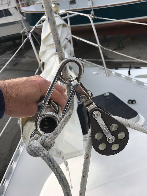

Here’s what mine looks like. Can’t guarantee that it’s right, just the way it has always been.

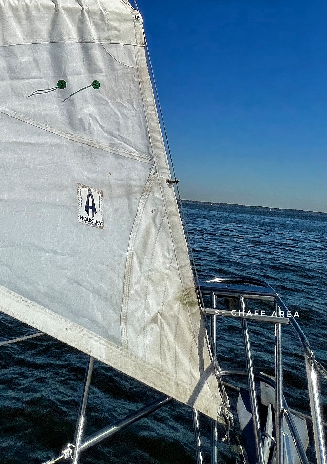

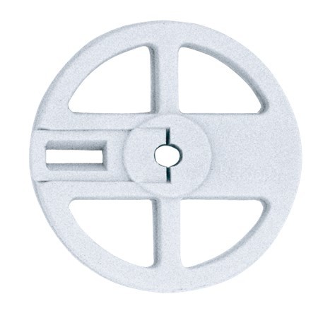

I would suggest using a plastic sail chafe protector instead, as metal clamps like these can bend/weaken the strands of wire. Also, it’s always good to avoid sharp edges (like the threaded ends of the U-bolt) near the sail. Harken makes this one, and Ronstan makes a cheaper version. You may need to drill out the center hole a bit to open it up. Mine has been in place for 3 years without issue.
I put a Dyneema forestay on after breaking the wire twice in 3 years. I like that sail chafe “platform” as a way of keeping the sail from dropping onto the deck. My plan was to run a PVC pipe a little ways up the forestay to have the camberspar rest on that, but always felt a bit hackneyed and wouldn’t stand up to UV for very long.
Funny you guys mentioning the standoff. I removed the forestay at the deck and slid it through a foot long section of very stiff air pump hose. Does a nice job keeping the jib off the deck.

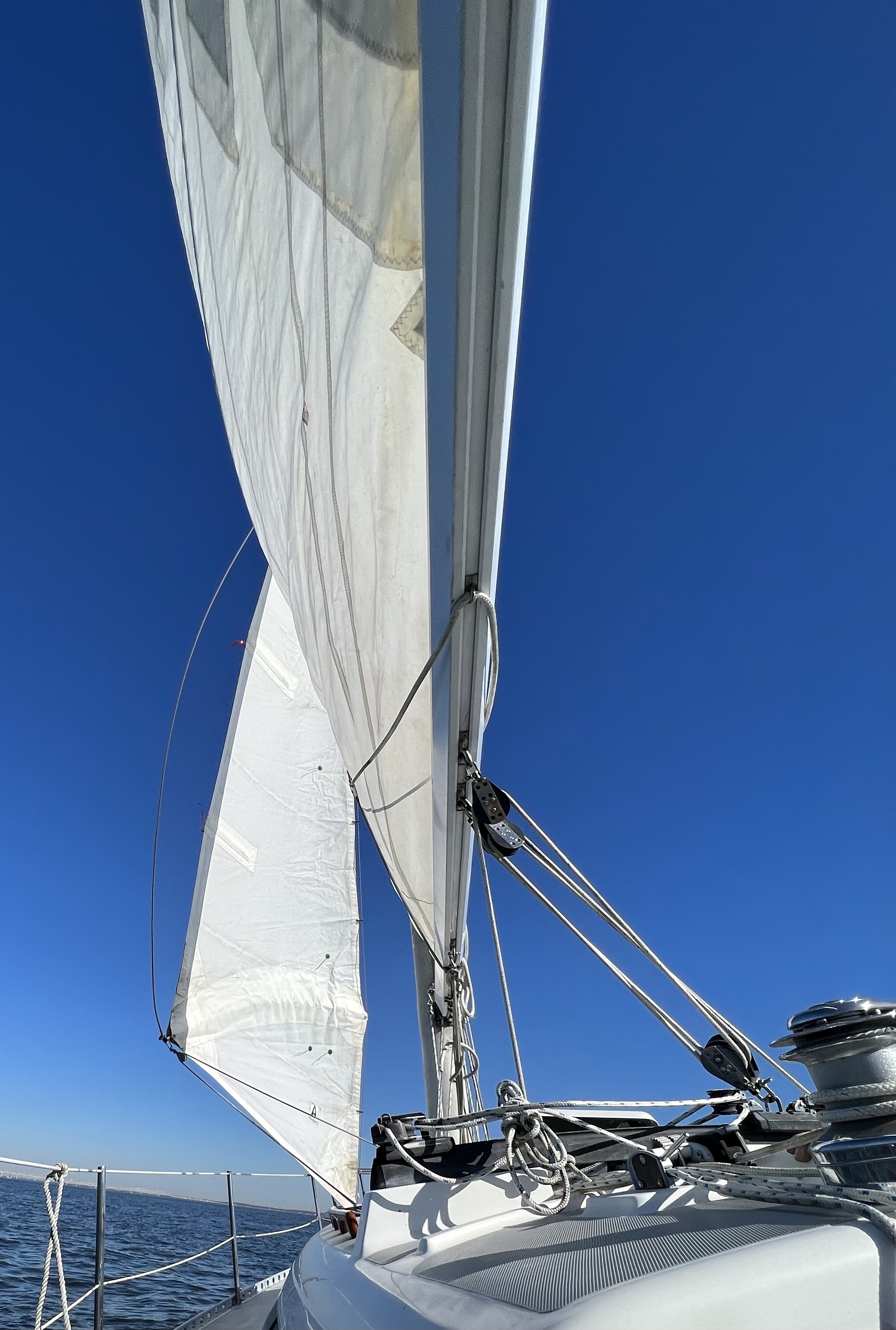

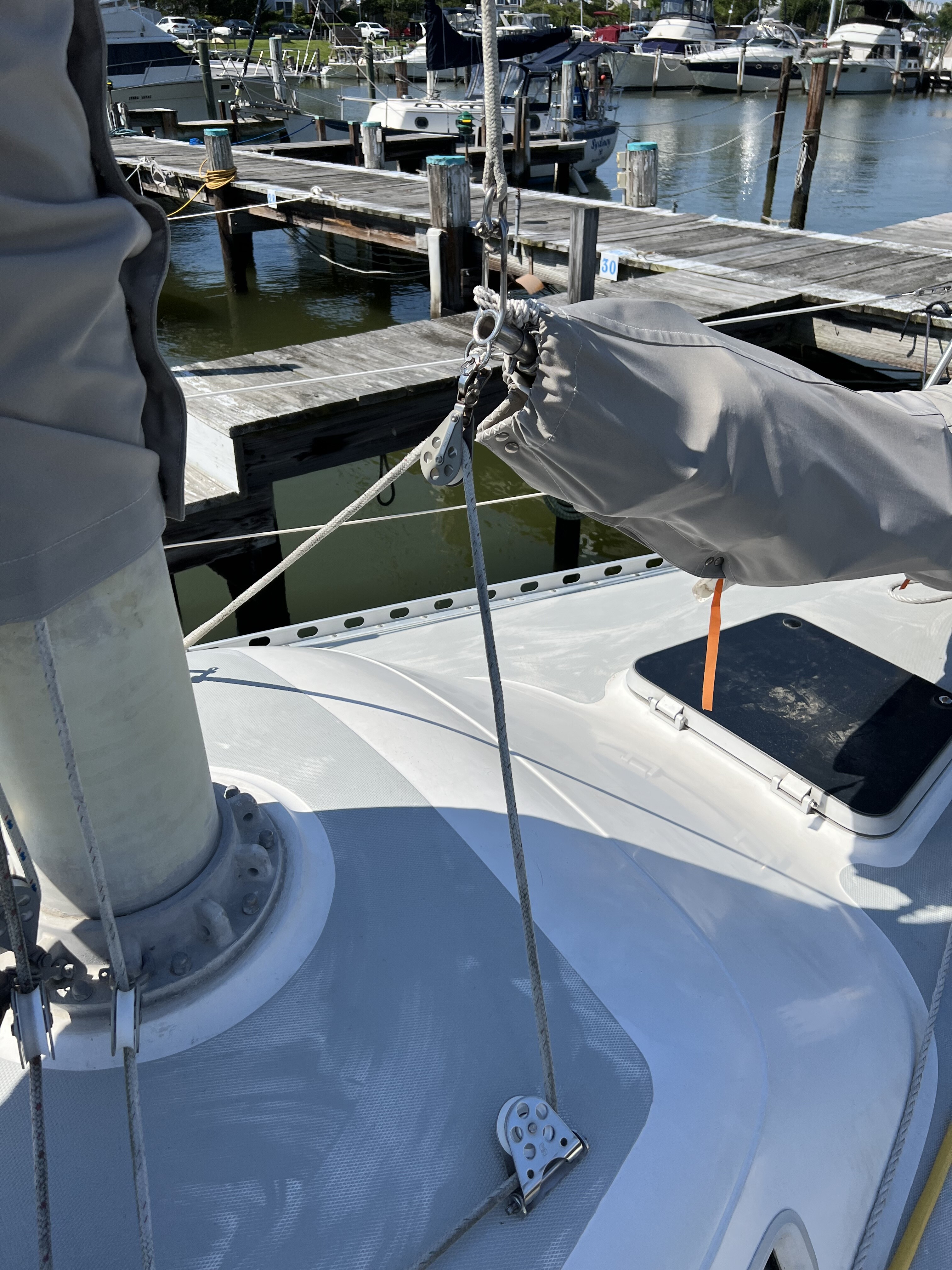

Lots of good ideas here. Here’s a shot of my setup after the sail is flaked and covered.

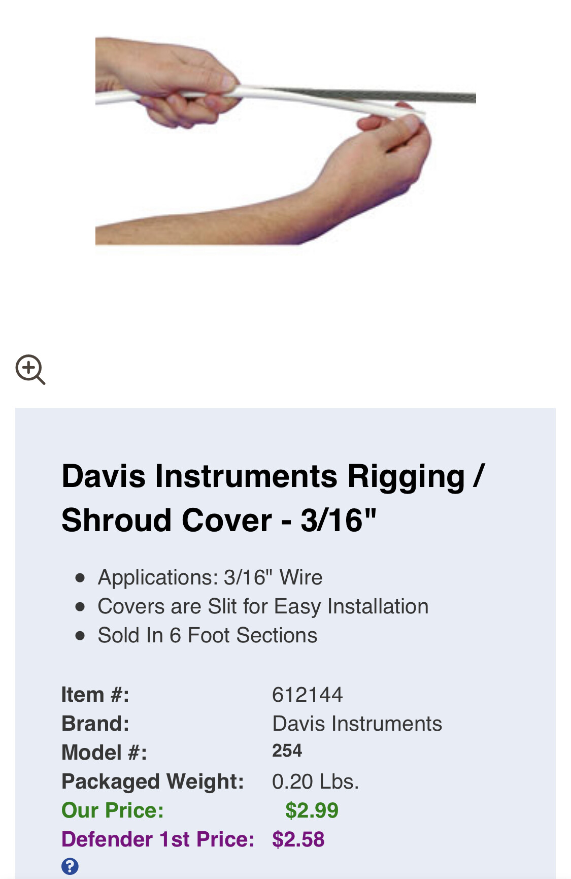

It occurs to me that a simple chafe protector commonly used of shrouds (on non-Freedoms of course :sunglasses:) might be a simple solution for the headstay issue.
Had my jib raised at the dock today to install a piece of chafe protector on the forestay and manually pushed the jib between port and starboard tacks. It was pretty easy to see why the sheet block should be attached to the extended eye facing down, as it gave the sheet block just enough leverage to rotate the camber spar over to the new tack. Once powered up on the new tack, the “lever arm” was at about a 45 degree angle and the camber was in the correct position. The topping lift is attached to the short section on top and becomes more useful off the wind and in lighter air but doesn’t really do much for the camber rotation.

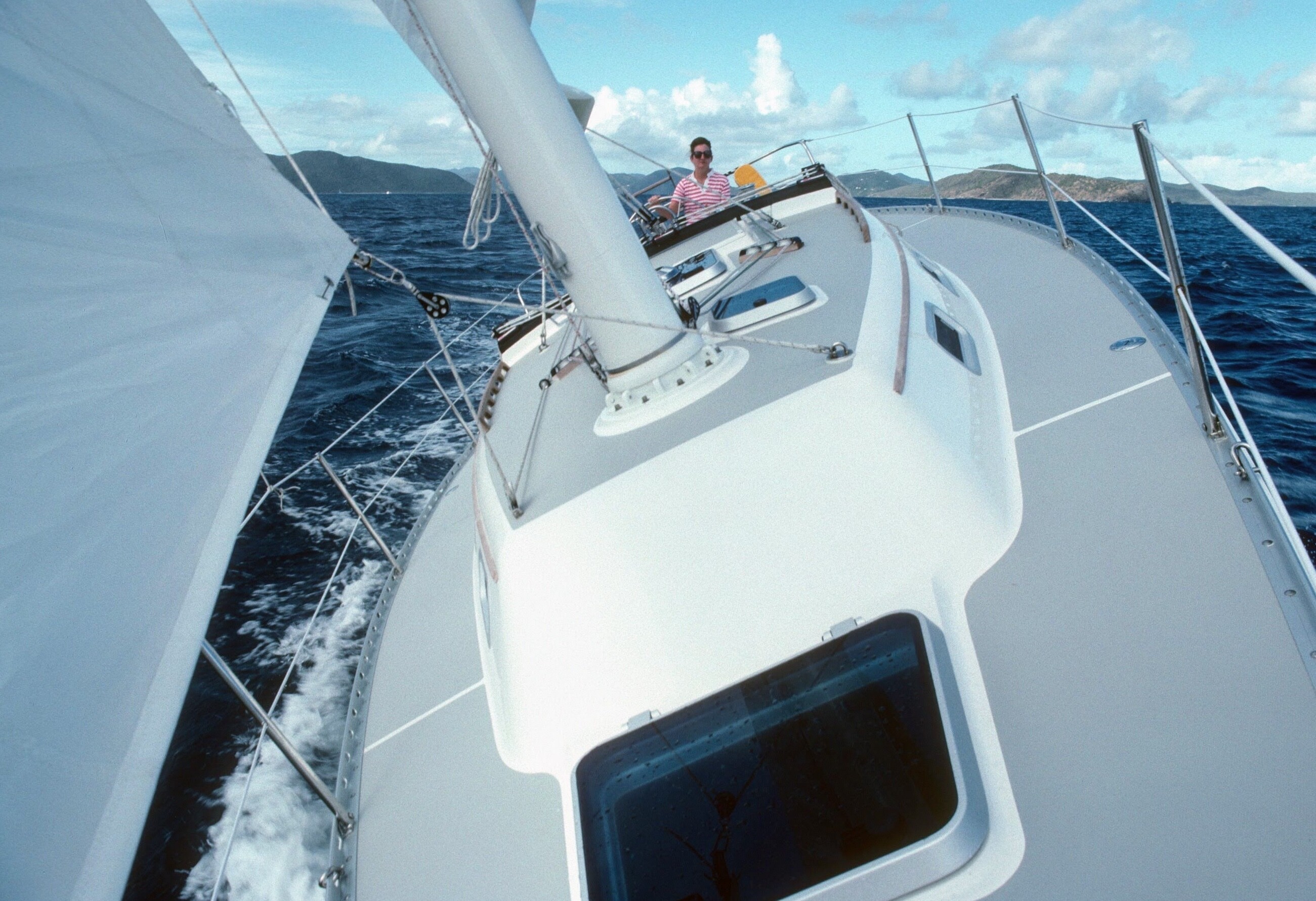

Out of curiosity, I looked at some photos I had taken while chartering an F30 in the BVI back when they were new. Sure enough, it was rigged with the long arm down and to the sheet block!
What the heck? Sunnyislemark, it looks like you have it rigged differently in the two pics you posted, the BVI pic has it one way and the previous pic post has it the other. Am I channeling you or are you channeling me? hahahaha. But I think we all agree the BVI pic has it right.
