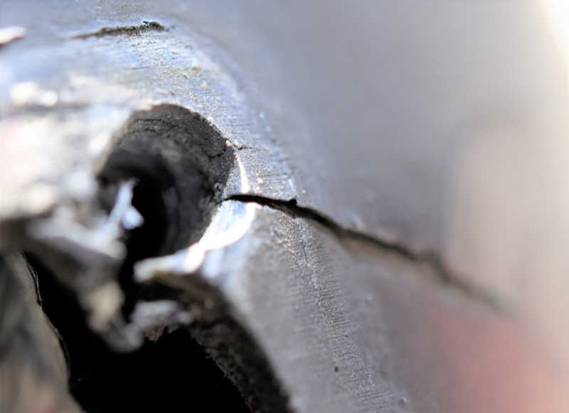

We at BAADS in San Francisco got a Freedom 21 donated. We subsequently found deep cracks in the mast at the holes where the halyards enter the mast, looks like the cracking occurs along the drilled holes at the top of the fittings, both sides. Fix advice is all over the map, from a $7K total sleeve to just a carbon fiber and epoxy patch. Have read Sponberg’s document. We’re looking for advice from anyone who’s seen this issue and has made an affordable and safe fix. Do these look fatal if un-repaired? Will mast eventually snap under load? Is a simple patch adequate? Thanks for your help!

Thanks Goose13. The boat is at South Beach Marina at the SBYC/BAADS dinghy dock, across from the guest slips, and is right under the hoist. I can meet you the 25th. We will need my gate key to access the dinghy dock. I’m heading up to Reno the 26th in the morning for a couple of weeks. Did you see the photos in the PDF? These are the cracks that concerned us and the carbon fiber expert at Spaulding Marine the most. Others say not a big deal to grind out and patch. Lots of small compression cracks appear all the way up our mast and may just be cosmetic gel coat cracks. There is another F21 just up the dock from us, she has the same compression cracks all the way up. -Eric Roberts, BAADS

One more close-up of our starboard side mast crack. Seems to penetrate at least half way through the laminate layers. Port side crack is longer, thinner, but when you stick a finger in the halyard hole and feel the inside of the mast, you can feel that it goes all the way through.
