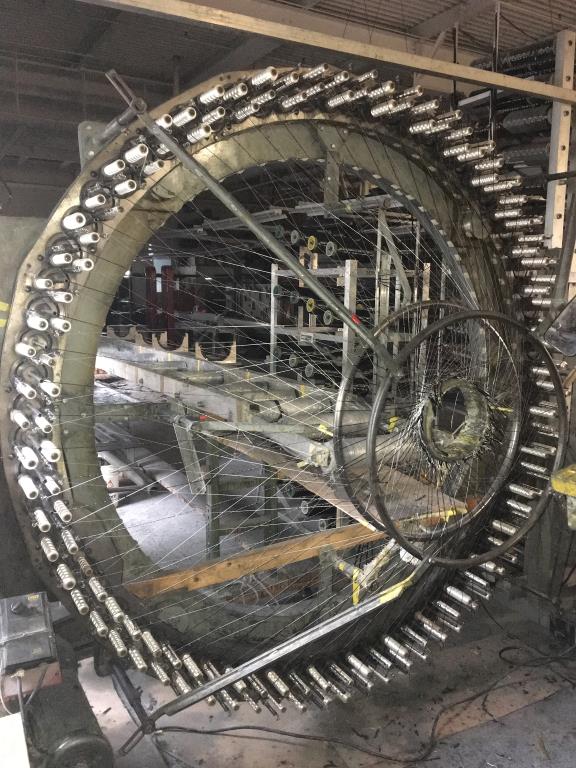

Today I went to North East Rigging in Concord, MA to pick up a new fore-stay for BlueJacket. They’re located in this old industrial building which used to make IBM punch-cards. Along with the rigger was a company named Composite Engineering which among other things, makes parts out of carbon fiber. This picture is part device which spins the carbon fiber onto a mandrel which then goes into a massive oven. They had some huge tubes and masts in there. Very cool!
So, if there’s anyone out there who might need a carbon fiber mast, boom, whatever, I suspect that they could make it for you.
