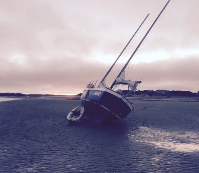

I have done it many times. The key is to pickup a quiet bay with no wakes and with shallow banks. It’s good to anchor in a deep spot of the bay and observe a low tide and exposed bottom. Pick the stop, relocate the boat into the spot on high tide, make sure it tilts toward higher ground on ongoing tide. Here is a pic from one of Cape Cod tributaries.

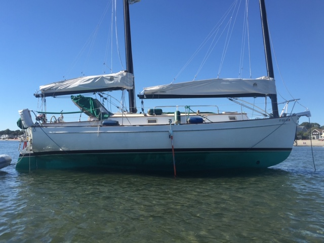

I made a pair of boat legs to dry out my F33CK with fixed keel. Tried them only once, learned I have to make some modifications to my setup.
