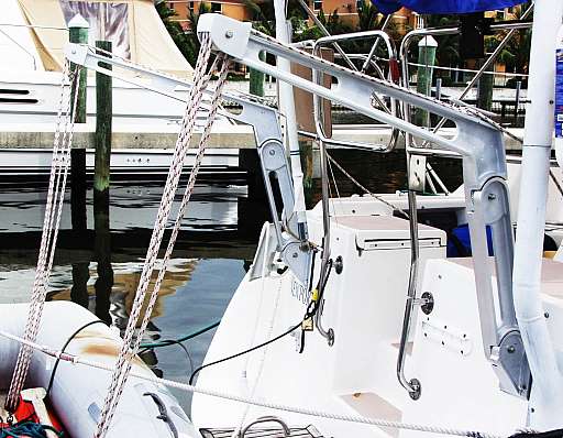

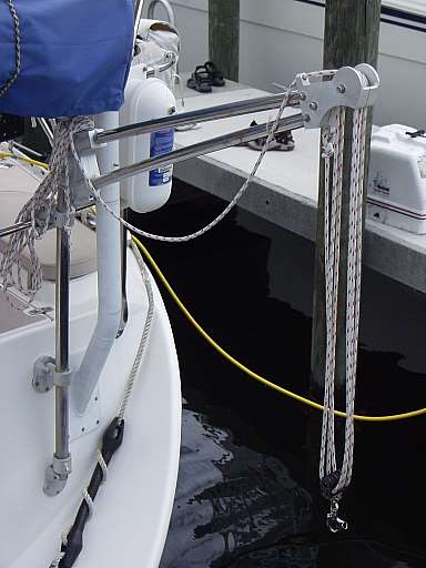

I’ve had great success with Atkins and Hoyle davits. One of the keys to success was building a sturdy lifting cable and bracing the dinghy side to side so that it can’t move.
Whatever you do, go much larger than you expect as the forces which get generated in large seas. The A&H model at the bottom was insufficient and needed to be replaced.

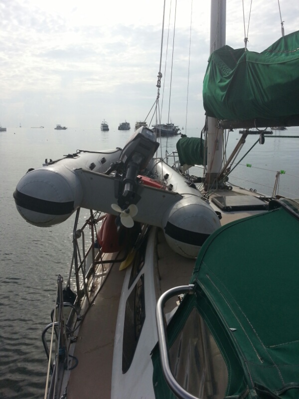

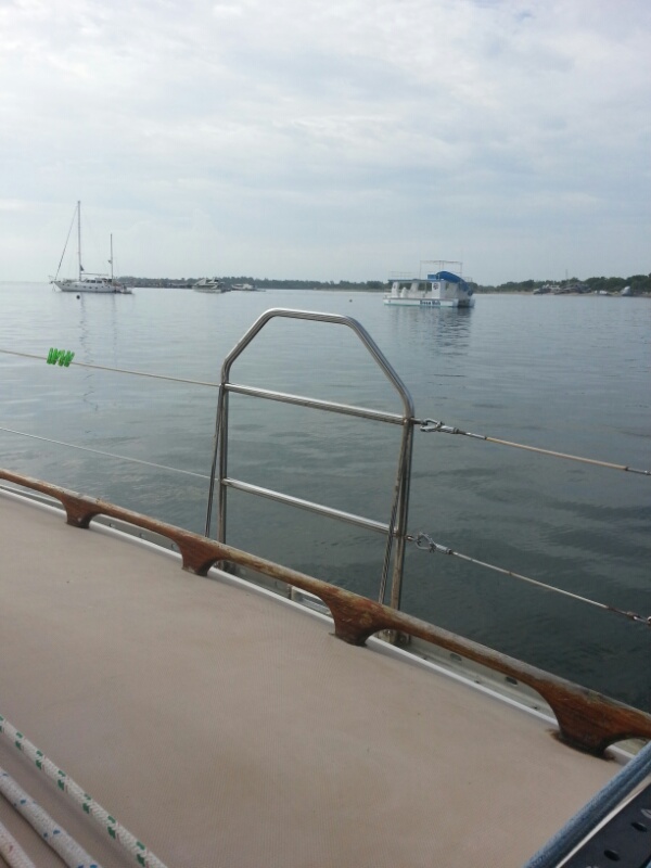

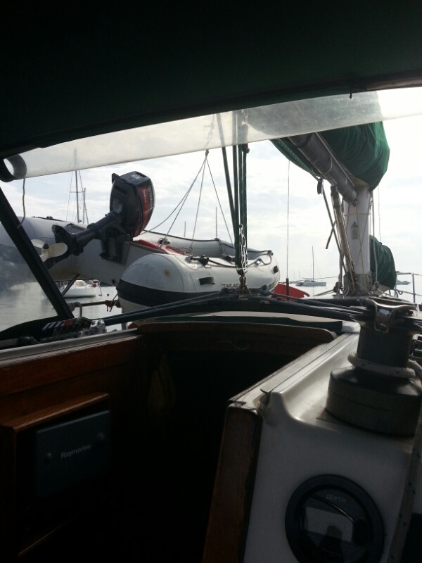

Hi, now I’m not suggesting this is a perfect way to carry a tender but in most conditions im comfortable with it. Im yet to find a perfect way on a 33foot freedom. Davits like Geoffs are usually the best option in my opinion but I have a hydrovane on the back and also a lot of other weight back there and dont want to add more on my small boat that pretends she’s a big boat! I generally take the outboard of.The dinghy is very securily tired to toe rail then across the top to handrail, it really cant move.Also I have stanchion handrails ( photo 3 ) on Freeform that make this possible. On long passages when I’m unable to guarantee weather I will let dinghy down. I used to carry it upside down between mast and dodger but I like how it obstucts my view. My current way also allows me to put her in the water quickly if need be. Unless the weather was very nasty I feel she is secured quite well.

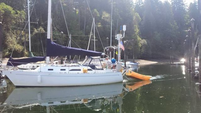

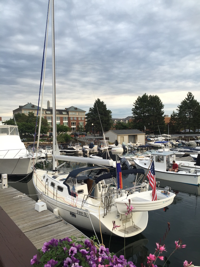

I use a DinghyTow on my '97 Freedom 35. I run overnight from Massachusetts up to Penobscot Bay, Maine. It behaves beautifully. In quartering seas, the dinghy behaves like it were part of the boat. Absolutely no problems. My only complaint is that I have to listen to the sound of the water rushing around the bow of dinghy that is in the water. Well, one more issue. Don’t forget when you are at a dock, that you are now 10 feet longer and it is behind you!

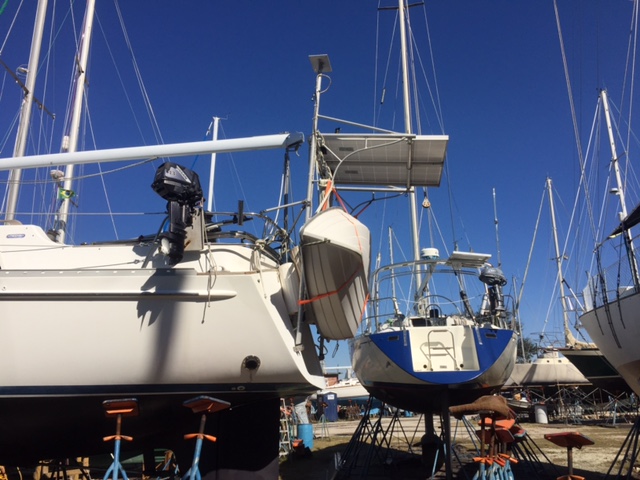

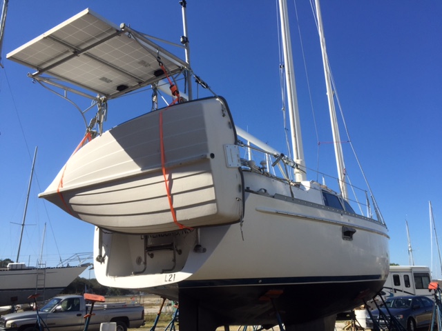

We are in the process of moving the motor mount location. We use larger straps sailing. We used this configuration last year from Nova Scotia to Florida and it worked out fine. We tow it like the dinghy tow shown off the davits on short halls or in the ICW. The davits hold the radar dome, wind gen and solar.

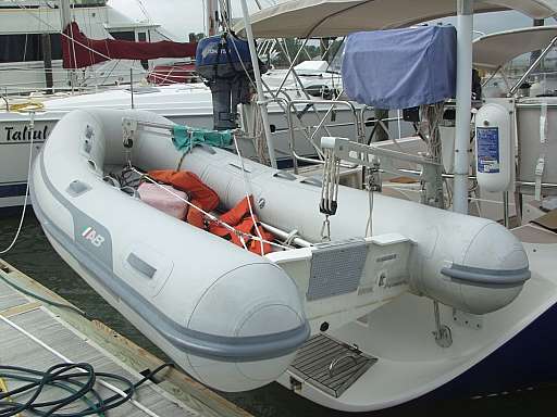

I’ll just remind people that there’s a huge difference between sailing the boat in relatively benign conditions and when the spray is hitting the fan. Then the fixtures that you thought were sufficient start bending and twisting all over the place. If you look at the picture of the davits labeled “These were insufficient” in my post above, you can see that they have a bend in them. They’re Atkins & Hoyle model 1200 davits which are rated for 200 lbs for the pair & the dinghy which I was carrying weighed 123 lbs.

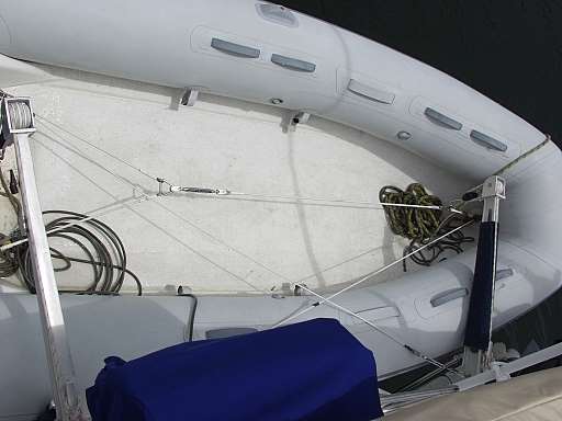

I then went to their model 2000 davits, which are rated at 350 lbs for the pair and added a brace to help absorb the shock load when you’re pounding. You’ll also note the cross bracing cables with turn buckles which hold the dinghy firmly in position to keep it from moving side to side.
Don’t underestimate the forces that get applied to the dingy in rough conditions. If you can guarantee the conditions that you’ll be moving in, then light weight options may work for you. I know that I can’t do that.
