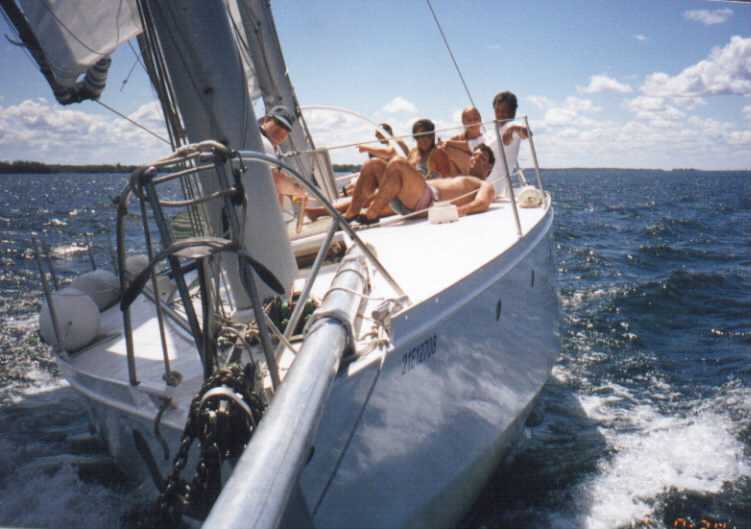

Phil,
Here are photos of bowsprits on catketches. The first is F44 ‘Frog Kiss’ with a small blade jib, the next are of a Tanton 37 cat schooner with huge staysails. Keep us posted of how you intend to mount the sprit, I’m very interested to go this route too.
its the tanton that gave me the idea , lovely pics thanks a lot if anyone wants a carbon pole i have access to 2 that would do 28s for less than a grand each

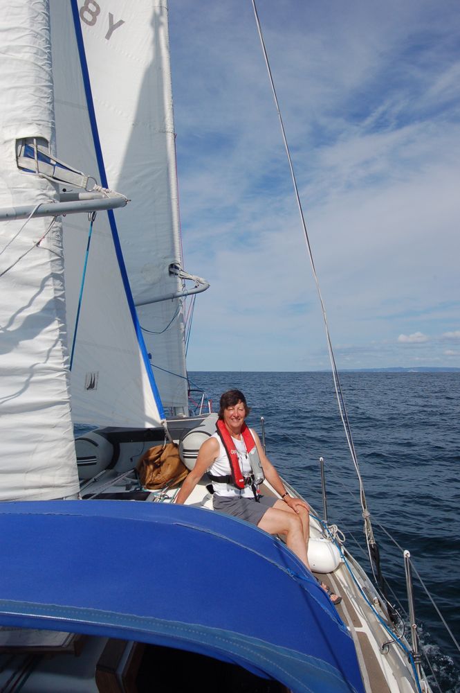

Hi Numbknots,
If memory serves me well, the former owner of F44 Frog Kiss, the one with the short bowsprit and jib, said he made 1 knot more speed and could point 1.5 degrees higher.
Our blade staysail certainly gives us better windward performance, despite the baggy state of our mizzen: it’s just too much effort to set it when we are short tacking, and we try to avoid long windward journeys. At least with a bowsprit, one wouldn’t have to hand the sail for every tack.
