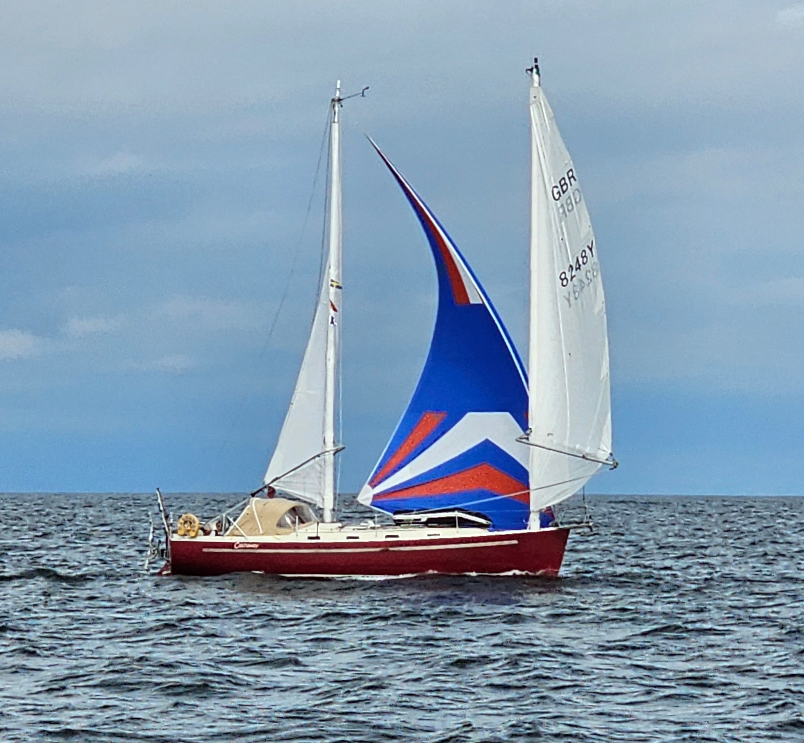

Yes, yes, yes and yes, to each of your questions. Make sure you have long enough sheets, and, if the winds are light or flukey, rig preventers. You can take a preventer to the tip of the bowsprit for the main, and the toerail amidships for the mizzen. Gybing is not so much dangerous as annoying, especially if you are carrying a staysail, as here.
With the main well forward, you get drive as aerodynamic lift, rather than just wind pressure on the back of the sail, and having a decent sail area on each side of the boat gives balance the helm.
We were doing 7 – 7.5 knots in the picture above, crossing the Sea of Åland.

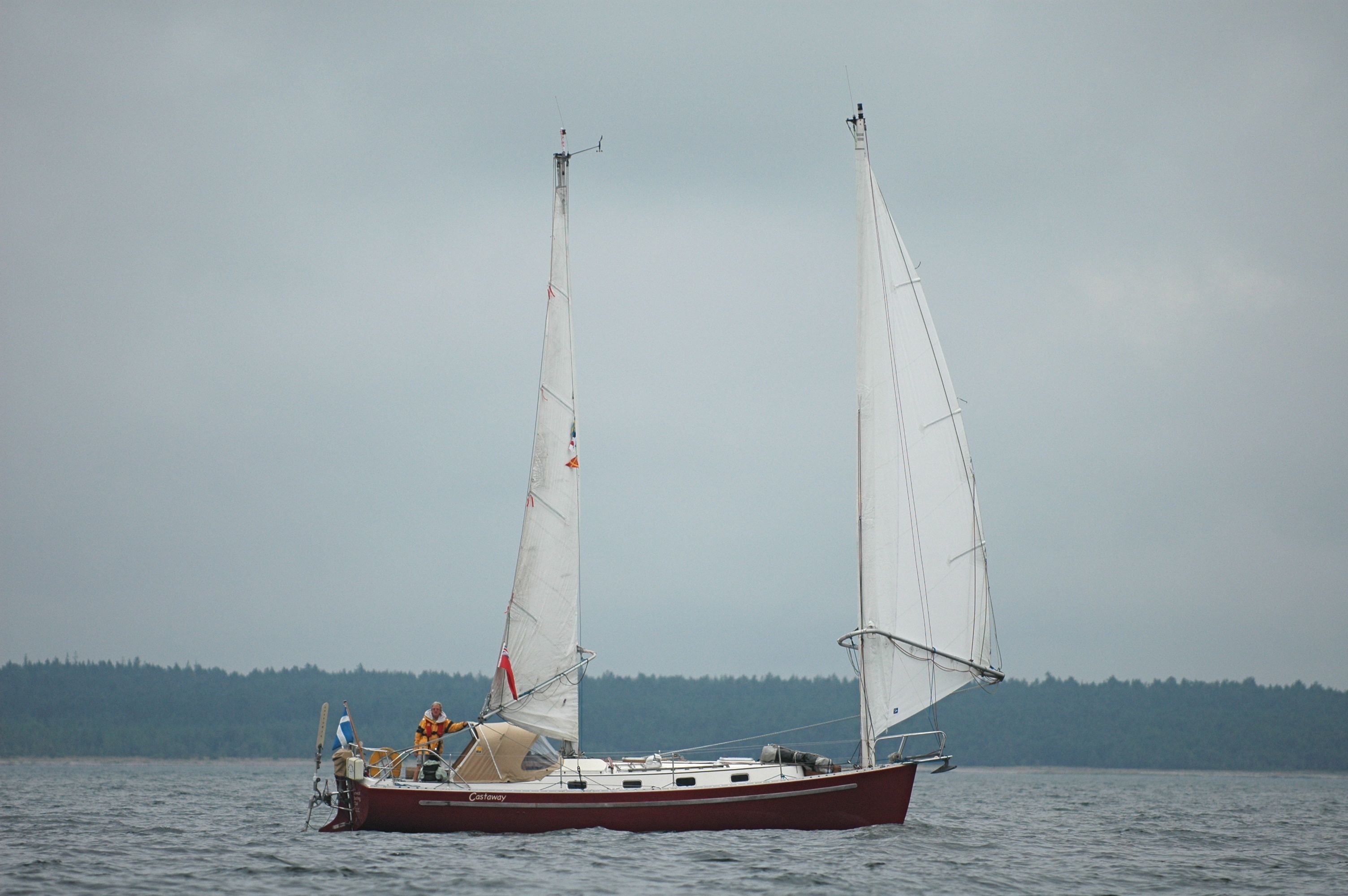

The thread “Mizzen staysail on a cat ketch” has some more pictures, and there’s another one below, off the coast of Gotland.
