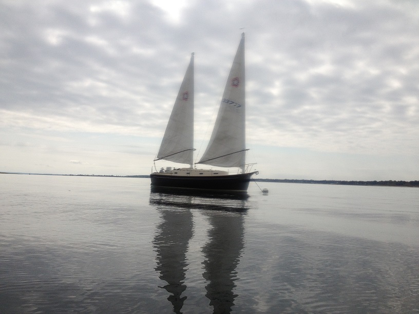

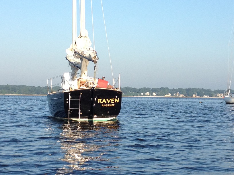

Thank you for your post. You said you sailed across the Atlantic on a 28’ CK. I would love to hear more about that crossing. I spent the last 3 years restoring Raven a 1980 F28CK (Hull #13). Raven is equipped the wishbone booms and wrap around sails (not original, unsure of age?). My wife Terry & I are new to sailing. We (mostly me) learned to sail a Dyer 7-11" dinghy over the 3 seasons it to to restore Raven so the Dyer is all I have to compare Raven too. Raven is so easy to sail; we laugh when we say “ready about” as there is nothing to do (no sheets to switch). We have been sailing Raven since June 2013 and have sailed over 60 times her on Narragansett Bay, RI. Wanting to test the boat and my skills on a windy day; I went out with 2 experienced sailors on a day when the winds were 25K gusting to 33Knots. Nothing broke, we had the toe rail in the water a couple of times. While not a rocket ship we say speeds mostly above 5.5Kn with a high o 8,1Kn (surfing?) that day. Both the sailors had ear to ear grins all day at the way Raven handled. Reading the forum post herein I think that most who have switched are happy they did. At least a couple regretted the decision as they found a loss of performance. I decided to sail with the WB until I need new sails (maybe 2 more years). Just to set a budget I had Steve Thurston give me a quote for replacements. It was $8,000 for both; this might be why most boats have been converted. I don’t think I will switch, but I would love to hear from anyone who has with what the cost were. Attached are a couple of pics of Raven.

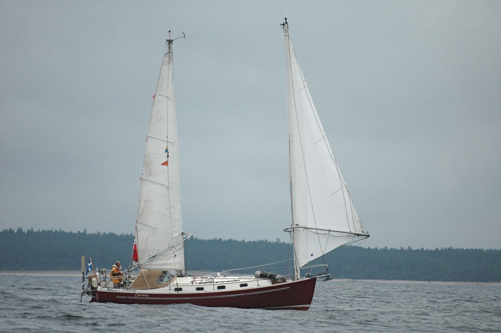

I hope this picture shows what can be done with carrying the Main by the lee. This was our first new main with a sleeve, which has since been re-cut to replace the two ply main shown here, and we have a newer and better (and larger) main now.
The photo was by a Finn sailing an Albin Ballad, which we overhauled effortlessly on a reach; different story over the last mile, to windward, and he got the best berth!
