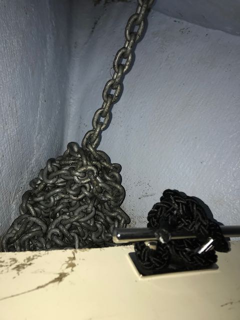

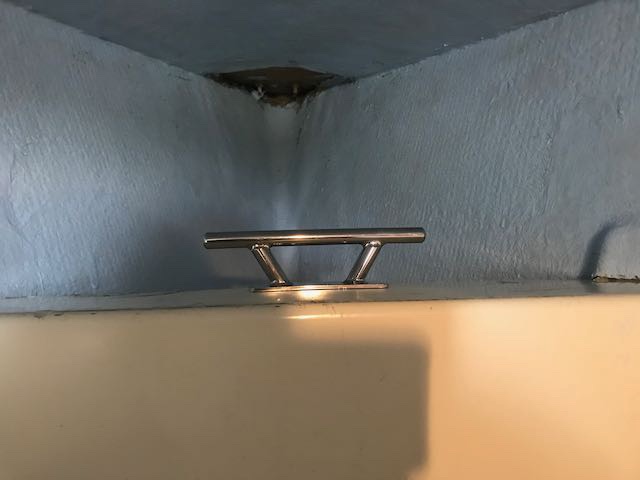

First I fitted a cleat on top of the chain locker for the bitter end.

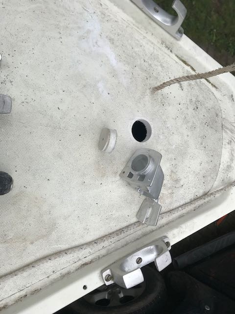

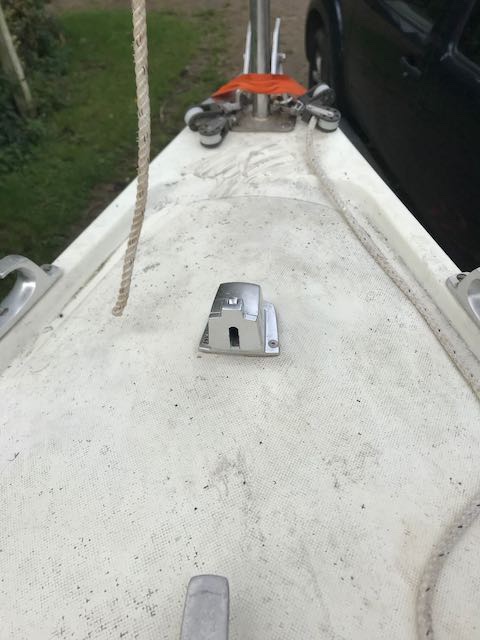

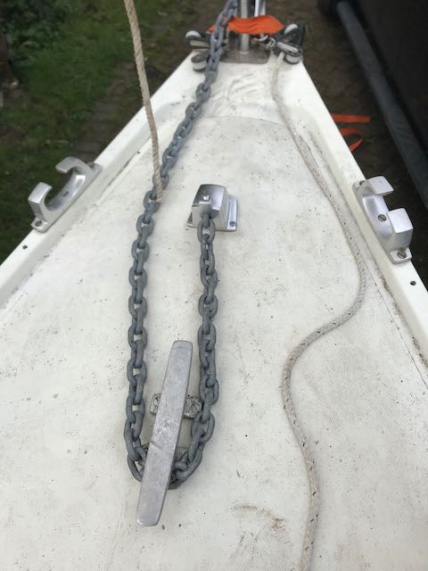

Then drilled through the deck, which has a pronounced curve. Decided to place it here rather than just behind the stantion, where it is flat, as the rope will flake better if the pipe is centralised.
I had to fettle the hole and pipe a little to get a firm fit, then bedded it down with some marine silicone and bolted through the deck.
Both rope and chain drop under their own weight and flake nicely into the locker below. Now I have to wait for the new anchor to see how I can fix it.

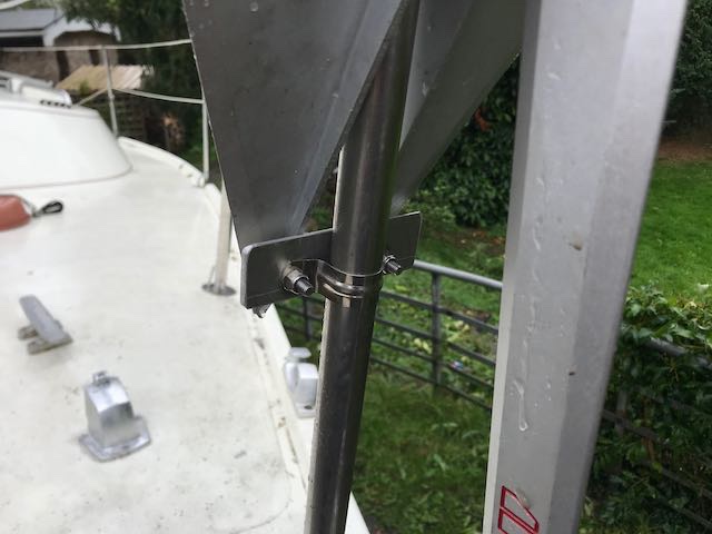

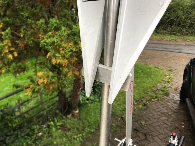

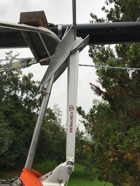

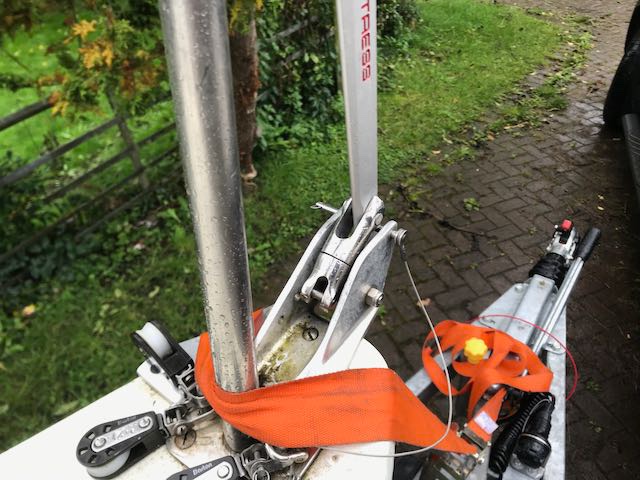

The fortress anchor has arrived and I had some time today to assemble it and figure out how to mount it on the pulpit. Have been looking online for stanchion anchor mounts but the only mounts I could find were “Bluewhale” and “Wind line”, both from the US and at around $80 with another $50 in shipping and import duties. After a little thinking I came up with a simple but effective bracket that I put together with odds and ends from my workshop: a stainless steel rail clamp, 2 M6 bolts and an offcut of 4mm aluminium plate. I just place the flukes over the mount with the mud palms hard against the pulpit and then pin the shank to the bow roller… total cost £/$0!
The only reservation I have is whether the stock will interfere with the deployment and retrieval of the spinnaker. If so I’ll just lower the clamp and drill a hole further up the shank, although that may void the lifetime warranty.
Is there a way to get more than 3 pics in a post? Here is the fourth.

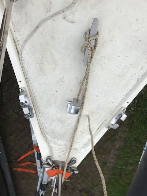

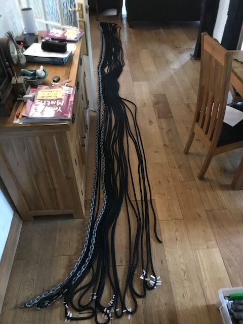

Today I marked off the rode in 10m lengths with coded strips of sailcloth poked through the plait.
I then hauled it all onto Rockin and was and pleasantly surprised how easily it all flaked into the locker. I did check and compact the pile after the first 50m but the 10m of chain compressed the last 50m of rope nicely. So I now have 110m of rode stowed away in my chain locker. I’m well pleased with the result.
