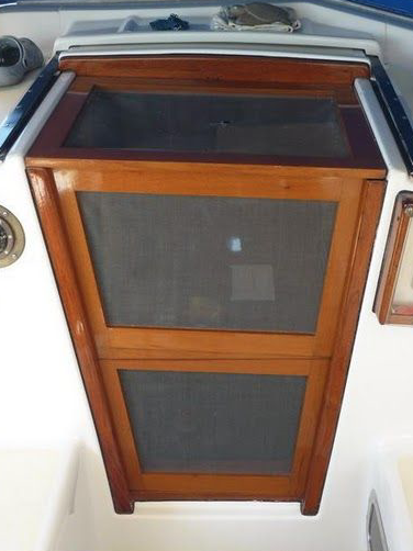

Has anyone attempted making wooden companionway screens? I saw this (not for a Freedom) and I’m thinking about giving it a try for our '82 Freedom 33.
I just had screens that look exactly like the prior post made for BlueJacket and they work great.
I had screens similar to the ones shown in the picture. They were made from 1/4" plywood, cut out for the screens and the screens epoxied into place. I often used the screens in place of the hatch boards with the boat on her mooring for good ventilation.

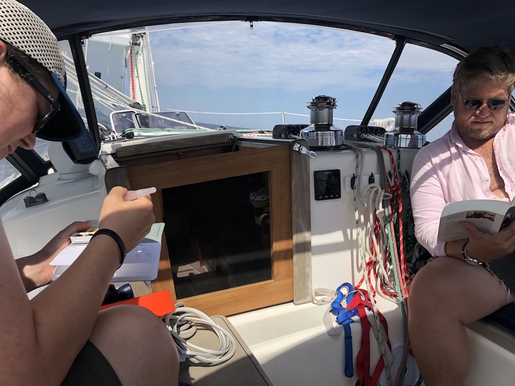

The previous owner of my F38 made this, but never finished it. They gave it to me as an empty teak frame with a piece of screen and some of that rubber gasket stuff that fits into a channel around the edge and tensions the screen as it’s pressed down. It was really simple to finish and it works pretty well. I still haven’t figured out a good place to store it when not in use.
