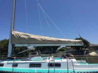

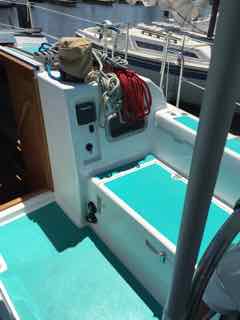

Deck gel-coat repair is completed :slight_smile: All the non-skid was done too - yes in THAT color :slight_smile: - smooth looks great. Instruments all work fine - i70S shown (3-in-1), Ray 70 VHF remote shown with mic clip. Still need to re-install dodger, and am now installing mack pack and mack mainsail -…

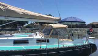

one more of the Mack Pack and New Main – dodger to be added still :slight_smile: Updated today - dodger added - pic shows frame and canvas on with no snaps yet - today I drilled all the snaps - project completed except calibrating instruments. - almost 6 months :frowning:
