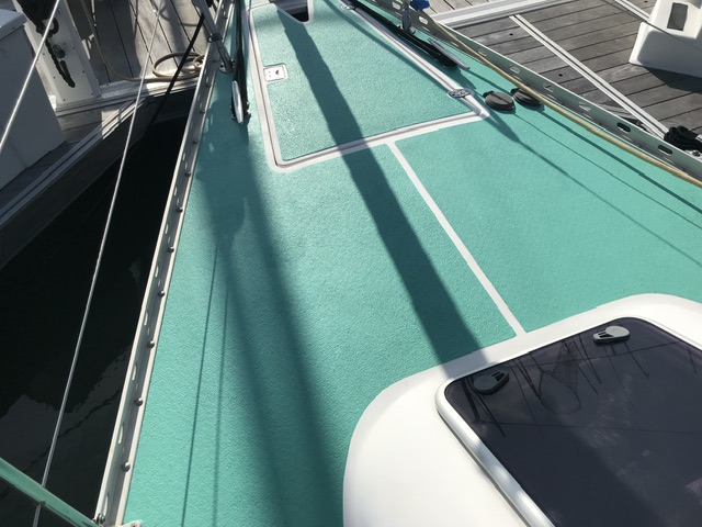

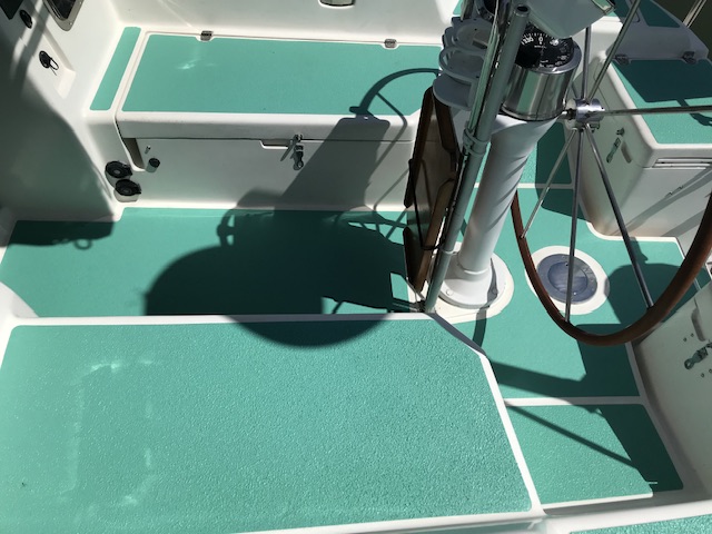

I’m Re-applying non skid to the deck with the boat in the water - using kiwi grip in sea foam green as before. I’ve completed 17 sections with 10 to go. So far so good. A couple sections came out too aggressive in non skid so afterwards I’ll lightly sand off the peaks and re-apply a thin coat. So far it’s been a single hand operation. I’ll see how long that’ll last!

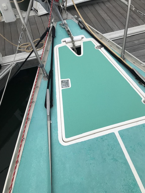

Anchor locker hatch completed shown with “old” original next to it….cockpit all new

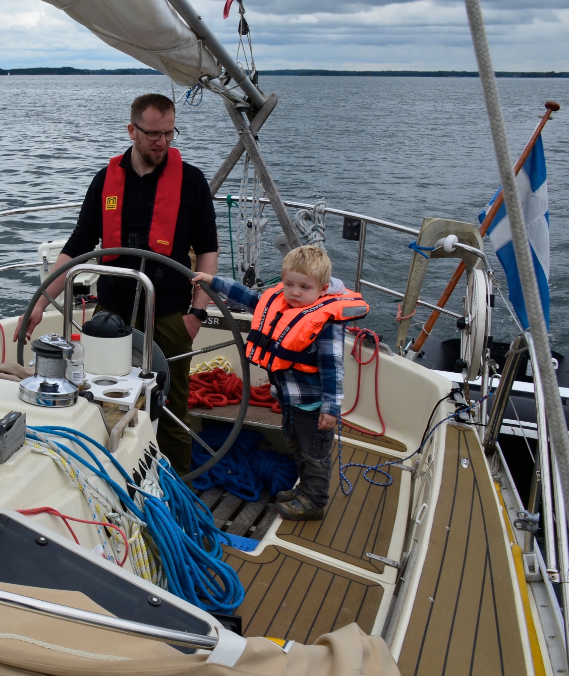

I did the ‘sand in paint’ thing on another boat; it was very effective, and very durable. One problem did arise, having applied it to the cockpit seats, in that it caused a lot of wear on my trousers, especially the waterproof ones. Proper fitted cushions would have been a good idea. I have TekDek, a synthetic plastic which has the look and texture of teak strips, throughout the cockpit area, and Treadmaster on the deck. So far, the TekDek is wearing well, looking good, and gives secure footing. I had shaped panels made up, and they are glued in place with a special adhesive, but it was easy for us to do it all ourselves.

Have 6 sections left - will hopefully do 2 tomorrow and then must wait a couple weeks Definitely a technique is involved to get the right texture - again a couple of sections were way too aggressive. When I’m done I’ll sand those tips off (no tapping off required) and lightly apply a top coat. I’m using a paint brush in one hand to spread the kiwi grip and then lightly roll it out with a 4” roller in the other hand and immediately pull the tape. Easy water clean up. I’m happy but miss sailing! And I missed the Delta Ditch Run race this year due to this… :smiling_imp:

I got the panels made up by the firm, who cut the material to form the edging – it comes in strips which are glued together – rounding over and mitreing the strip, so that what I got back was a single piece for each panel, and then I glued it in place.
The panels were made to the shape of templates I supplied, basically copies of the old Treadmaster non-slip which had been there before. If ever you should try this, make sure you do a template for each individual piece, and mark which way up it goes, since the two sides are not exactly symmetrical, at least on the UK mould used for the deck/coachroof on the Isle of Man!
I expect that your non-slip will last very well, so the problem should not arise! One nice thing about the TekDek is that, if it is scuffed or has superficial damage, it can be instantly remedied by sanding with coarse (80 grit) sandpaper. It’s also very oil resistant, unlike teak!
