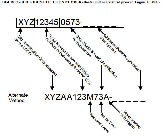

Does that make this boat a 1982 or a 1983 model year?
Attached is excerpted from ABYC T-10; the M82K indicates a 1982 model year, molded in June of 1981.
