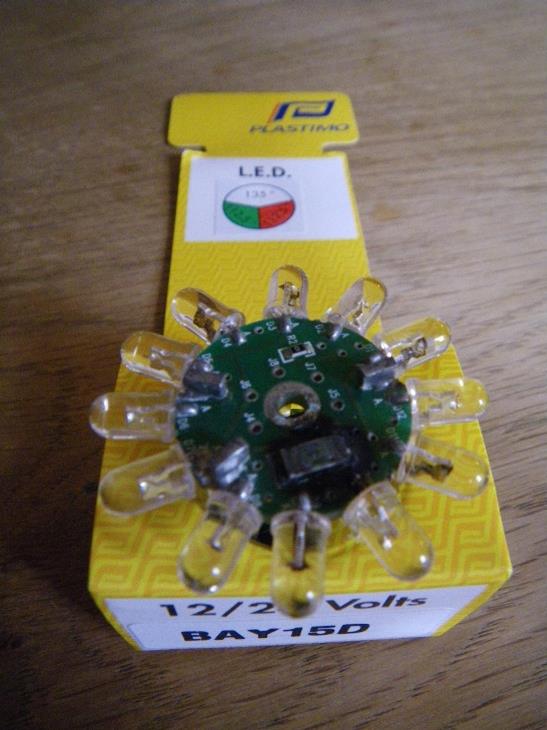

I bought two Plastimo BAY15D replacement LED lamps for my anchor light and tricolor. The one in the tricolor failed after an hour or so of testing in the marina. One of the regulator chips buned out. so much for the 50,000 hour burning duration.
I now know that these widely spread white LEDS are no good in nav lights, so I’m gonna return it.
