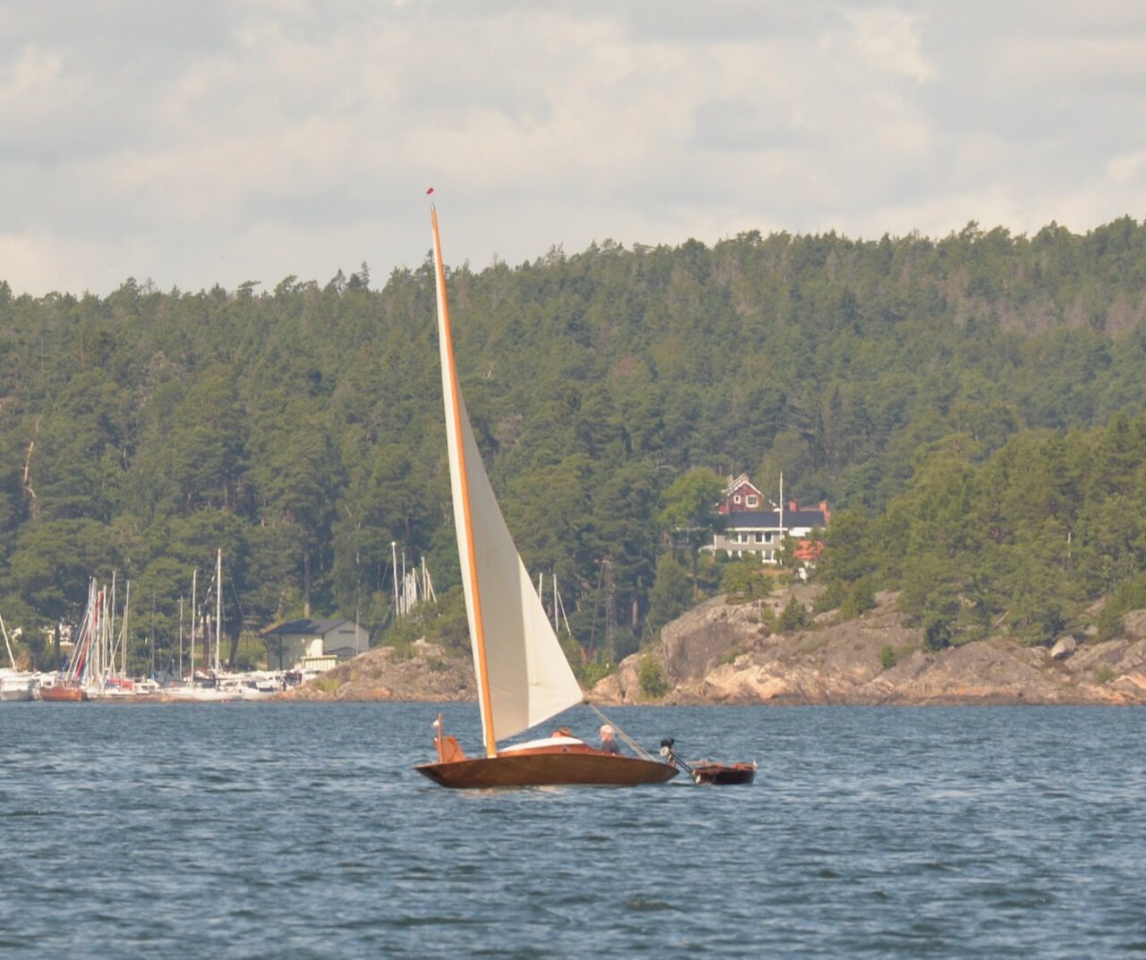

There was a very long, narrow, ‘Scandinavian’ boat with a rounded bow on the Clyde in the 1940s thru 1960s - Vingen, I think, but not the one shown on Wiki. She had an unstayed wooden mast which had bearings at deck and keelson levels with a big wheel in between. The rig was unfurled, reefed and put away by rotating the wheel with an endless rope lead to the helmsman. The leech was scalloped with (I think) three sheets from each side lead right aft (the pointy end on this boat). Most of the time the two sides lay together as on a proper Freedom, but when running they would open up, doubling the area.
Lovely boat. I could dig out a photo with a little effort.
Late joining this thread; alway a lot this year. I have a picture of an original Ljungstrom boat with the revolving mast; in this shot you only see the double ply sail set on one side.

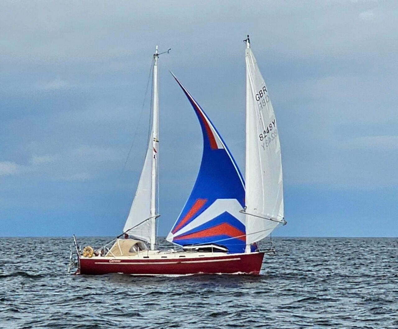

The other is our answer to a spinnaker; a try-radial mizzen staysail set flying from the toerail at the bow, from the top of the mizzen (back mast to you, Arran C), and sheeted to the end of the mizzen boom. A running backstay is necessary in all but the lightest airs, and preventers advised on both booms – we have them permanently available to clip on. Of course gybing is a major event since the staysail and backstay, plus preventers, must all be handed first! In the picture, we were making a 40nm crossing of the Sea of Åland, with a nice steady 15 knot breeze over the Starboard quarter. If dead downwind, we usually hand the mizzen to keep the staysail filled.
Gerald
