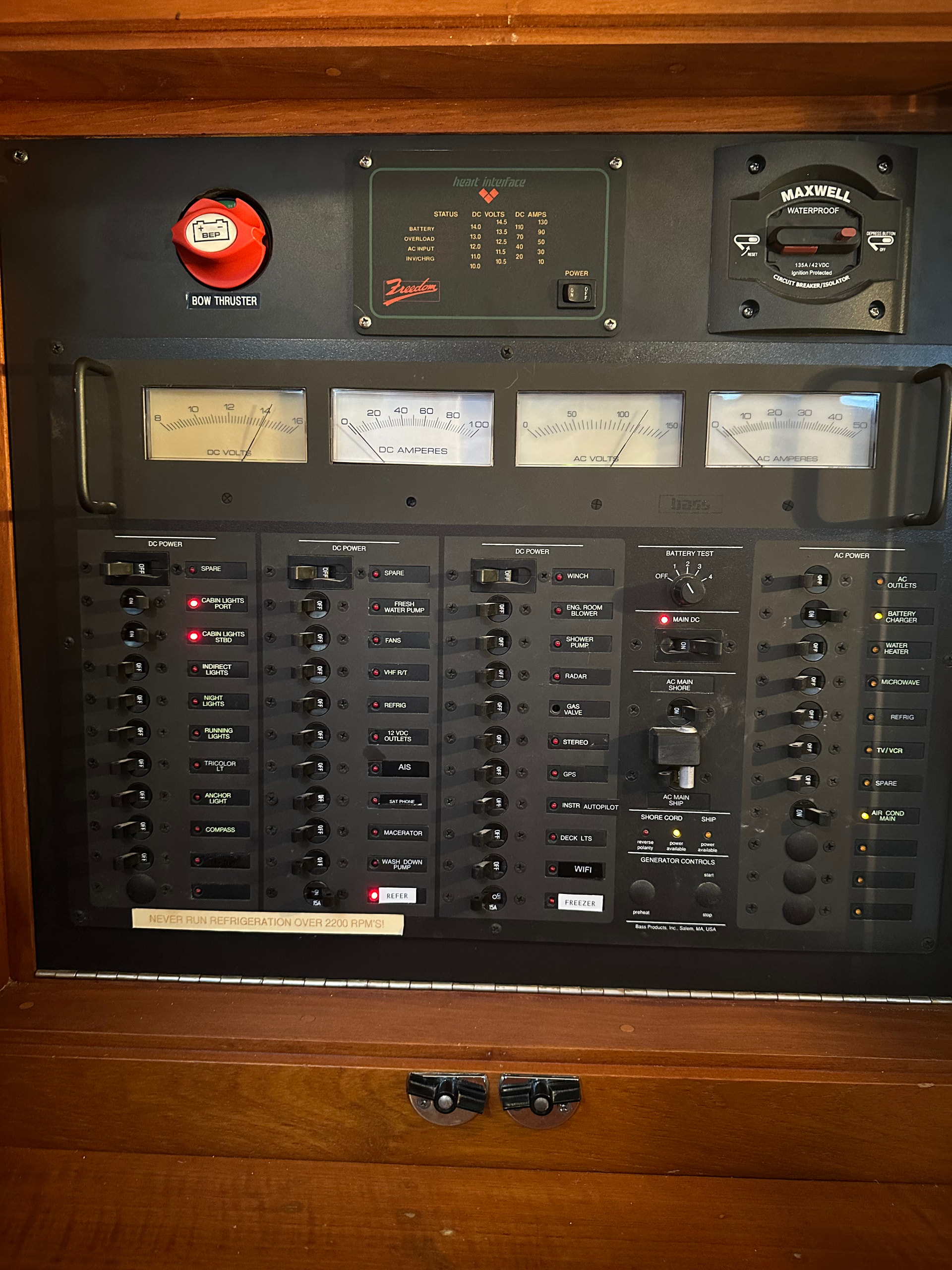

A question for the 40/40 and 35 owners. When my distribution panel is on, i have a 0.6 amp draw with all breakers turned off. I used an amp clamp all over trying to find where this trickle is coming from with no luck. Then it dawned upon me. Theres a few tiny indicator bulbs behind the panel that illuminate the lables of the breakers. I cant tell if they are LED or not, nor do i know what they draw individually. So my question is this - is this draw normal with those bulbs? I have solar on the boat, so im not concerned about my battery but i am concerned if this a parasidic drain from somewhere yet to be identified…

Aha. Well I bet your 35 had the same distribution panel made by Bass. Do you remember if it had back lighting?
I suppose i should go down to the boat and count the bulbs and do the research on what they draw.
If anyone else confirms this, I will consider this solved.
I’ll check draw on mine this weekend, there are 4 bulbs and not LED.
Could open panel mine has inline fuse holder feeding them open to see if draw goes away with lights off.

On BlueJacket, there was a switch for the back-lit lights (which are incandescent). What happens when you shut that off?
I dont believe i have a switch for that. They are always on when the DC panel has power

I am getting the 0.6 reading from my victron battery monitor/ shunt as well as the analog guage.
I’m getting .4 with everything off except backlight and only 3 working

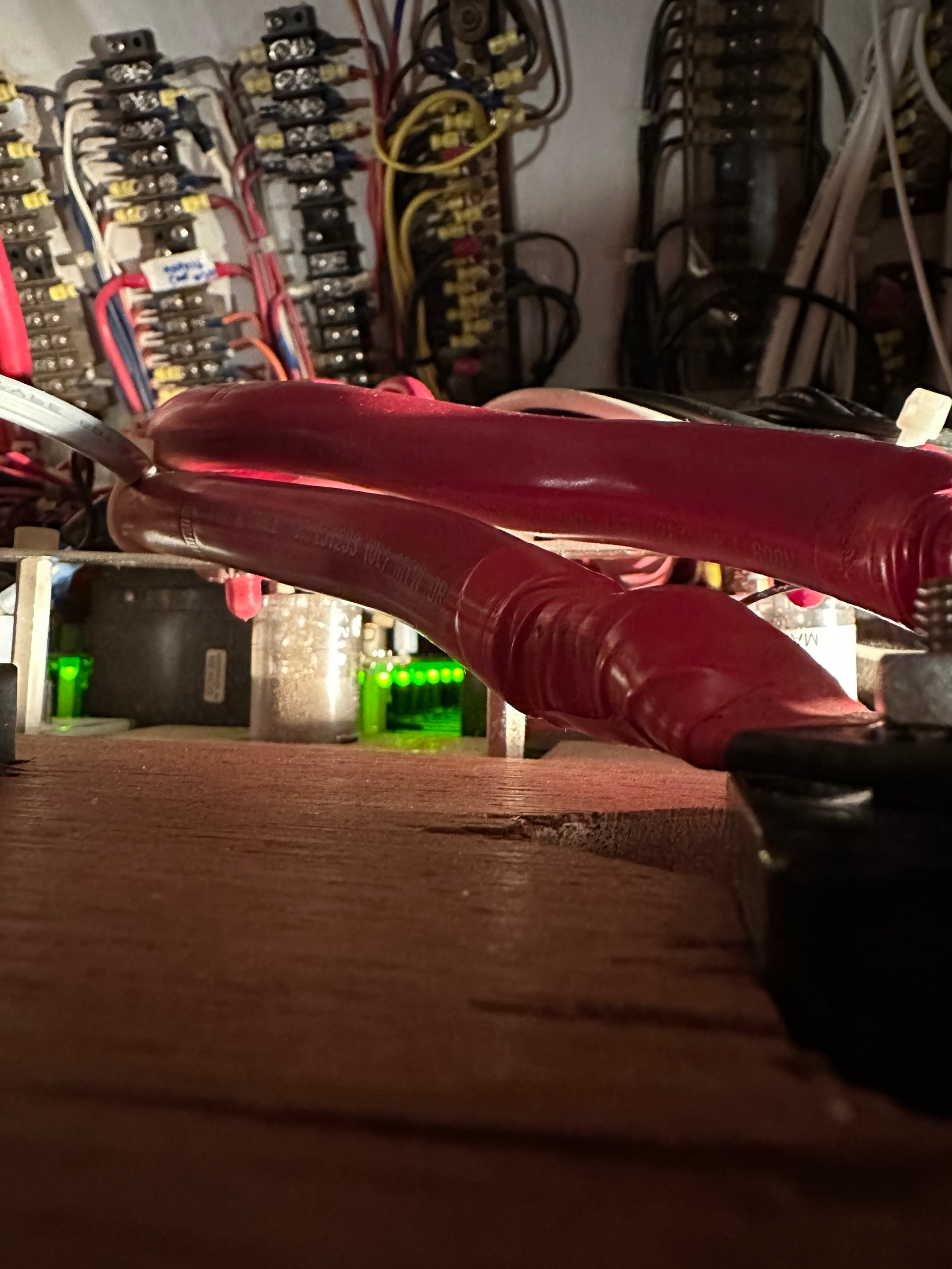

Since i started this thread I felt the need to go down to the boat and open up the panel. All those green lights are the panel indicator bulbs. There must be 45 of them. Since theres so many, I am going to assume that they must be LED.
