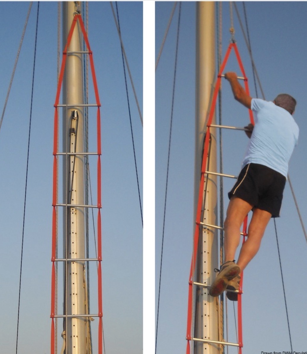

Heres another interesting option. I have looked at these many times

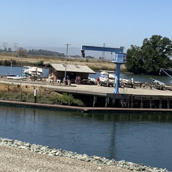

My thought was to find a marina with a seawall. We had one at the Stockton sailing club - see photo - which was outfitted with a crane for smaller boats. This provides a solid, flat space for a bucket truck. It would have to reach out beyond the dock finger below but that should not be a problem. Then you get someone with a bucket truck and share cost with colleagues who want to get to the masthead for various maintenance. Most everyone has something they would like to take a close look at up there.
