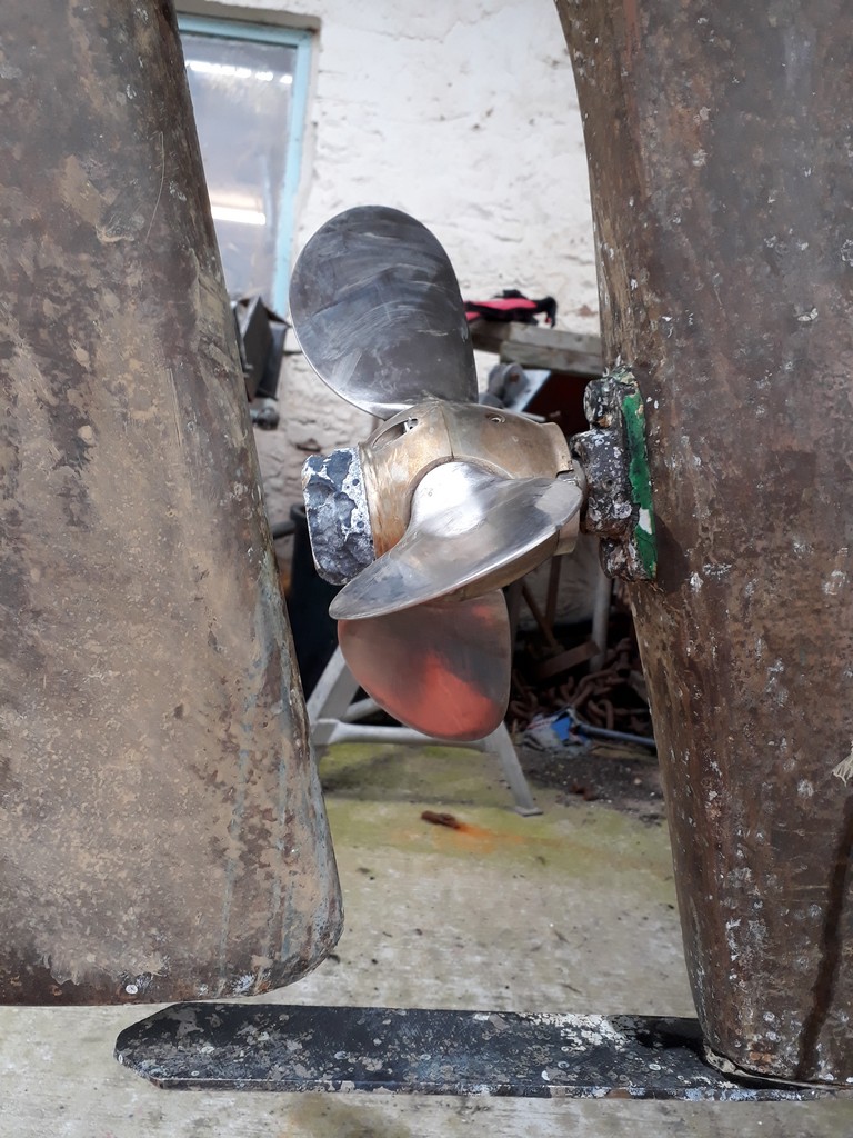

Thanks Gerald. I did at the beginning. Although Beta published guidelines recommended (at the time) a Kiwiprop as an option, I got in touch with Kiwi in the UK and they said it was not appropriate for my engine/gearbox combo; i.e. a Beta 16 HP with a TMC gearbox @ 2.1:1 ratio.
It’s a bit of a no-win situation with any variable pitch prop. I don’t have enough clearance between the end of the prop shaft and the rudder. And any folding prop is out of the question. Even if a Kiwi was appropriate, the length of pop hub would force me to cut a notch out of the leading edge of the rudder to fit. Same with a Darglow Featherstream. Maybe that’s what I’ll end up doing!
I was puzzled by the weight in the literature. Hard to sea how a boat with 1.5 tons of lead ballast and the high volume hull that the 28 CK has can weigh in at 3 tons.
The FeatherStream should fit without needing any modification. There’s two versions of the anode, pointed and flat. The flat one fits, but not the pointed one. Darglow would be able to recommend a prop for the engine you have, although they might observe that it’s a bit underpowered.

I recall including the Darglow as an option when I was researching prop/engine combinations, and the issue with the length of the prop hub, taking into account not only the distance between the hub and the rudder, but also the minimum clearance required between the prop an the keel. Will look at it again.

Here’s my FeatherStream with the flat anode. No modification to the rudder needed.

Many thanks Andy. This is very useful! Actually, I was looking at the prop this very afternoon (under the rain!) And taking measurements. Will get in touch with Darglow again and review options.

The only wrinkle is that you have to take the rudder off to change the prop - but not to change the anode! :wink:
