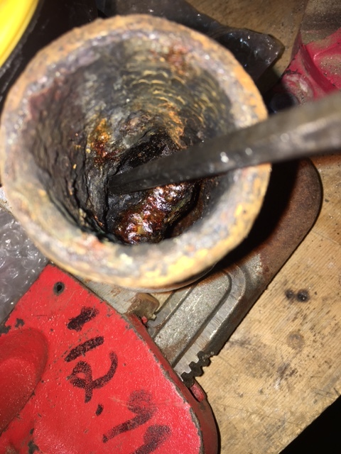

I replace my exhaust elbow on my 1986 Freedom 36 recently. Best I can tell it has never been replaced. I’ve had the boat since 2001. Frequently I would checked the elbow by feeling the top of the elbow to be sure it was cool to the touch but in the back of my mind I knew I should have replaced it just because. Well when I pulled it off I was surprised to see that the exhaust port was more than 95% blocked. In fact shinning a light from the inlet side it was barely visible on the outlet side A 1/4 inch rod would not fit through the largest opening. See picture below (I hope). To the right of the rod is the water passage. Water flow seemed normal. I was surprised engine even started. Must of had a lot of back pressure. Moral of the story just because you are able to pump water through exhaust doesn’t mean the exhaust elbow is good. Finally got to adjust valve clearance and replace the engine shut off cable. Engine sounds great. Maybe I’ll be able to water ski behind her now. :laughing: :laughing:
That’s a very interesting finding. I have always associated good water flow with a good elbow. Obviously an incorrect association. Thanks for the heads up.
