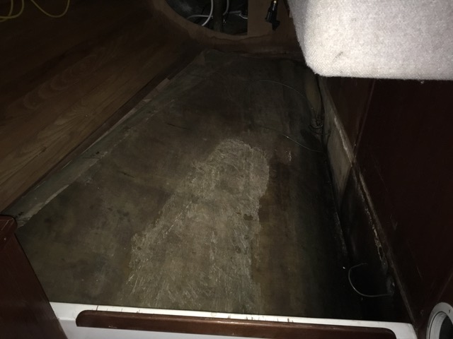

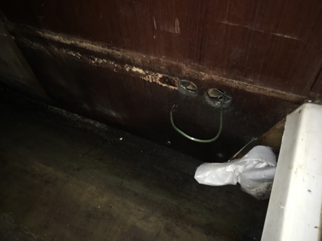

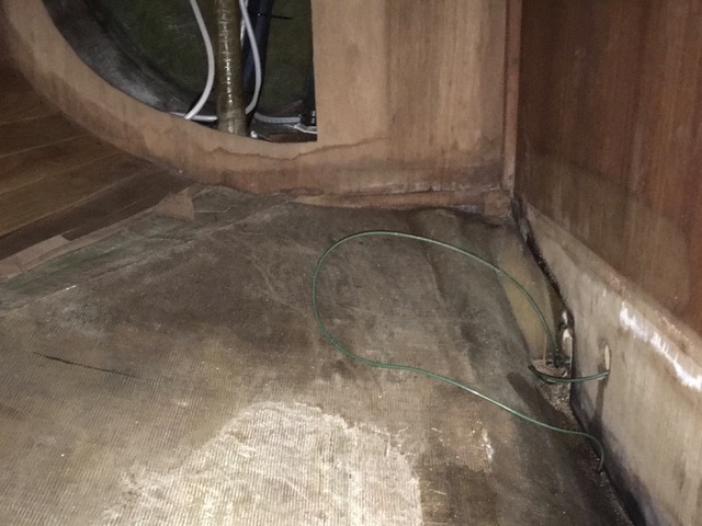

Here are pictures of the stripped out quarter berth. The water was invading the area through the radar mast, which had never been taped off when installed, so water was running down a couple of screw holes… Over the years, the damage was being done.

  1. when they replace the bulkhead around the quarter berth, they are going to fiberglass the base the stern board to protect the wood. Had also heard from another friend who had had a similar issue with rot in the stern quarter berth bulkhead; not from a radar mast leak, but somehow water was leaking in from the starboard side scupper. It’s always something.
  2. FYI - all the wood surrounding the quarter berth and the engine room is teak…
  3. the fuel tank was installed on a foam ‘seat’. Between water and age, the foam had deteriorated so the tank was rubbing against the fiberglass.
