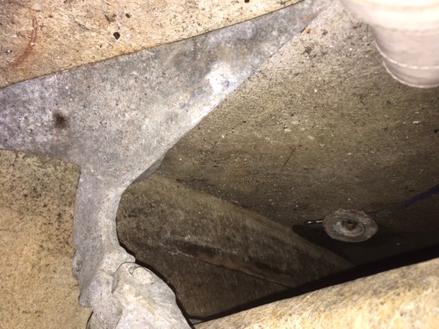

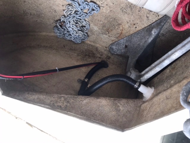

Yes forward lockers were isolated from the cabin bilge but now I have a couple of drain holes from either side into the main cabin bilge, the pump is below the lift up panel in the sole, so any ingress from my through hull will drain down to this point. However, as I said before, water can accumulate in the cockpit bilge as it is separated from the cabin bilge by a bulkhead bonded to the hull. I will try to attach a couple of pictures taken from the starboard cockpit locker that has access to the bilge. You can see the bulkhead. I only get water from the cockpit to the main cabin when the water gets up to the hole for electrics and now my bilge pump pipe. In one photo you can still see a little water against the bulkhead. My mechanical pump scavenge pipe is under the old anode.
I am not sure what year my boat “Rockin” was built, maybe the design was changed at some point, it would certainly stiffen up the structure to have a fully bonded bulkhead there.
