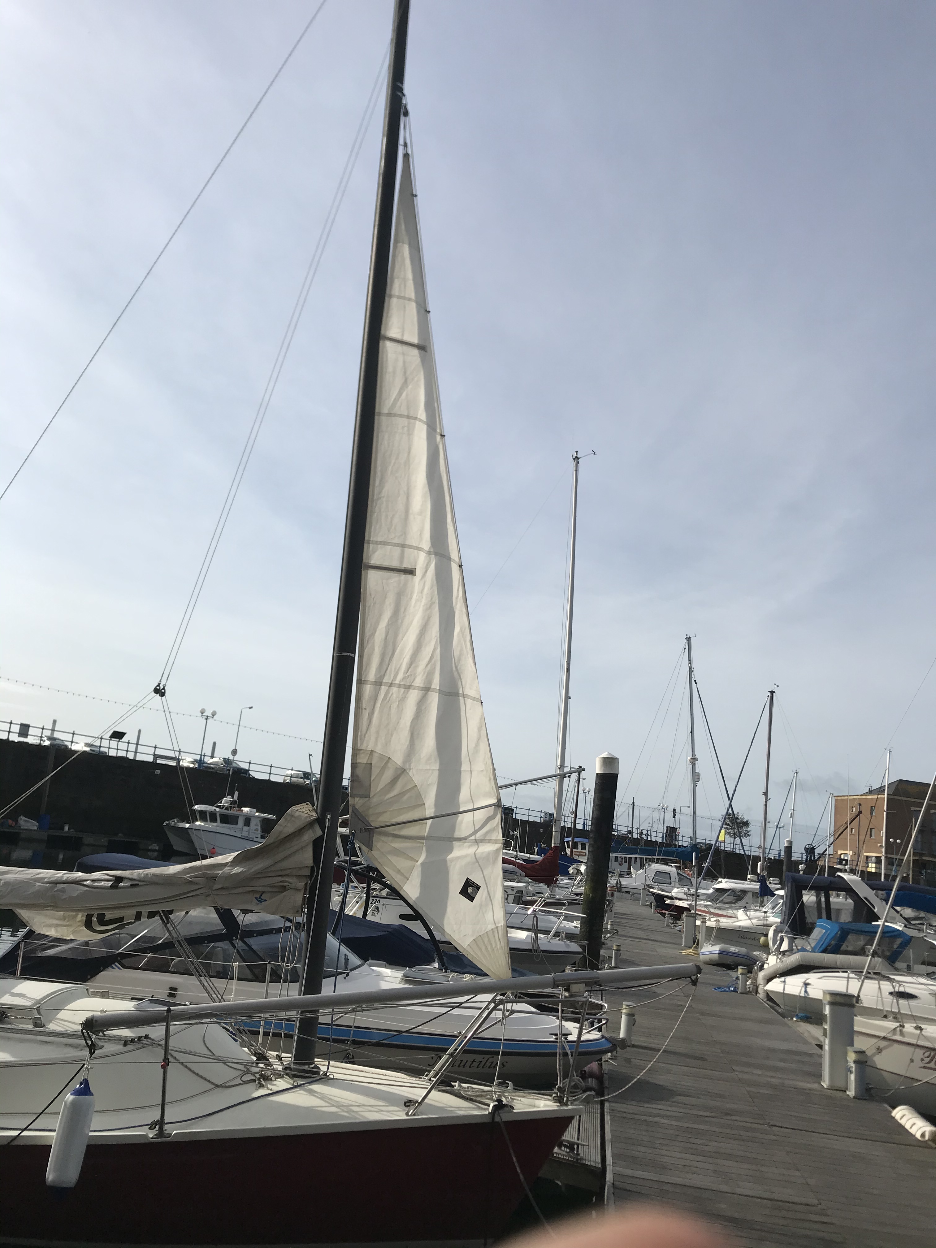

My F21 has two halliards one for spin and one for jib. My jib however does not furl, I hank it onto the downhaul of the halliard. The jib is too small to want to furl anyway.
You don’t say how you hoist the jib now but from your first comment assume you hoist it on the spinnaker halliard… there is no reason not to have a block on your fixed eye on the mast and an additional halliard to hoist the jib and furling arrangement. Then you could leave it up and furled with the spinnaker.
The only issue you have and I have this with my arrangement is halliard stretch but this can be minimised using a good quality dynema line. I use a 5mm braided dynema halliard which works well.
You can see the halliard in this pic, it runs through a block attached to a fixed eye on the mast. You can also see the sail hanked to the downhaul. You presumably would not need to do that.
